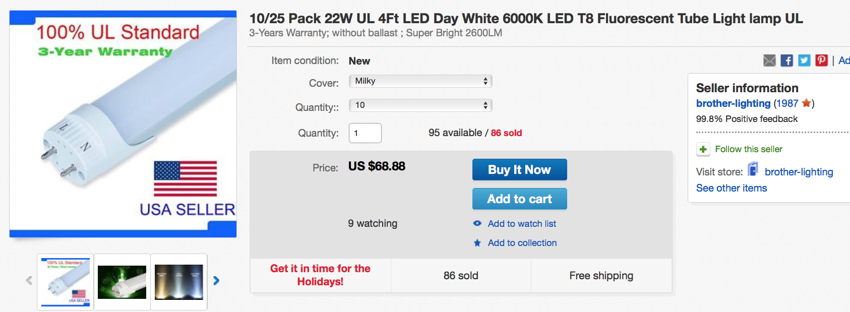

Someone on another forum posted about these 4ft replacement LED "bulbs"
I saved all my old burnt out fluorescent fixtures.
Stripped out the ballasts and rewired them
A hot and ground on one end of the LED bulb
THEY WORK GREAT
Started with a 10 pack and needed to order another 10 pack to finish up.
Did fixtures at my house and my 90 yr old Moms.
Great for sheds and garage in cold temps
I really like the idea using pvc gutters
1/25 Pack 22W UL 4Ft LED Day White 6K LED T8 Fluorescent Tube Light lamp UL | eBay
