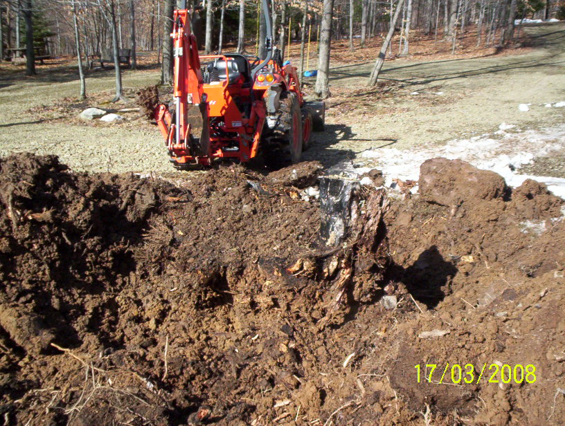

Attached find some pictures of stump removal done Monday and Tuesday March 17 and 18 2008.

Nice looking stump, are there more pictures?

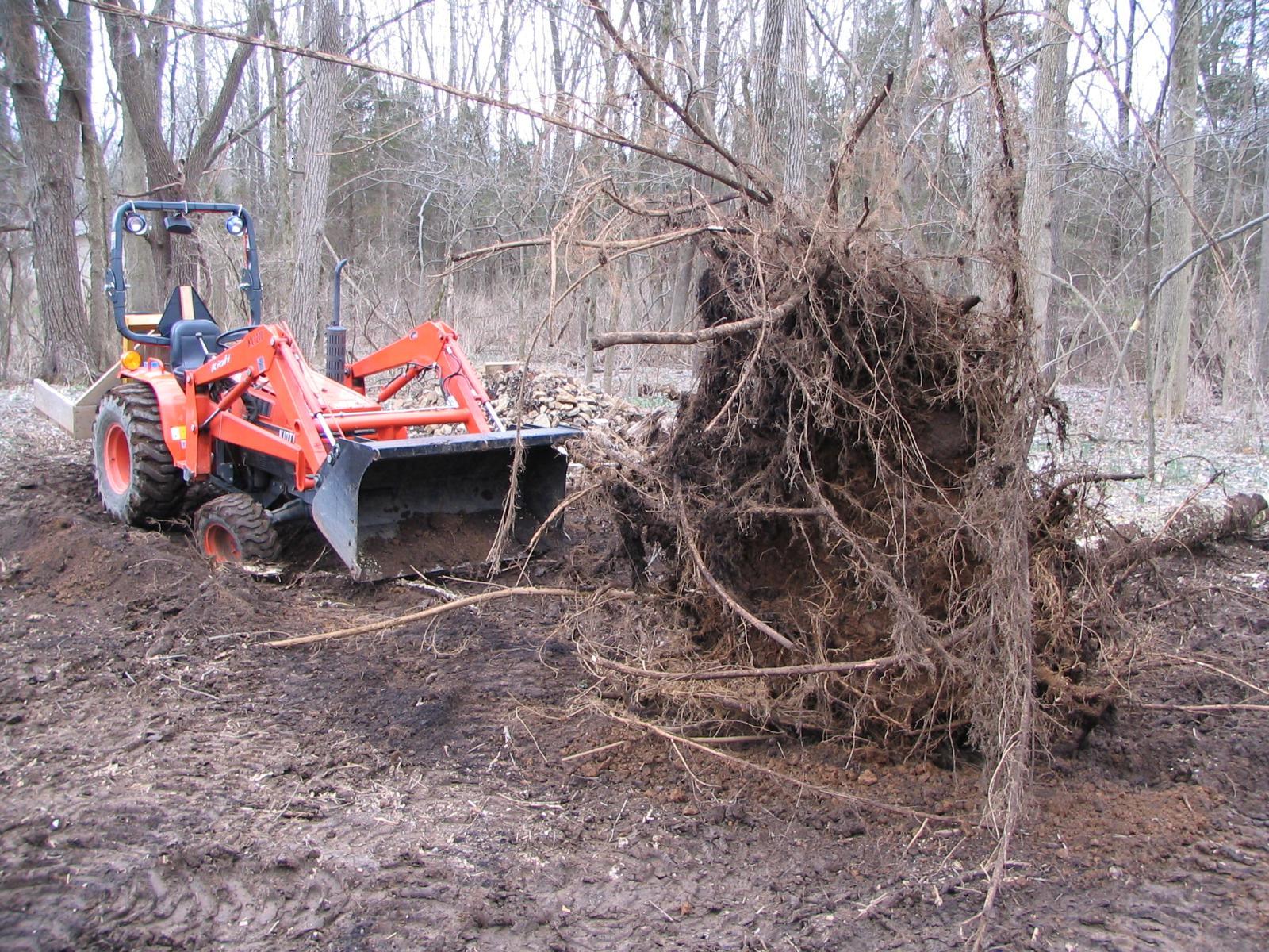

I like to pop those stumps out with the bucket. :D That way I don't have to worry about breaking the tractor in half using a back hoe ;)

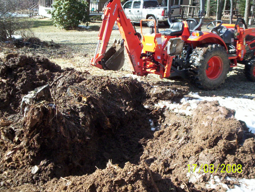

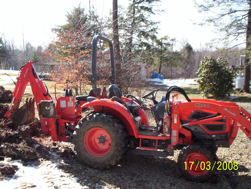

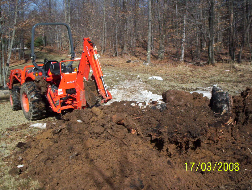

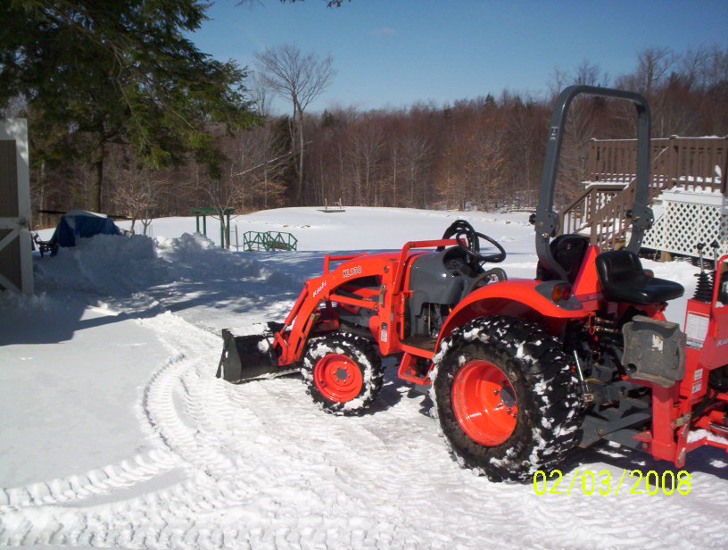

Finally figured out how to do the picture thing.Attached so more pictures of stump removal.

Great picture!!! I fell for your comments and didn't realize you were joking until I saw that picture. The stump is bigger then your tractor!!! LOL

Nice job of taking out those stumps. I have a full sized backhoe and taking out stumps is something I spent allot of time doing when I first bought my land. Now they are all gone and I never want to go through that again!!!
One big mistake that I made was to not fill in the hole right away. After putting it off for awhile on one particular hole, and for no real reason, it rained and filled up with water. After the ground was dry enough to drive on, but there was still water in the hole, I started filling it up. The more dirt that I put in there, the more water that came out, but not enough. I ended up creating quicksand. It was a mess and for months, when I drove over that spot, I sunk into it. OOPS!!!!! Lesson learned. Now I fill in those holes right away and never try to fill one with water in it.
Thanks for posting the pics, it's nice to see some dirt being moved in winter.

I think that Gladehound was serious. The trunk of that tree is still attached and using your bucket to push over the tree with the stump is always preferred but obviously not always possible.

I was serious. It's amazing what a little leverage will do. No, I couldn't push it over with the bucket. I tied a strap 20 feet up and tried to pull it over with the LB1914 but just spun. Then I realized my 70 feet of strap and chain could reach my driveway where my 3/4 ton truck was sitting. Second pull with the truck on the driveway and the tree came down (70 foot hickory, 1ft diameter). I cut the stump 20 feet long, chained it to the tractor bucket and went back and forth in an arc around the base of that tree until all the roots were either broken or pulled out of the ground. Then I simply rolled it out of the hole with the bucket. Tractor couldn't lift it, but it could drag it to the brush pile after I cut the stump low.
I was amazed at how well this method worked. From cutting the stump 20 ft long to rolling it out of hole was not much time at all. I didn't time it but it was proabably about 20 minutes. It also didn't seem stresful on my equipment. Plus I think I got a lot more of the root ball out than I would have with a back hoe because the roots weren't cut. A lot were pulled out of the ground. But I figure if I've got 3000 pounds of pushing force with the the little tractor and a 20 foot lever that gives me 60,000 ft-pounds of torque on that stump. That's hard to resist.
Only thind is with this method you have to make sure that you cut the stump short enought that you can get a good arc before you are running into other trees. At 20 feet, I could twist it about 210 degrees. The apparently was enough.:D
Oh... one more thing. A safety note. When I cut the tree at 20 feet. It stood right up again because most of the roots were not broken. I could have launched something with it. Pulled it back down with the tractor, but just be aware that this can happen.
