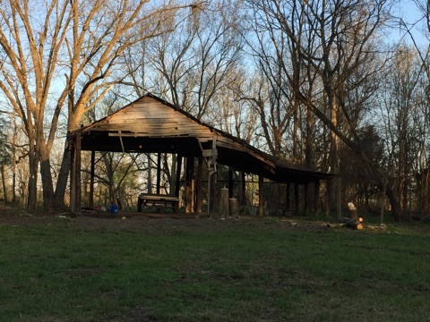

I have a barn that I am redoing that had grown up pretty bad with trees around it.. Just trying to clean up around the barn and make travel around it easier..
Man you have got some bad leaners over the roof of that barn. That is going to be tough to get those out without destroying the barn, but they do need to come out. Might have to get someone to take down the ones hanging over the barn by climbing up and trimming off small pieces and lowering them to the ground by rope. You may get lucky with a long chain attached up high and pulling it with your tractor as it is being cut, but then again you may not be lucky.

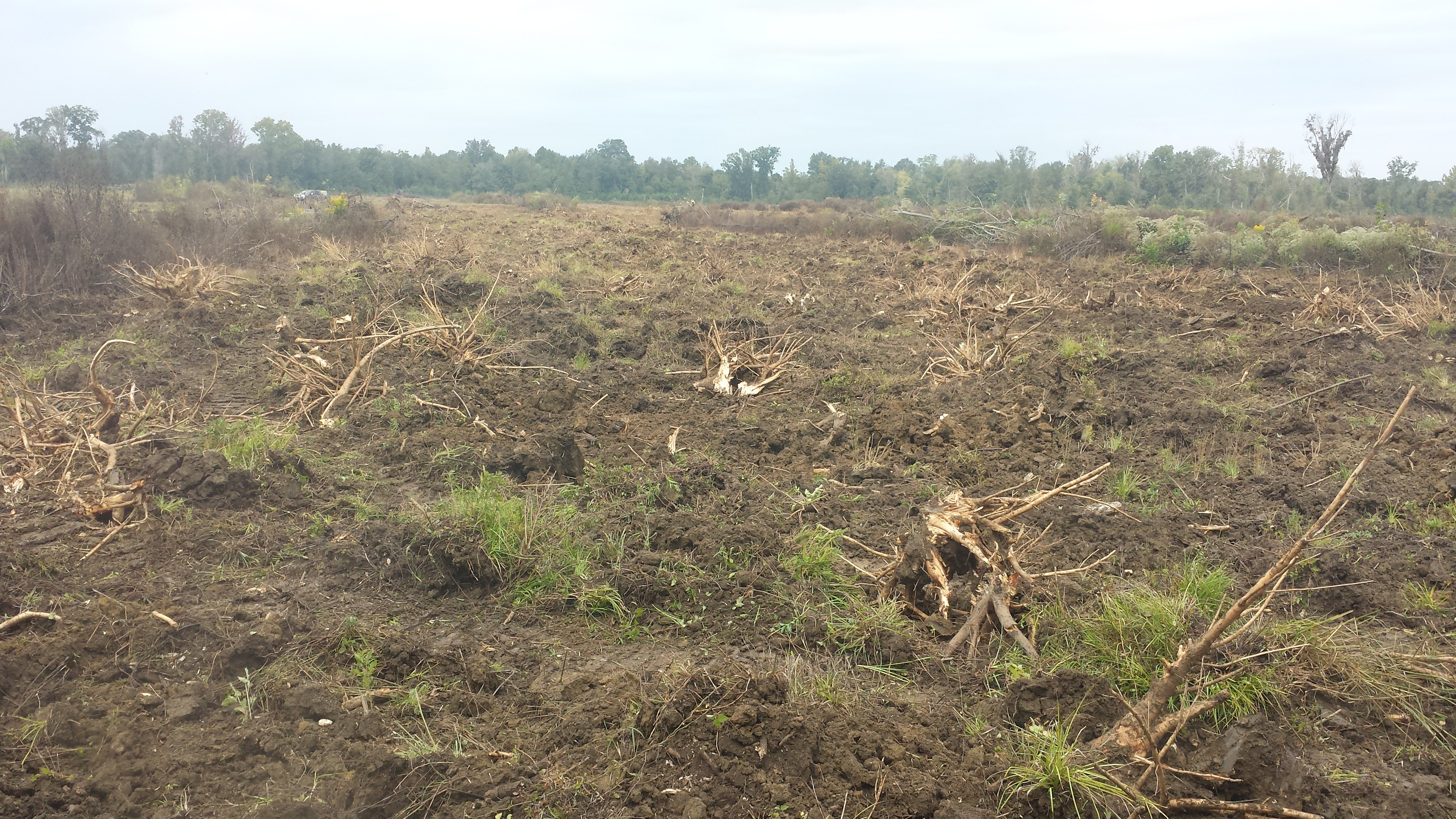

Excavator
