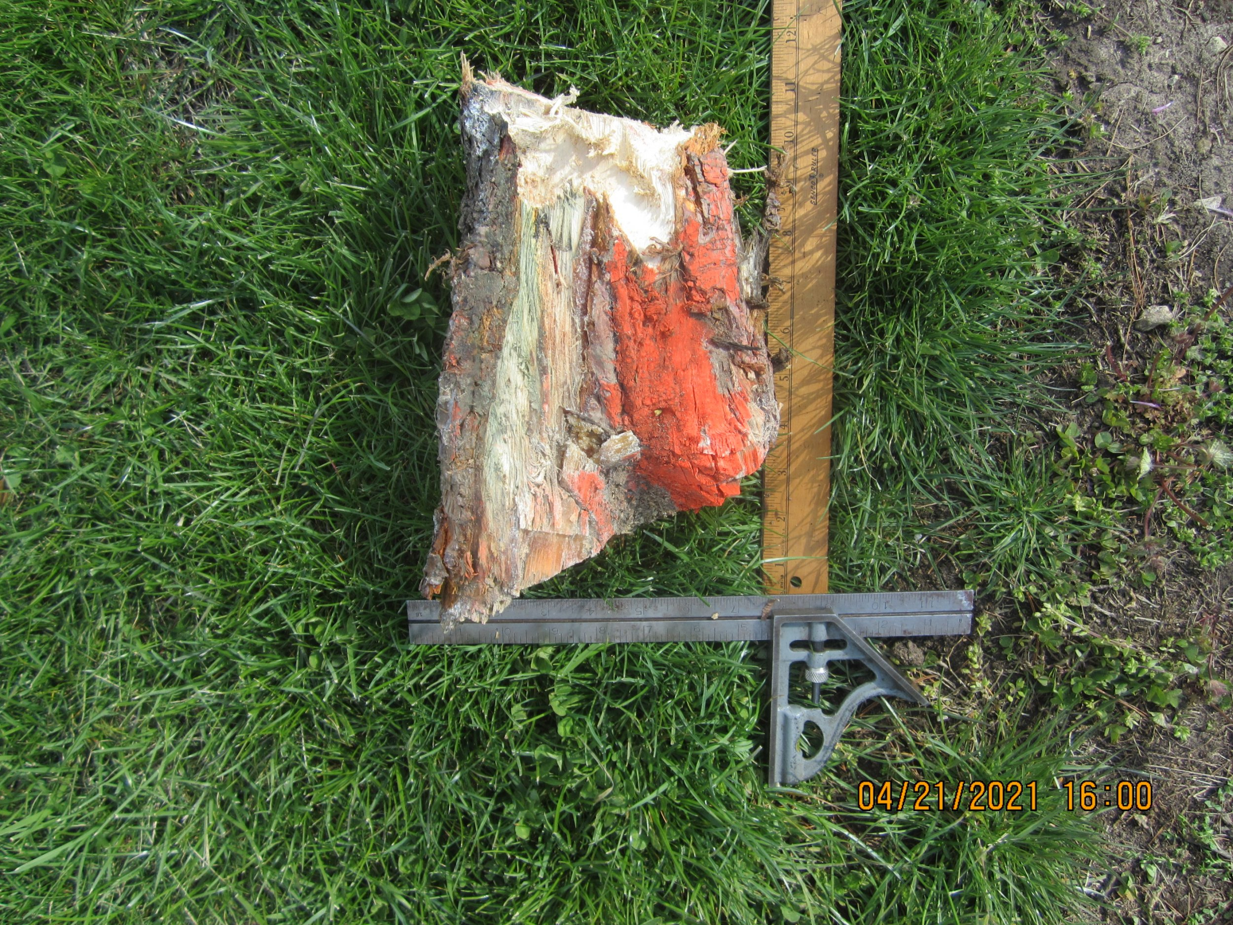

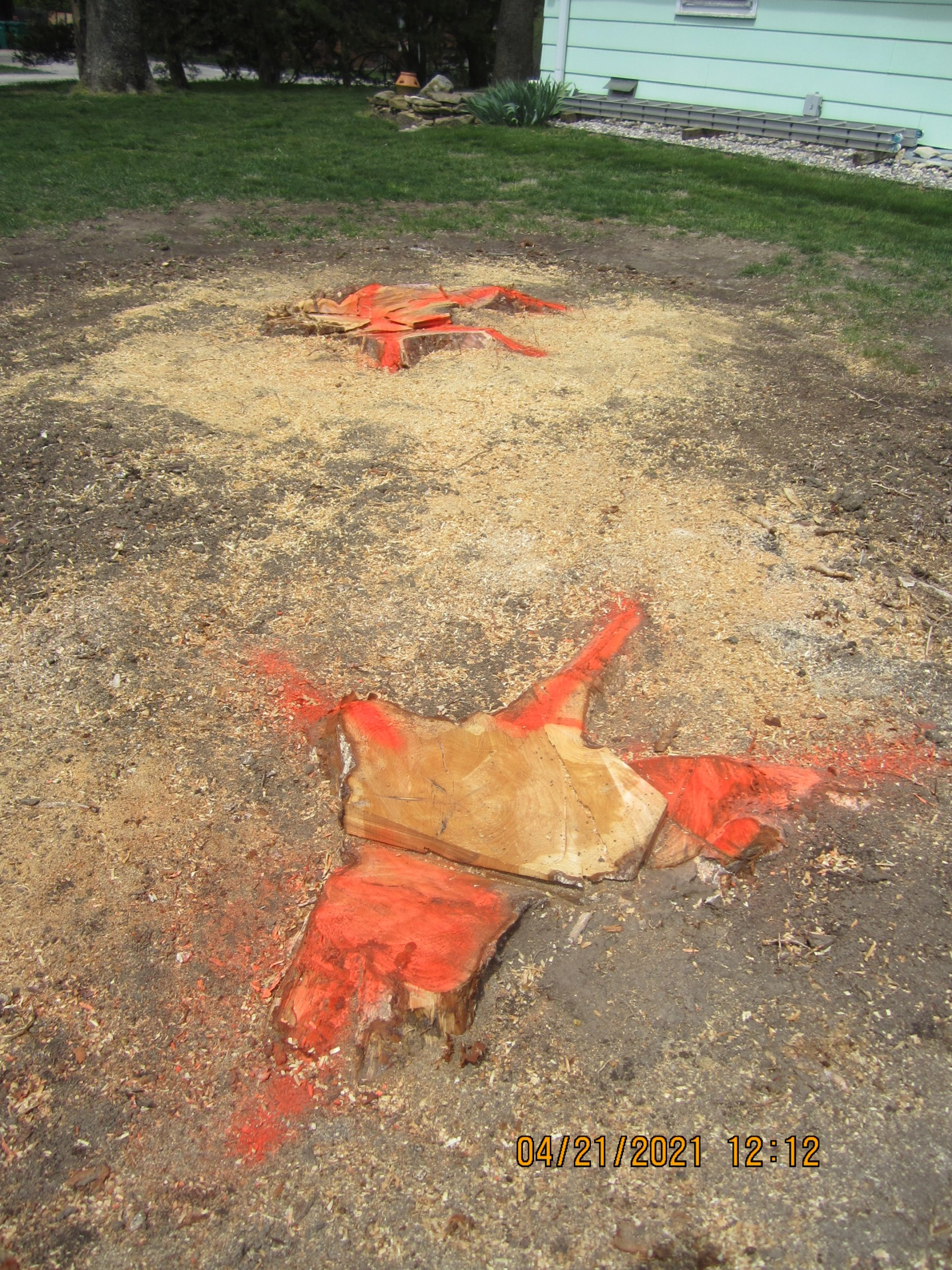

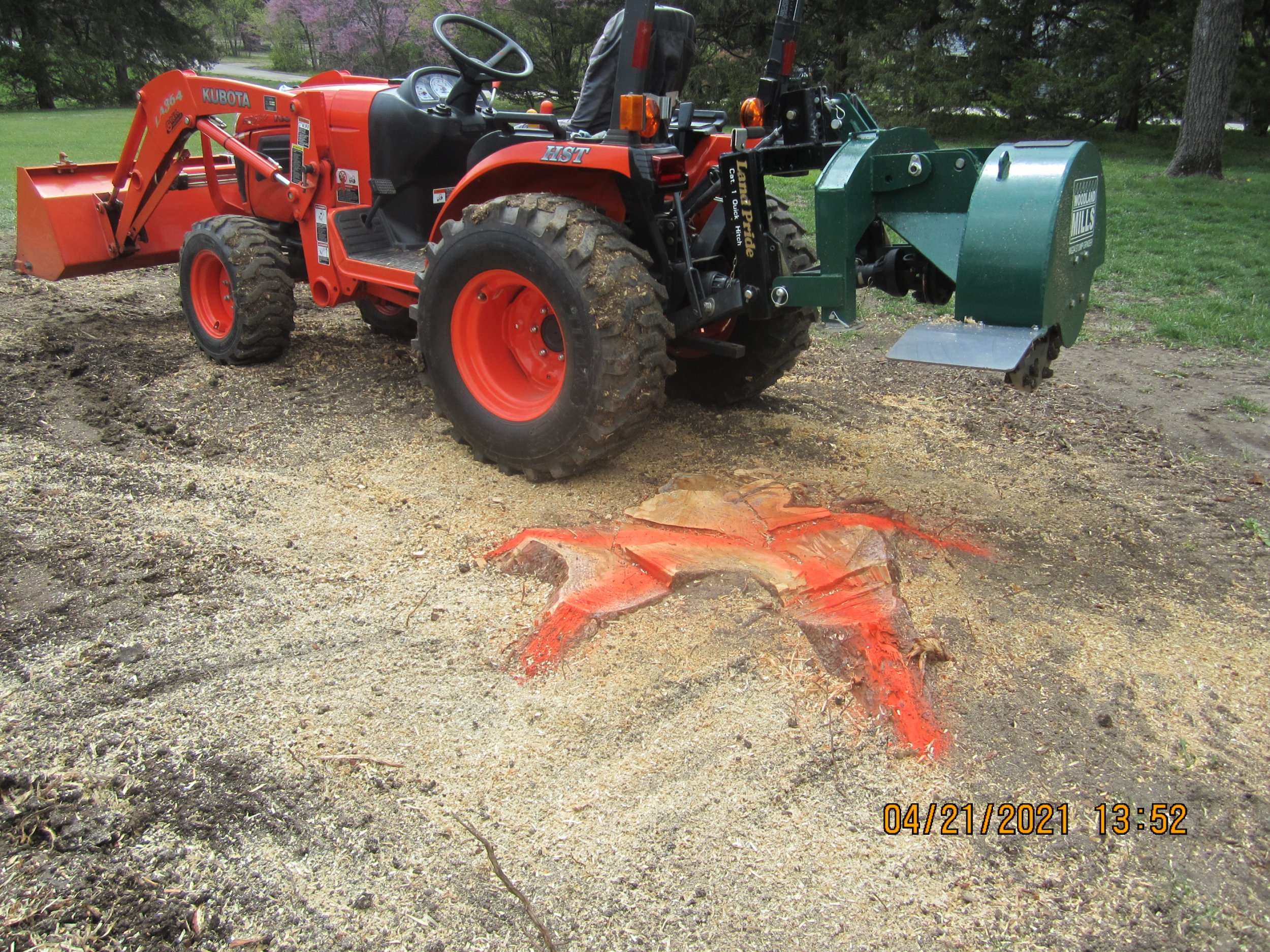

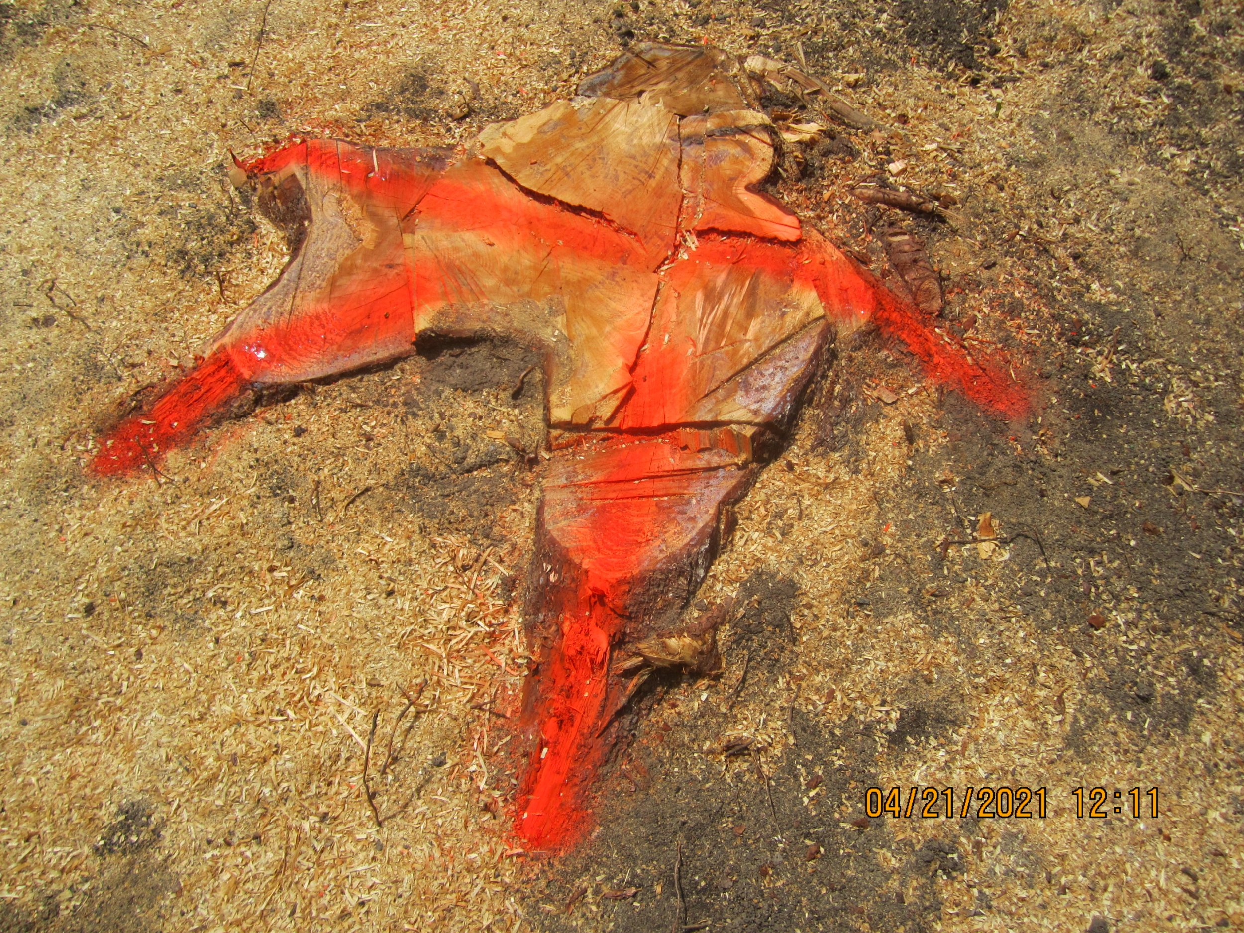

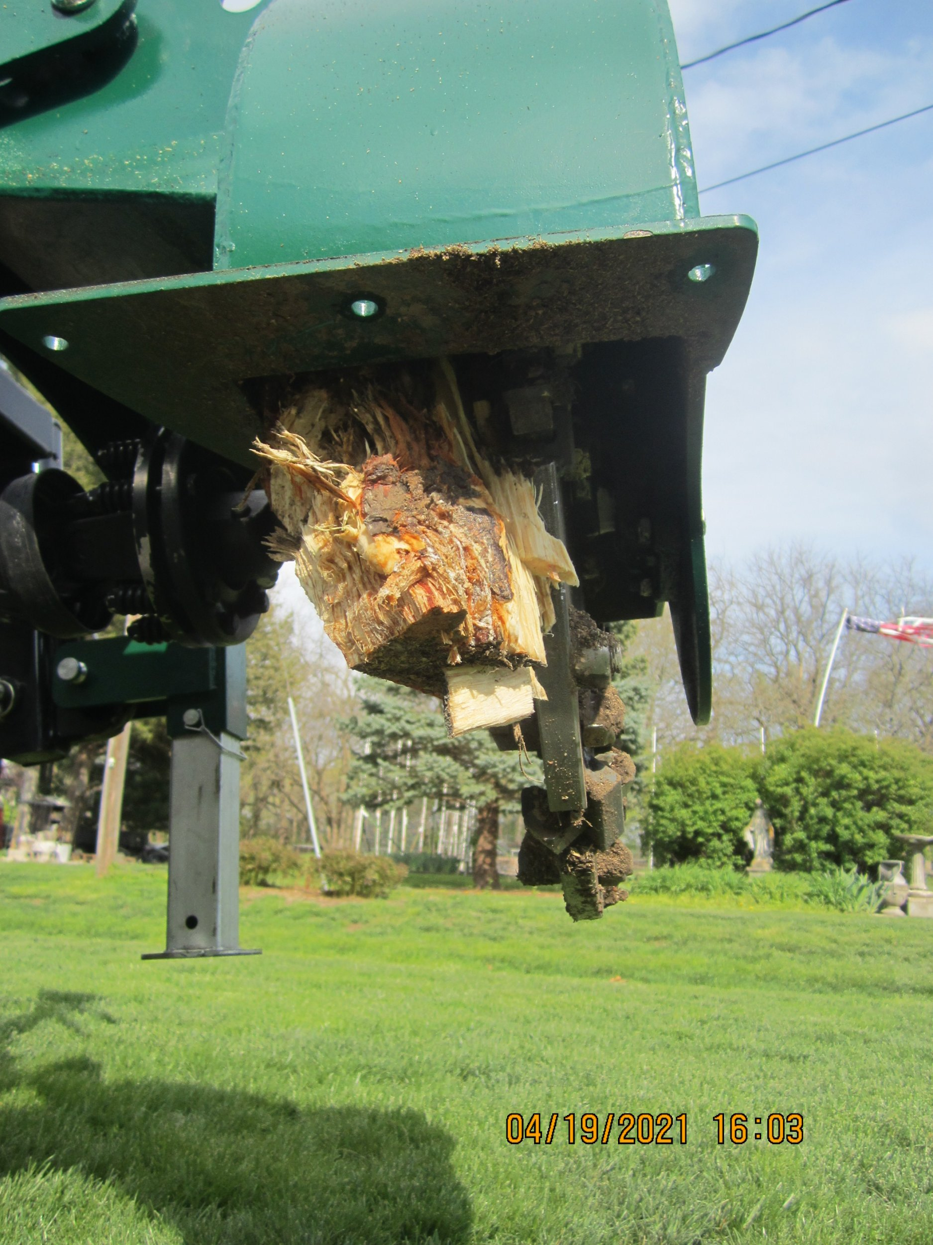

I just finished grinding 5 White Pine stumps. Here's some pic of the last two. Note these observations.....I used red marking paint to help follow the unground stump and lateral roots. Note also that one lateral root jammed the grinder....taking two hours for this old man to cut it out with a Sawsall and 3/4 inch drill bit. Also not seen is the packed moist dirt that......really packed up inside the shroud....It took me over and hour to dig it out...that was a beech of a job too.
I never have had this much trouble grinding stumps......about 40 in all.... But frequent rains have kept the ground pretty wet....just not muddy.

Looks like the Woodland Mills Stump Grinder. Great unit.
Interesting grind pattern as I haven’t seen that before nor have I experienced what you described. Do you think you may have ground it pretty aggressively or did you grind fairly conservatively?

I grind at 540 PTO rpm and have to feather the progress carefully .....somewhat because the B2620 is at the bottom of the recommended PTO HP for the Woodland unit...i.e. 19 PTO HP.
   / Stump Grinding Observations #4
Looks like you bit off more than YOUR tractor can chew!
Smaller tractors = small bites! AND keep the RPM up!
With more HP, you can tighten up the drive line clutch and get away with bigger bites.

My B2620 has chewed up around 40 stumps so far and to my satisfaction....admittedly at the bottom of the HP scale. It was the large root jam and the packed dirt inside the flywheel shroud that was so unusual. ... Just an observation that could happen to any grinder....I suppose.

It seems to me that it was a freak accident that the lateral root was chopped off and sent up thru the shroud to be lodged in the exit. Probably will never happen again. Making passes in the wet heavy dirt, in attempt to grind lateral roots, probably accounts for the dirt pack inside the shroud.......my speculation anyhow.
