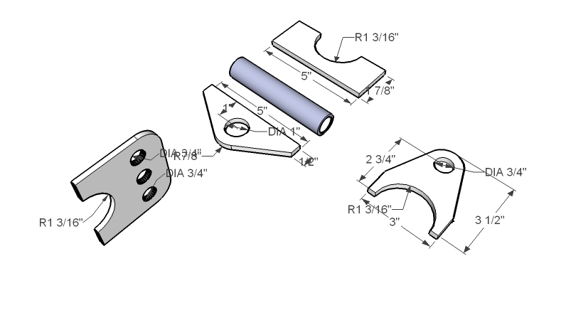

Some plans, and pictures! The Yoke assembly was the most difficult. The scalloped radius will be welded to my 3PH frame assy, which I forgot to Photo. It allows the main beam to raise/lower as it swings the Grinder wheel assy. The parts with the tube laying next to them, will be my mounts for the hydro cyls. I've got to weld the tubes to the plate to make a hinge! As I said, the gearbox is 'beefy'. Last pic is the mounting plates for the toplink connection

Here's the frame, that all the parts/pieces get welded to. It's made of 2" steel gas main, a couple of long-radius 90* elbows, and a 3" channel for a foot. The guys at work were nice enough to 'glue' this together for me, but now I'm on my own! ~Scotty

The input shaft is facing you. It's 1-3/8 6-spline for PTO. The the output shaft is splined w/ a 3" in diameter collar that will be welded inside the wheel. As for the photo set-up, the wife was out, and I figured the range hood light was 'studio-lighting'!
