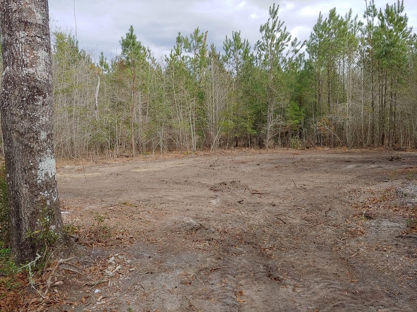

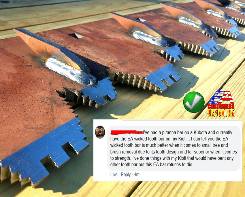

I think you'd be very pleasantly surprised by what a custom Wicked Toothbar(click the link) would do for ya. It will strengthen your bucket and greatly promote ripping/grubbing/digging ability.
I'll post some user feedback.
Travis

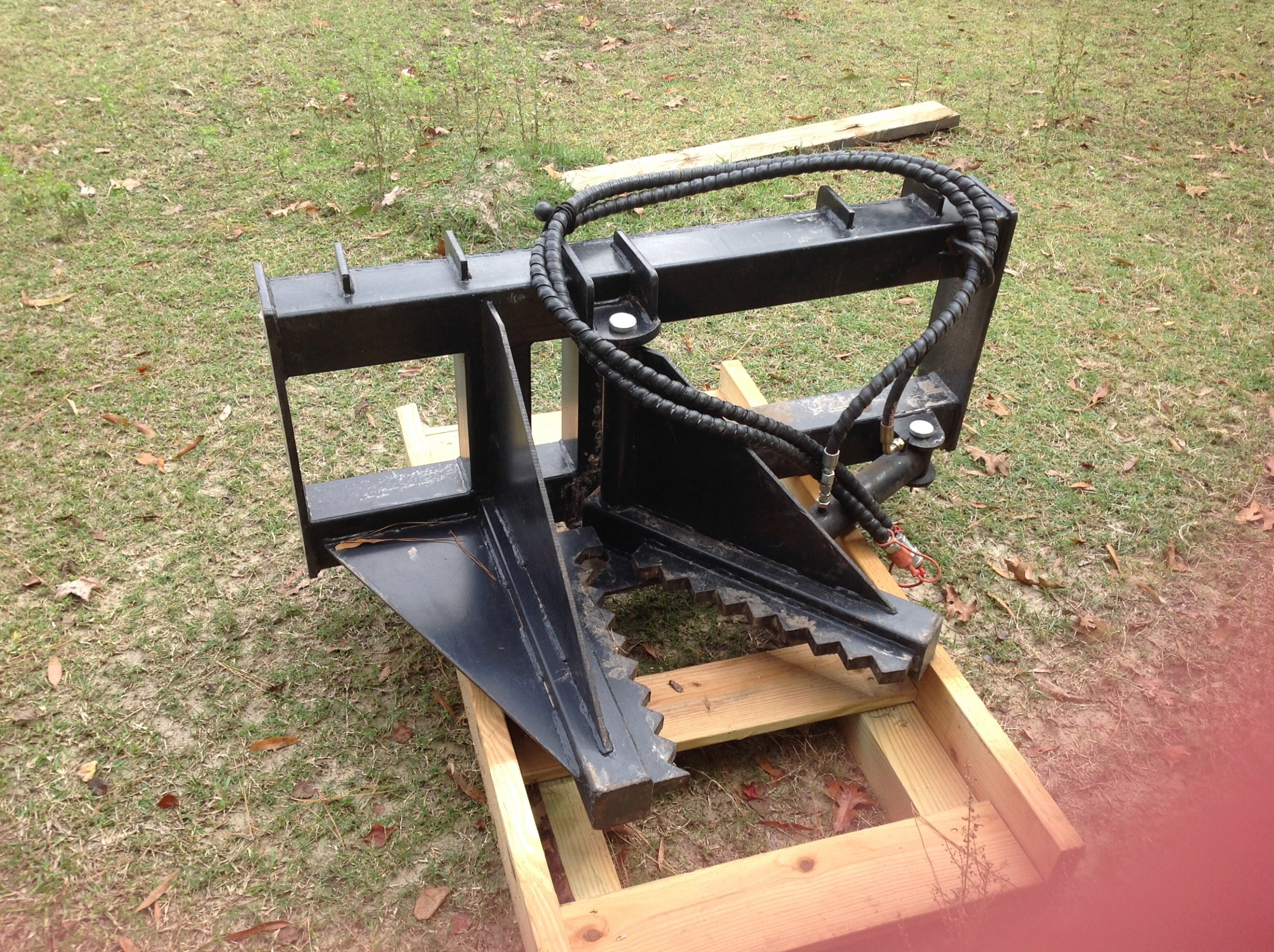

I cleared out a lot of grub brush/smallish trees on the outskirts of a former hay field with a hydraulic post puller mounted on a quick attach adapter on my 3 point. 3 point has lots of lifting power and a tree has much less resistance when pulling straight up. 1538 Mahindra 38hp . It is slow but much safer and less chance of tractor damage.
