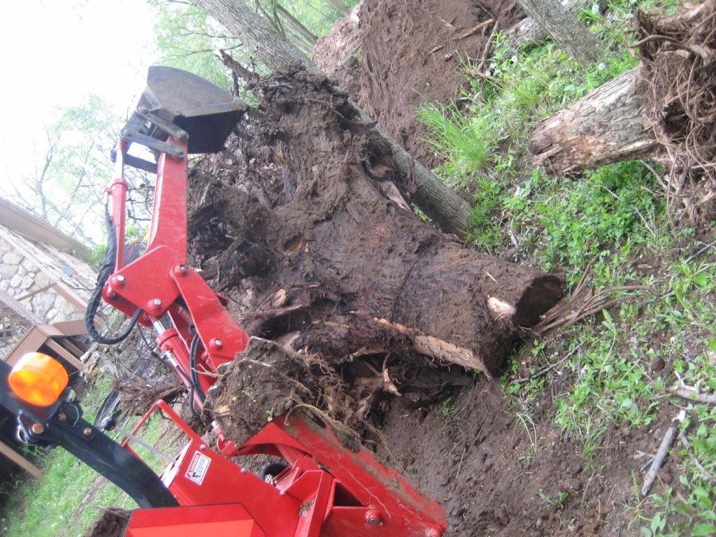

I find it amazing that you were not able to pull this stump. This is one of the more fun activities I like to do with my backhoe. Here is my 3500lb tractor with a 23" wallnut stump I pulled. It was a proud moment when it came loose. This took me two days to remove and it had to come out because it sat were my driveway is now. This is by far the largest I have pulled but I do have a 26" stump on the other side of the house that I maybe pulling next year.

I gotta agree with the "keep digging" group on this one.
Get the bucket as far under the stump as possible in at least two places ...then rock n roll the push-pull will get it free...once it's free get it on it's side and rip as much dirt off the bottom to lighten it...then lift it out.
This one here was too heavy for my L35 to lift out like that.....well, too heavy until I cut the stump down to the root. I was able to roll it out with the back hoe once I removed those few hundred pounds.

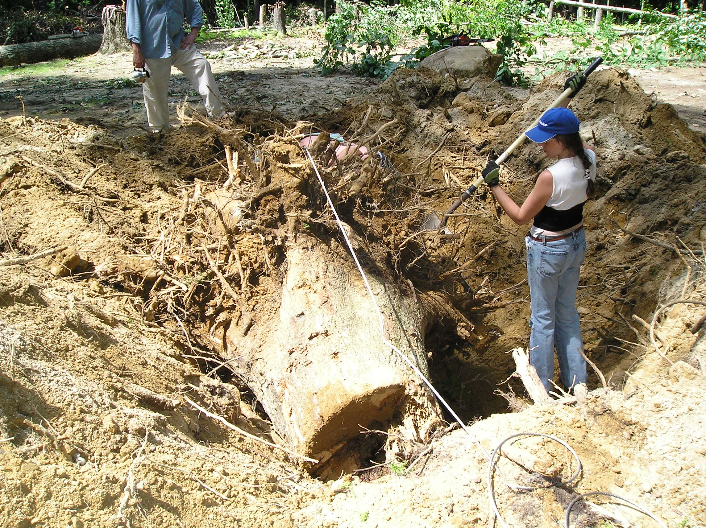

Last year I had a microburst take down about seventy oaks on my property. The commercial tree guys left about three feet of the above ground stump on them. When I asked why they said so that a machine with a grapel has something to grab.
Pressure washing the stump (zero degree nozzle) will remove over 50% of the weight. After you get it out another washing will remove another 20% of the mud and make it much easier to burn. But due to back splash, this is the dirtiest job that I know. I would wait for warm weather to do this.
If necessary, dig a ramp to help drag the stump out of the hole.

You (nor I) obviously do not organize as well as Tim. See his photo. That must be him with the coffee cup supervising his wife who is cleaning off the stump. She would be the one with the pressure washer.
