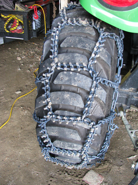

When I replaced my JD 850 with a 3320 four years ago I did stud my tires due to the fact that chains would cause clearance problems http://www.maxigripstore.com/....did help on ice but obviously not at all on snow...ended up installing extenders and getting the old reliable chains Canadian Chains [Home]3320 chain rear.jpg P.S. You can also see the studs in this photo

Thanks for the replies. I have a set of too big chains that I bought for $40. They need to be cut down some but I think they will work. I never thought about extending the fenders for extra clearance. Thanks for the heads up.
