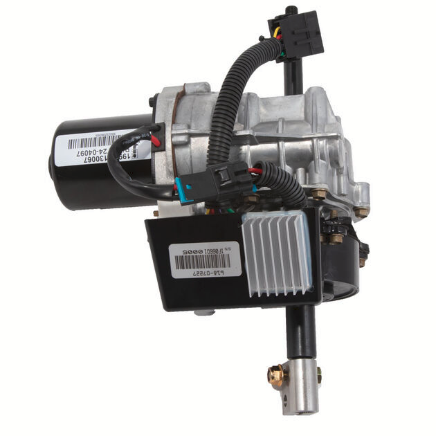

Would the existing steering be robust enough to add an electric power steering from a newer car? From some of the YouTubes I've watched it's quite easy to add.
   / Stuck yanmar 165D #193
Or you can just get an MTD Cub Cadet eSteer assist unit. They are called EPS units. Some are universal enough as kits to add on now.
EPS Replacement Service Kit
Item: 759-05105
* This part replaces: 618-05084, 618-05084A, 918-05084, 918-05084A
