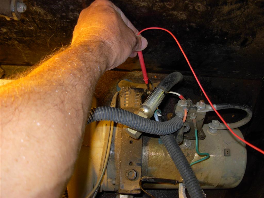

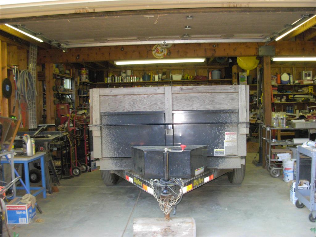

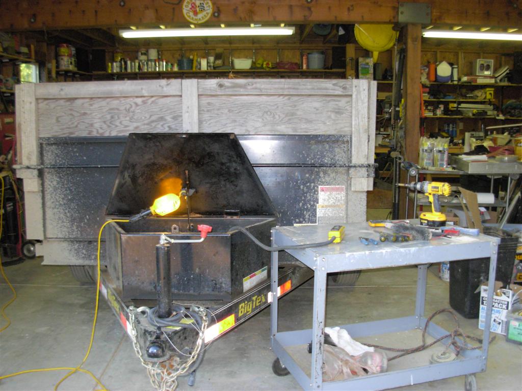

Today I called the trailer dealer and explained what happened and the guy said “probably the first thing you might want to take a look at is the switch”. That made me a little suspicious that maybe this is a common problem, so I asked him “have you had problems with that switch before?” He says “oh no we haven’t had problems with it, but we have seen it happen.” Then he proceeded to tell me how to take the switch apart. Gee he sure is familiar with that switch.

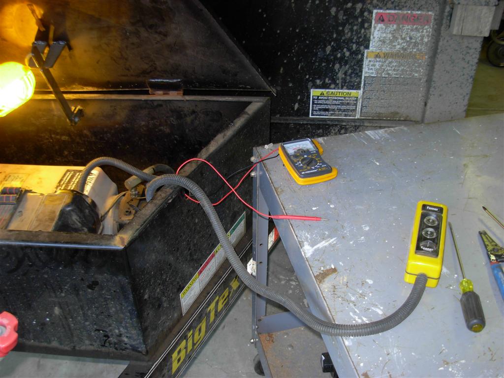

I put my trailer in the garage to work on it and the first thing I do is raise and lower the bed a number times and several times it failed to lower. Raising the bed was never a problem, lowering it was hit and miss. I was glad to see that happen because now I can track it down.
Then I put a meter on the wire to the return solenoid and every time I pushed the down button and the bed dropped properly I was seeing 12V on the wire and every time I pushed the button and the bed failed to drop I was seeing 0v. Clearly it’s a bad switch and not the solenoid. Also one of the times I pushed the down button and it failed to work, I took a screwdriver and shorted from the 12v terminal to the solenoid and it worked properly.

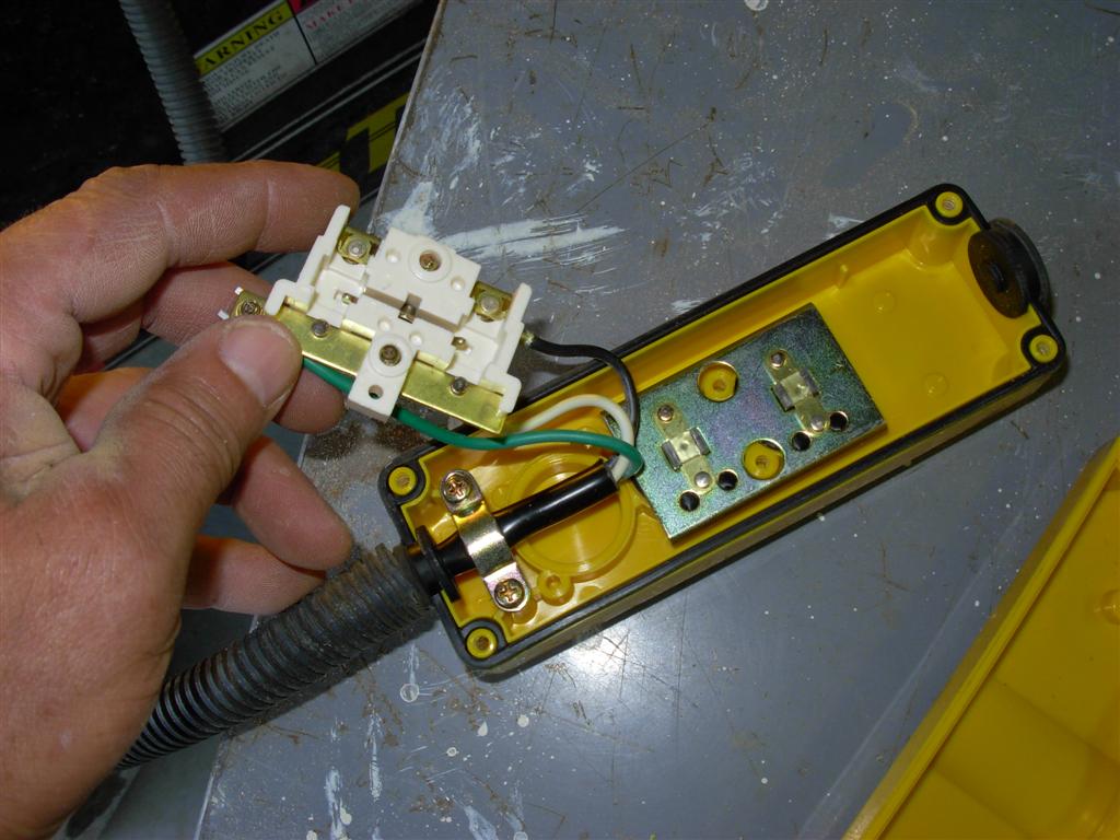

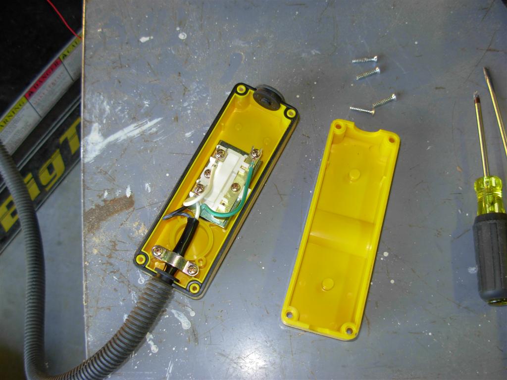

Took the switch apart and cleaned the contacts and than put it back together, but it still isn’t working right yet. I’ll deal with it tomorrow.

I do not think you got all the contacts in the hand switch. I believe the button pads in the front of the switch may be your problem. Dirt and crud enters as the thumb button is pushed down and works its way underneith. Same thing happens on TV remotes, etc. Take the front casing off and the buttons out... use alcohol to clean the contacts. I have one of those remotes on my dump trailer, too.
Good post about what to do in a bed up position. I have wondered about it, also.
