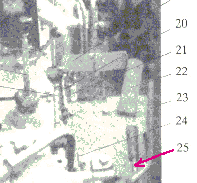

</font><font color="blue" class="small">( I don't think I have a diff lock. )</font>
I'd be surprised if you don't. It's item 25 in this view. Another trick is skid steering, but you should be in 2wd and without diff lock to get the most control out of that technique.
//greg//
   / Stuck on a hill
No diff lock. I looked at diagram and I have nothing similar on my tractor, on the right side I only have 3 levers, one for 3pt up down, one for engage PTO and one for [I think] future use like BH.
Anyway I called a local tow company and they winched me out, I would not have gotten out using my truck or come along. I was too far down for those to be much good. nothing hurt except my wallet $100 less. I learned a lesson never about getting too close to an edge.
