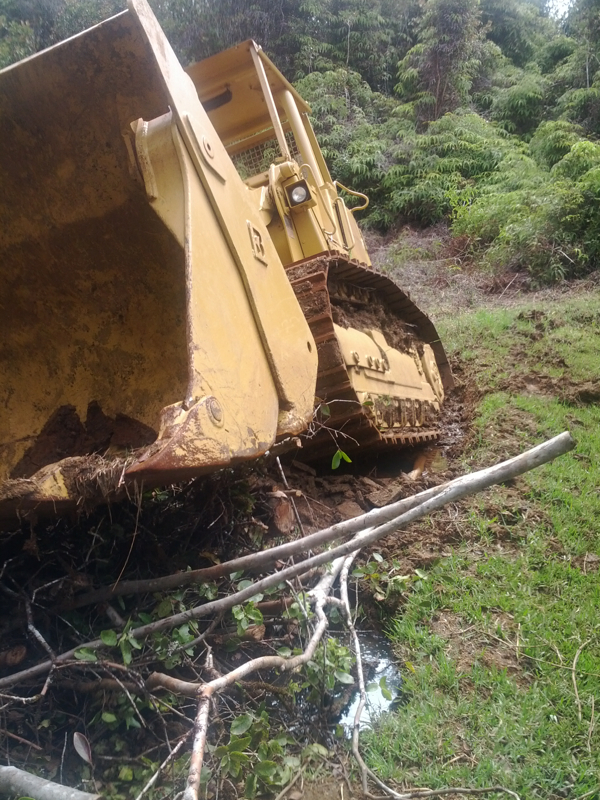

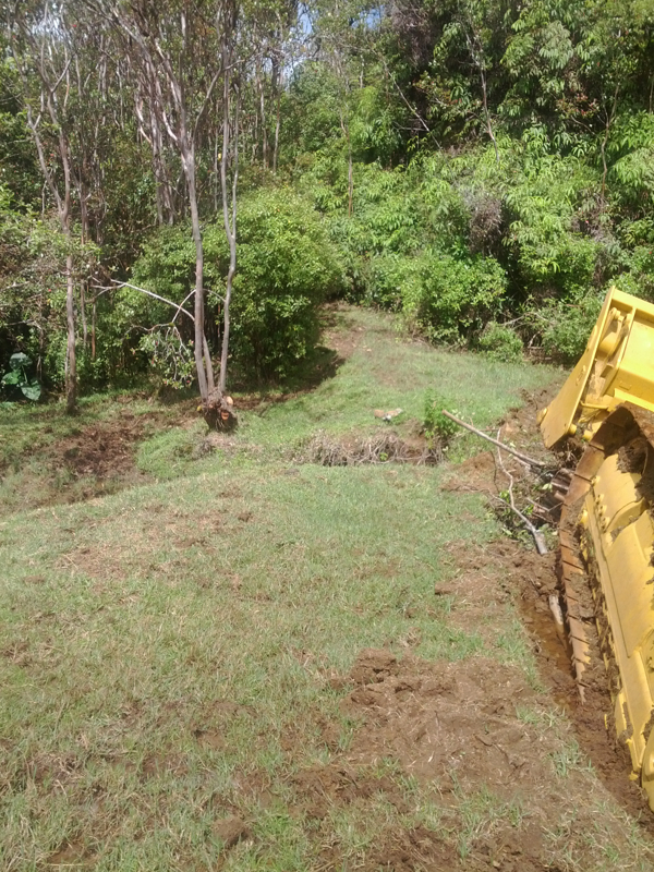

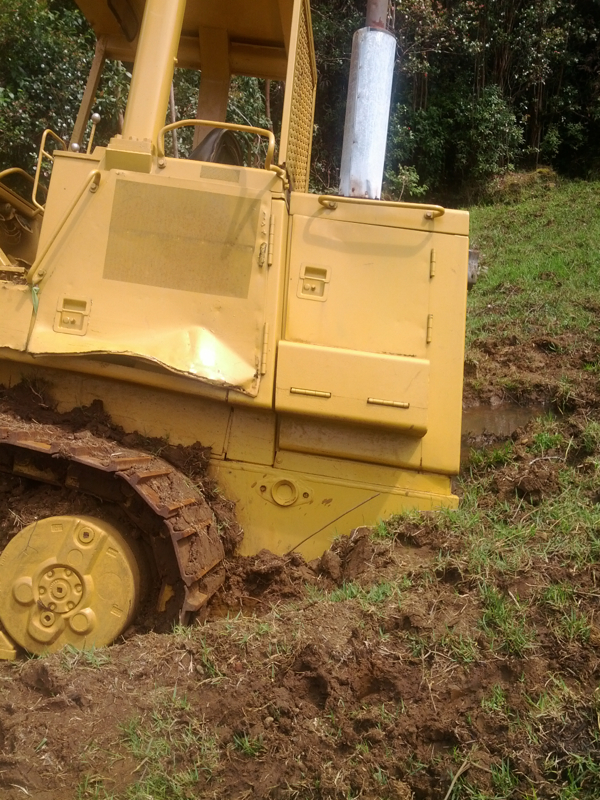

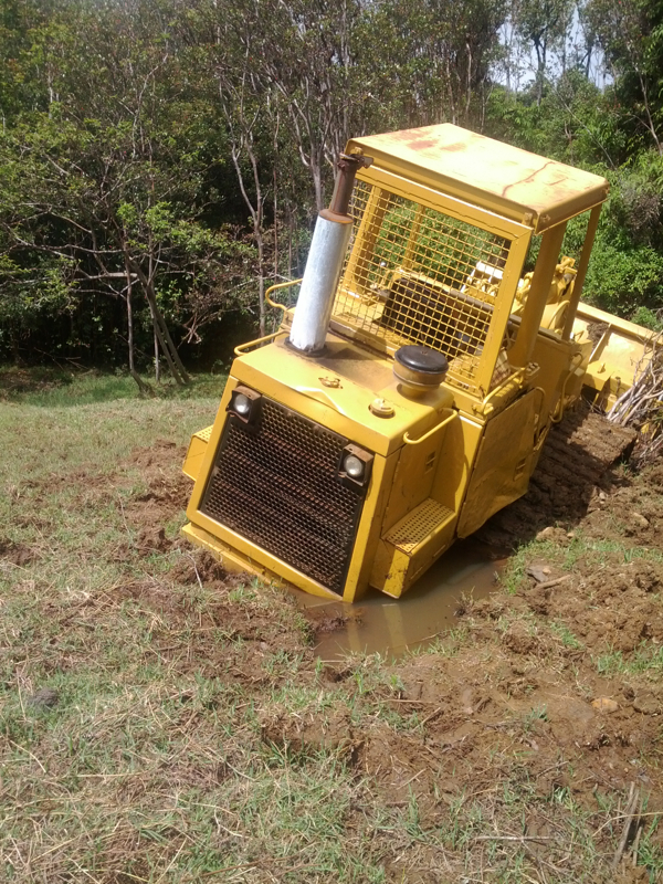

I have a neighbor that bought a used dozer a couple months ago. It is a Cat, but built for the navy, single ram 4 way on front. Forget the number, but neighbor says it is about size of a D7. It is tall! He hired a couple of experienced guys to do some clearing with it while he was on the mainland for business. For reasons unknown these guys take the dozer toward one of the streams on the property. Oh, Btw, this is still rainy season. So these guys get the dozer stuck and have to abandon it about 2 weeks ago. This past weekend my neighbor invited a few of us over for a look-see, hoping we might come up with a plan. This dozer is sitting at the bottom of a fairly steep, muddy hill. Dozer sits at an angle with the right rear track submerged in muck upto to bottom of the engine compartment. Did I mention there standing water in the muddy footsteps? The largest tree within sight might be 3 inches. The hill across the stream to front of dozer is even steeper. To be honest, I refused to take my Ck30 with backhoe down to help dig him out because I KNOW Id get it stuck. As I type this, there is no solution in place, it has rained an inch since midnight.
UPDATE: got neighbors wife to send me her pics. Any thoughts? She took these on a dry day. BTW, this dozer weighs 47000 lbs.
Current thoughts:
Try to dig and drain the water
Dig a ramp to rear.
Have a call in to another neighbor with another dozer

It looks like there is a clamshell bucket on the front. I wonder if you could open it all the way and attach a chain to a post set in the ground and then to the open clamshell. Then close the clamshell while inching forward with the dozer.

WOW sure appreciate all the quick suggestions.
I guess this is really a track loader, not a bulldozer, but that doesn't get it unstuck.
Let me provide a bit more background, some just thoughts, some we processed on site:
These pics were on a dryer day than when I was there Sunday. They make the whole area look much more hospitable than reality.
There really are no substantial trees in immediate area, maybe 1 or 2 three inch or less Ohia, and those not close. Rest is strawberry guava bushes.
The owner considered building a deadman anchor and chain to track, but the only place where it might be effective is uphill, rear and right in pics 2/3. There would be concern of throwing the track making things worse. I and others seriously doubt he can build one that would hold, not unless completely dried out. Given his elevation, not sure it does dry out. We've already had 65 inches rain this year and he is higher elevation.
The area in front is a small stream, bank about 3 feet and less than length of the machine. Looks like the operator made it over the stream, changed his mind and got struck backing up.
I like the idea of trying to stabilize with the blade and feeding logs ( I suggested fence posts) under the tracks. I think some drying out would help. Owner has some fencing in his future so could reuse. Like the rock idea, but that could be a major just getting enough rock there to be effective.
Owner wants to dig out around buried track and drain the water away from machine. This would likely mean digging trench to the far side due to slope. I think that a pump would also be needed..
Once dry, perhaps digging a ramp to the rear. Space is limited. Ramp would have to dry to be more effective.
Just a note, this soil is like grease when wet. Another neighbor that took a master gardener course once said something about it's capable of holding 125% water.
If it could be dried out under, might a mat jack be effective to lift and get something under that low track?
Location is a major problem. Access from main road would only be given to a very small number of people. Direct access is not great in that the operator chewed up the area leading to the stream, I doubt the side of the hill approaching has any traction.
Owner has a call in to another neighbor. Between him and his brother have a number of dozers and other equipment, but even better, being local "older" guys have probably experienced this.
Please keep your thoughts coming as well as any comments on above. I'll pass them all on to owner. Heck, maybe he'll even join TBN :)

That isn't stuck all that bad, excavator would be the best bet. If you don't have one, then use the front loader, raise up as far as possible and place logs under tracks, then walk out. I'd be leary about bringing another dozer into that area you may end up with a real nice mess.

I see a stuck 943 track loader. Where's the dozer

I have to agree with this. I've seen a lot of equipment get stuck over the years, and this will probably get it out. People tend to over estimate the size of equipment also. This is not anywhere near D7 in size. More like D5. It also has fairly narrow tracks, make sure what ever you bring in has wide tracks. My guess is that a large excavator will yank it right out, plus it could help dig if needed. It would help if you had a few dry days also.
Thank you!!! That is what I see as well. For all of those who don't know, Dozers have blades and loaders have buckets.
It also weighs no where near 47k. More like 30k. Big Difference.
