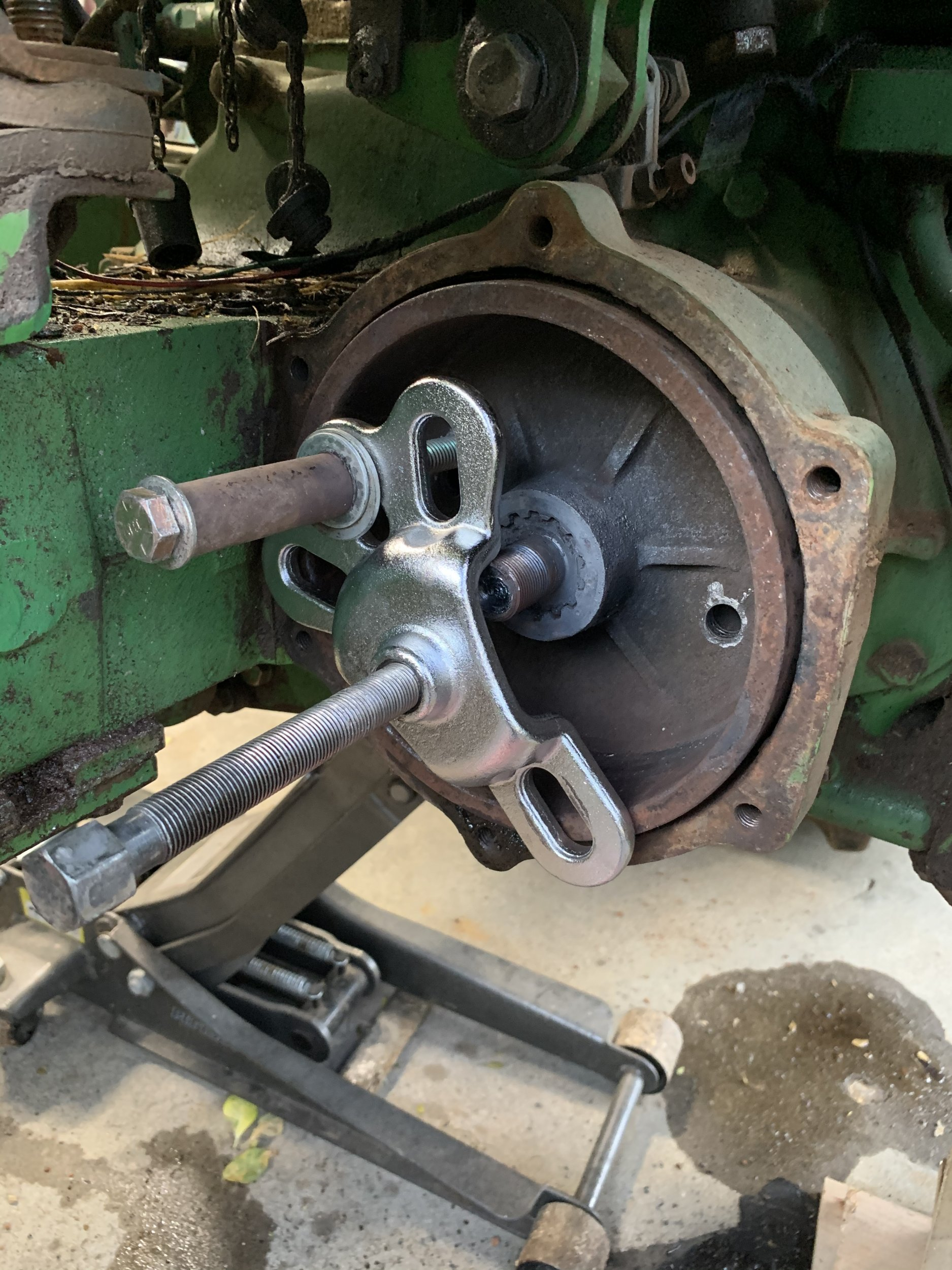

After heating and using a puller it won’t budge . What’s the answer. Thanks in advance

A few vids on YT for your Yanmar (JD) machine. I think Hoye Tractor has one just for this too.

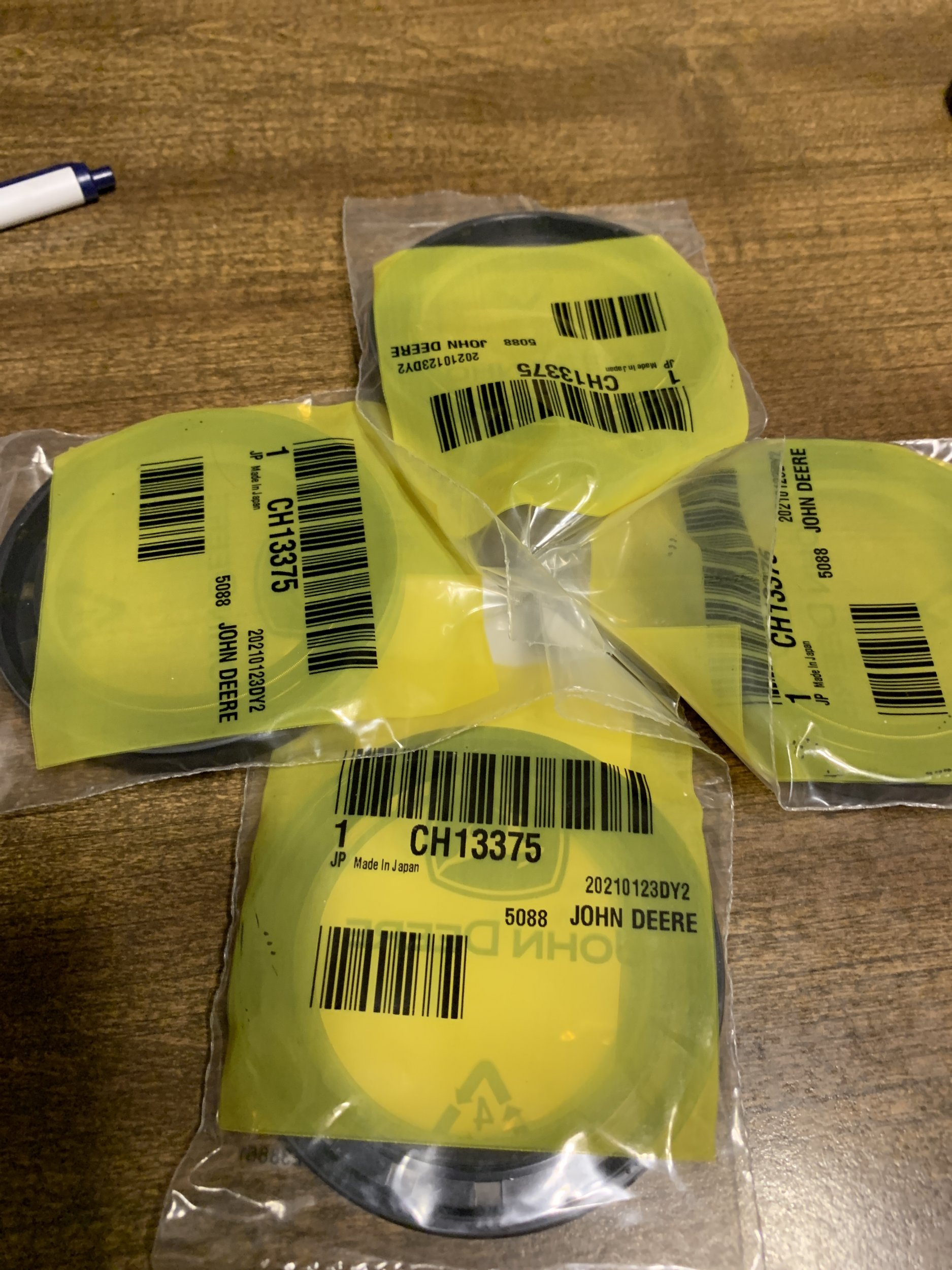

I found them a the local John Deere dealer . The 4 seals all the same , 2 to the side turned back to back at least that’s what I’ve read they really look large , but they went by the serial number. All 4 was about 24$
Did your drums come off easy? I’m still soaking the splines with P B Blaster , nothing’s budged yet .I found an after market brake kit with the 4 shoes and springs for almost 200.$

I tried something tonight .I took a bicycle inertube cut it stretched it over the hub of the brake drum put a hose clamp over that , poured P B Blaster Down the tube crimped the end and put some air pressure on top of the liquid hopefully forcing it in the splines better it ran out the Backside of the drum maybe it will finally give up.?????????????
