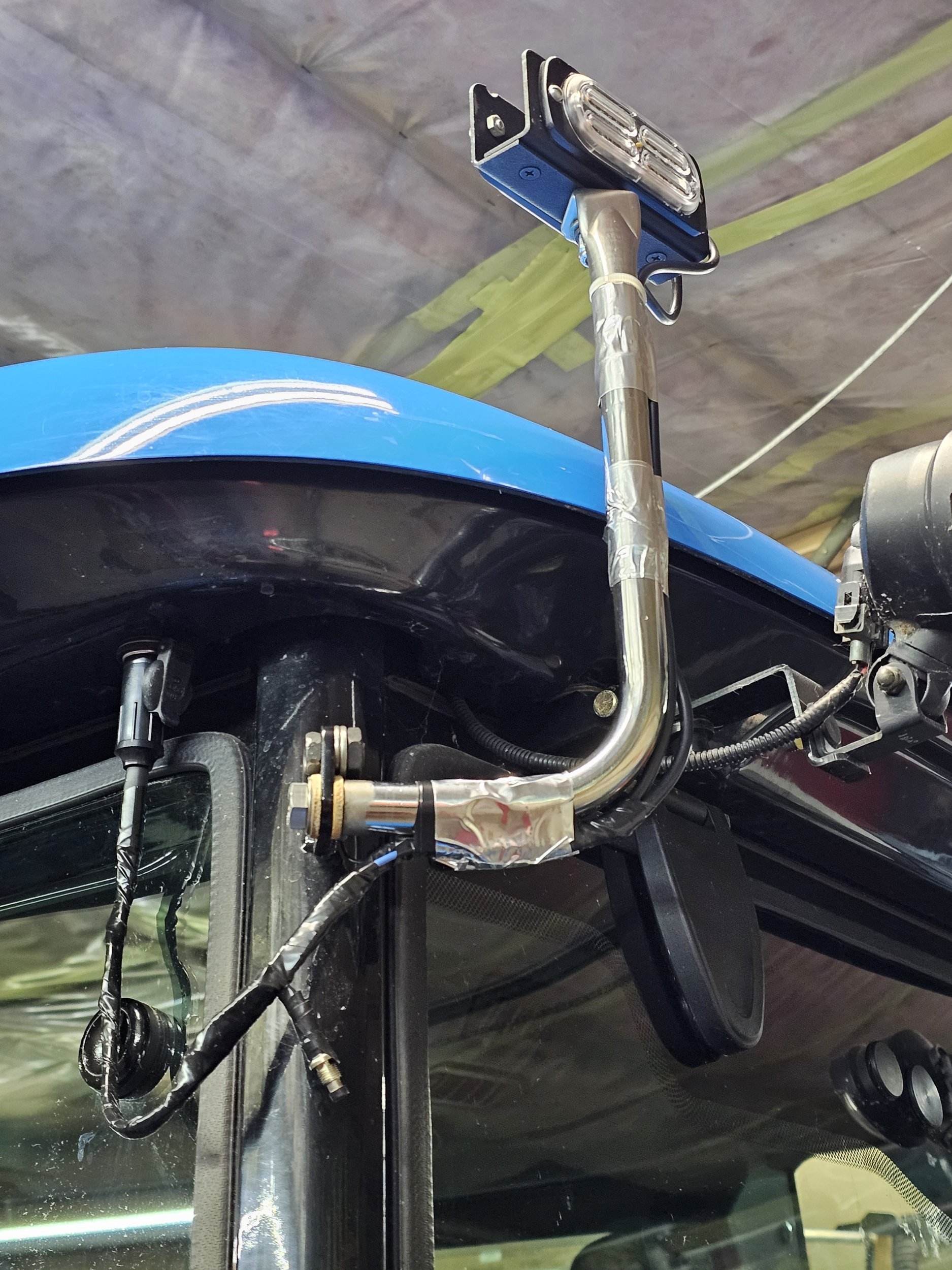

   / Strobe light bar #6
Fabbed up this mount from old mirror brackets. I already had these inexpensive strobes and the little momentary switch that changes the 32 strobe patterns. All I had to buy was the Hella Plug mentioned earlier.

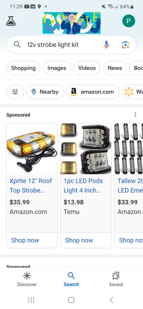

Something else to think about...I see that Amazon has led strobing tail light bulbs. Might save someone the hassle of fabbing something up.
   / Strobe light bar #10
$35.99 on Amazon, should be magnetic base, plugs into 12v oitlet, and not sure about this specific model, but has a rocker switch to turn it one, common on construction vehicles, mail cars, ect. I believe yellow/amber is 50 state legal; I think white is not allowed in Texas; I'm pretty sure green/white is allowed some states, but not all.
