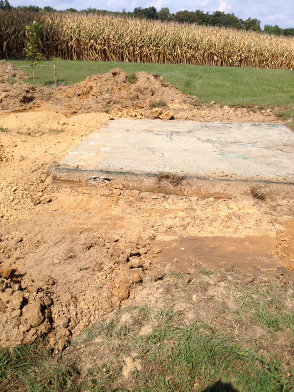

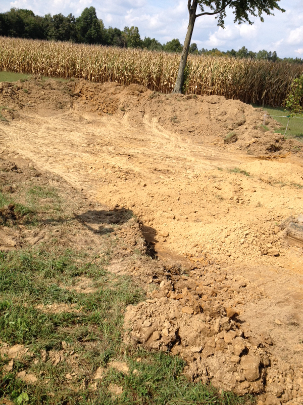

We are adding a storage building this year it started off small 12x16 and has grown to 16x24 two story with a 12x16 front porch (scratch head). Wife wants shady spot to sit and told me to make it where it was workable inside as my current shop has only 7 foot ceilings.
Dirt work has started.

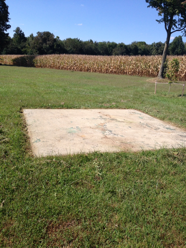

As you can see there is already a 12x12 pad in place. It's not the best of shape so it will get a new pad over the top.
Have already moved most of my fill back in but don't have photos.
The structure will be a pole barn style. With cedar post and most lumber will be yellow popular. Cut from my place. With 4inch floor and six inch walls. Fully insulated and a gambrel roof. Found a web site that you can print the plans for the gambrel truss from. I am in an area that other than new service for power company or septic doesn't require an inspection. But it will be built right.

Thought I would run an update. The dirt work is complete. Too dark for pictures but will try to add some tomorrow.
