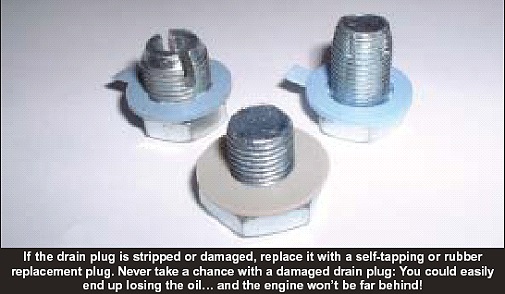

   / Stripped transmission oil plug #8
NAPA or any of the larger auto parts stores carry "oil plug strip kits"... or stop at most "quick lube" stations, they should have an assortment of replacement plugs/sizes...

   / Stripped transmission oil plug #9
Also remember to only tighten enough so it does not leak,easy to muscle it down and keep truning til the threads are gone. Good luck
