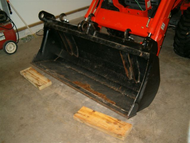

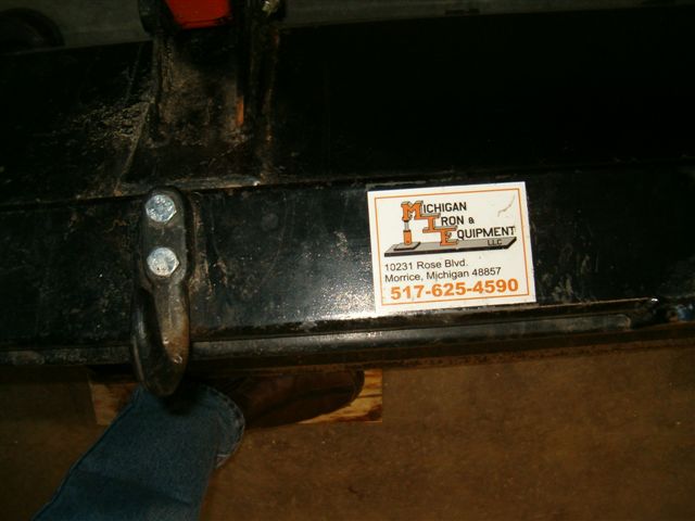

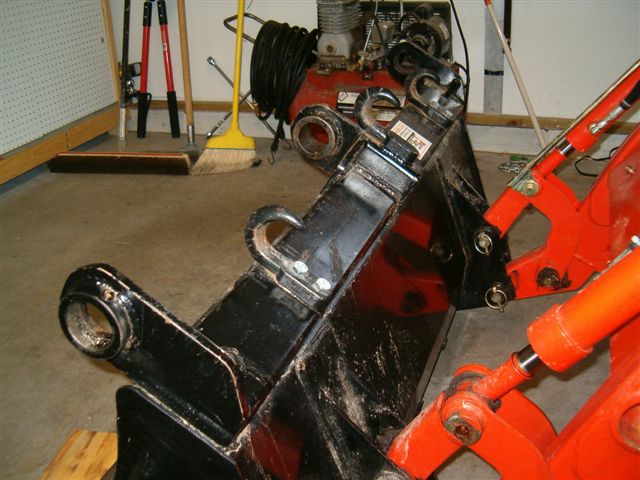

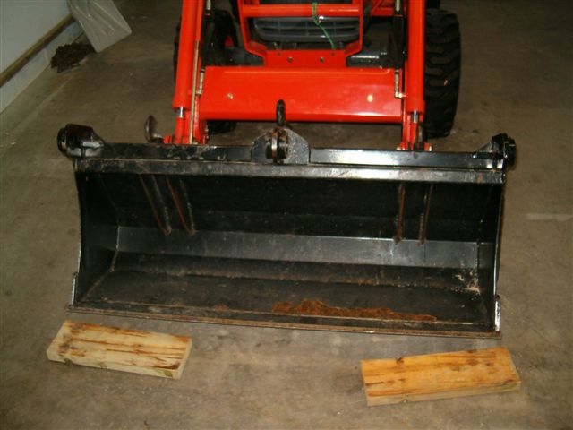

If you are into pulling/lifting heavy objects with a FEL bucket you may want to consider strengthening your bucket. The primary purpose for the retrofitting of my bucket was to accomoodate a set of pallet forks. My bucket had been strenthened at the installed hook locations inside bucket (see gussets inside bucket) when the tractor was initially delivered. Later I asked Michigan iron & Equipment to also fit my FEL bucket for forks. The dual advantage is the way it strengthened my bucket because buckets can be distorted sometimes under heavy use.
Here are some pictures of the nice job of accomodating the above needs that was accomplished by the crafty engineering folks at Michigan Iron & Equipment.

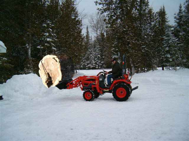

Probably by now, some doubter out there is wondering what in the world is the reason rimshot thinks he needs such a strong FEL bucket for anyway? My answer to that question is Well, just look at the size of the firewood we grow in these parts.:D

I must confess, jimmy. I have had a lot of fun with that overgrown stick of firewood. The picture is entirely bogus and is the results of tinkering with a computer and Adobe Photoshop.

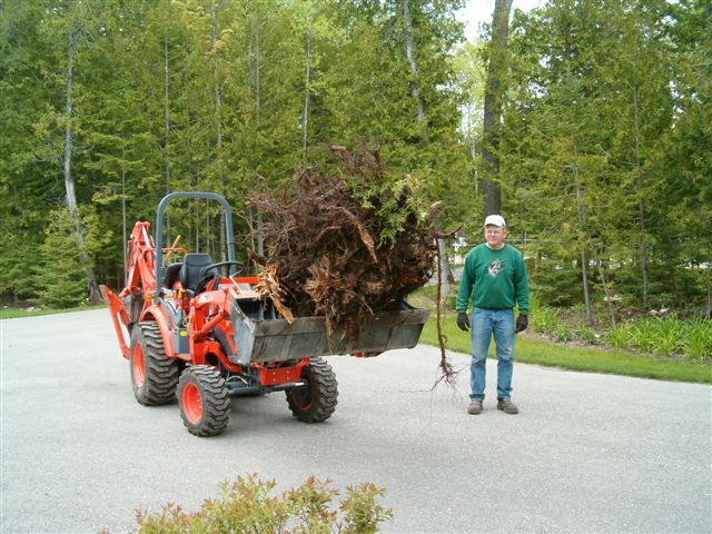

The below picture I can assure you is for real. I could barely get this stump in the bucket. Gotta be careful and use a chain always.

thats gotta be balsa or bogus considering the tiny tractor and no tire

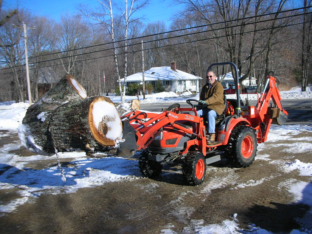

Here's a pic that wasn't Photoshopped. I did have to run it up a snowbank to help the bucket lift it. It's a Silver Maple log and I needed the BH for a counterweight.
