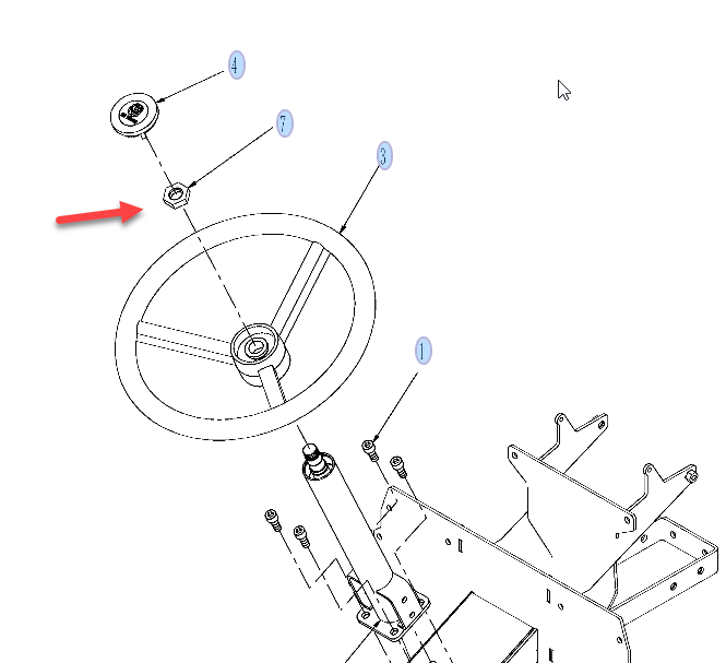

Tc40 streering wheel comes loose if I pick up on it. Normally not an issue but is more of an issue of driving uphill. Any input is appreciated

Not a telescoping shaft or adjustable shaft. It pulls out but goes back in with little issues just need to turn a little to find the notch
   / Streering wheel and shaft comes loose #6
Take the plug (#4) off and tighten the nut (#7).

I doubt it's the wheel coming loose on the shaft. More likely the shaft is slipping up the column and coming free of the steering valve below. There's no breakdown on the steering column so bushings, washers, snap rings, ETC apparently aren't available separately. It's either a complete column or fix what you have.
   / Streering wheel and shaft comes loose #8
While your in there drill a drain hole in the steering tube. Mine was filled with rusty water and crud. The steering valve seal is leaking but after cleaning the tube and seal on the valve the leak is at an accepted level of leak.
