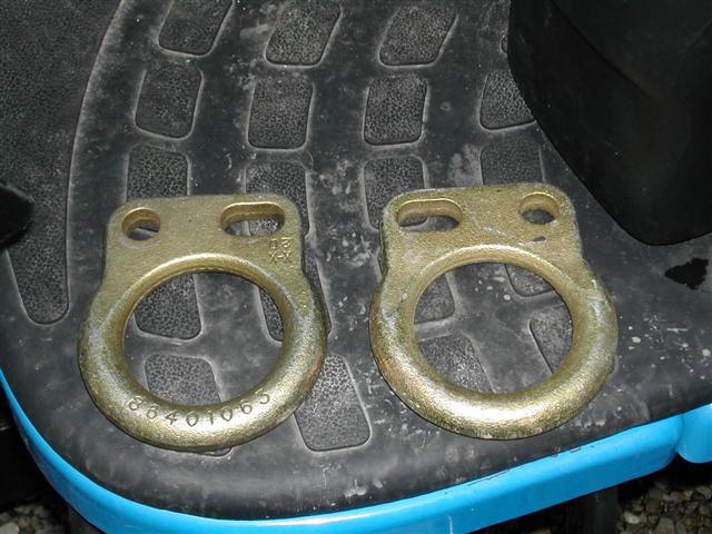

John; I use nothing but Gr70 chains and ratchet binders. I buy my towing/tiedown equipment from AWDirect, just do a search for them, they have all you need.
The attachment is of my TC with the factory tiedowns mounted on the front of the frsme. I get them free from my New Holland dealer. These are the rings the machines are mounted with from the factory for hauling. If they are good enough for them...... I would NOT use points on any removable attachments to tie down. I also use 2 chains feed thru old firehouse, wrapped around the rear axle. That way the axle doesn't get the paint removed.

I haven't trailered my TC18 ever, but I wouldn't mind getting a couple of those to have when I need them. If my dealer doesn't have them, I see they are on Ebay sometimes for a dollar or two.
