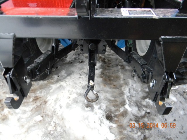

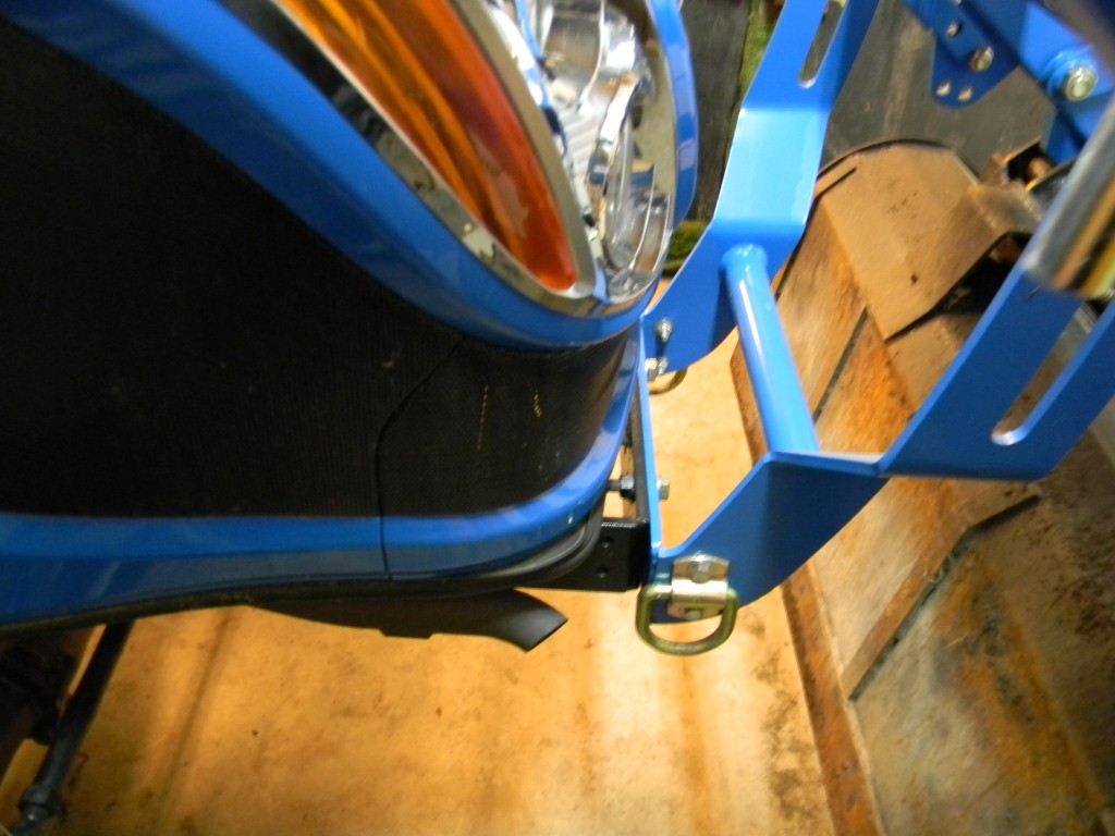

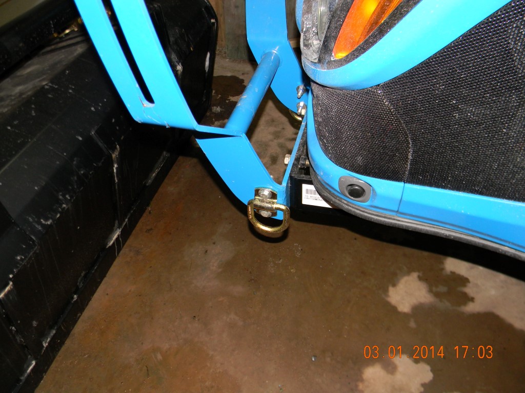

Grizz, I bolted D-rings to the front side frame of my tractor and a large twisted clevis on the rear draw bar for tie down points.
