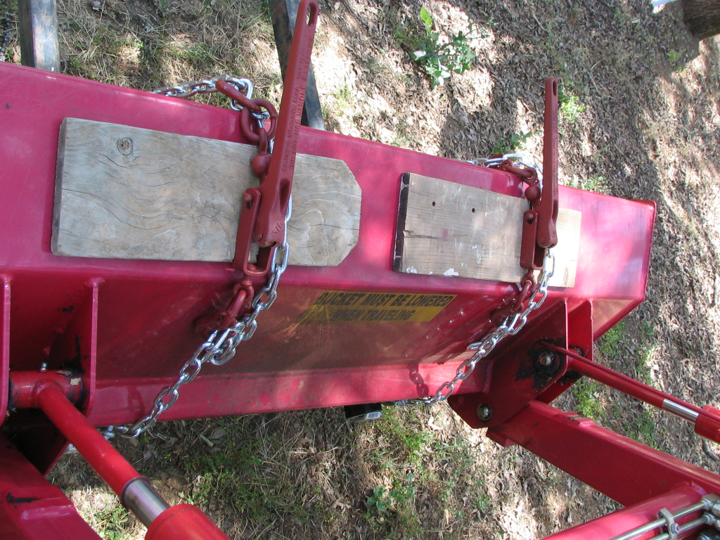

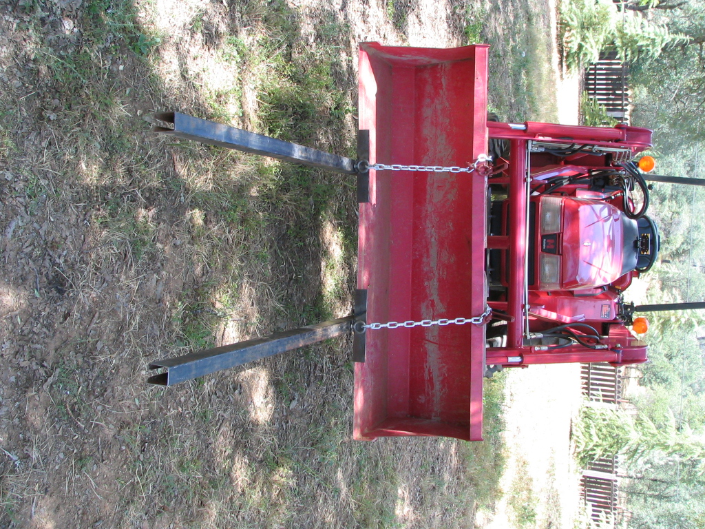

I made my own and they are very similar in design. The only problem I see with the e-bay item is that the forks may shift under load. Mine did. So I welded on the horizontal face plate (pic #1) that runs along the bottom edge of the bucket. Problem solved.
Matt
Matt
Nice job.

prosperity... i saw the tooth bar as well. i might try the forks first and then look into the tooth bar later on.... i have more brush and trees to move than dirt to move right now.
HangtownMatt... i see what you did and understand why... if i get some forks like these i'll weld on some angle iron to prevent the froks from shifting. great idea.

Thanks for this link prosperity. I think it's time for a light weight brush fork, gotta move all my piles somehow..
Great idea with angle welded at cutting edge Matt.
