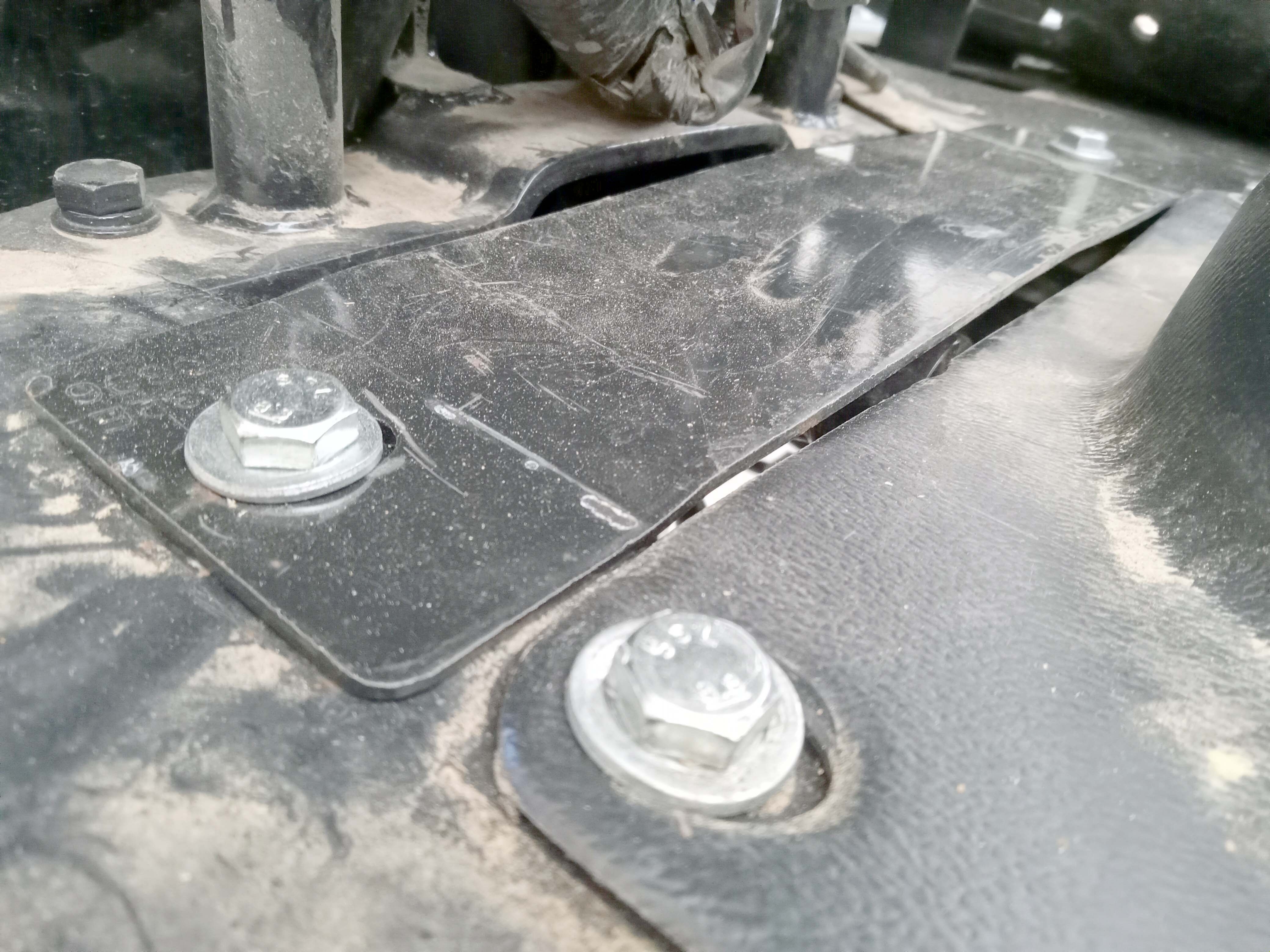

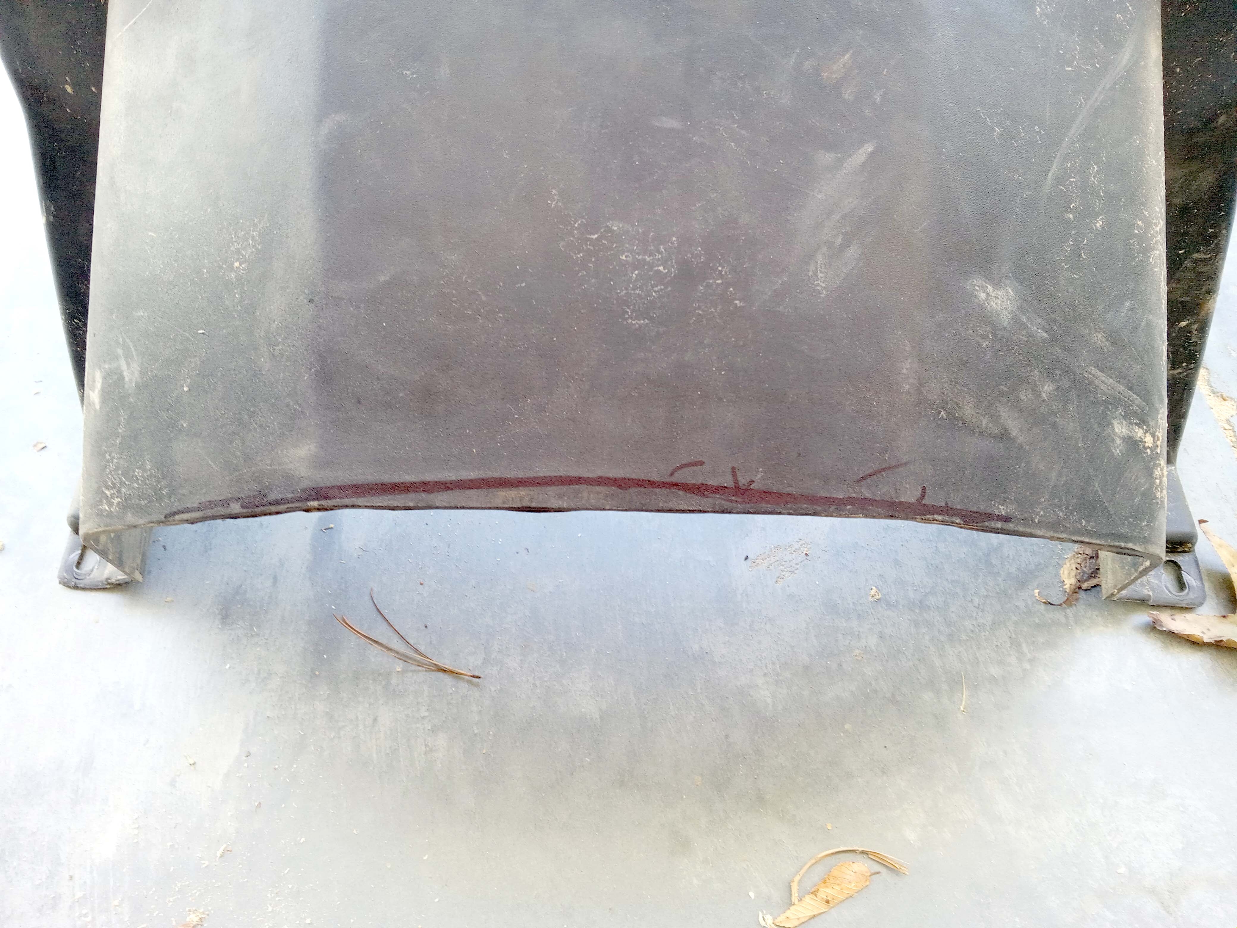

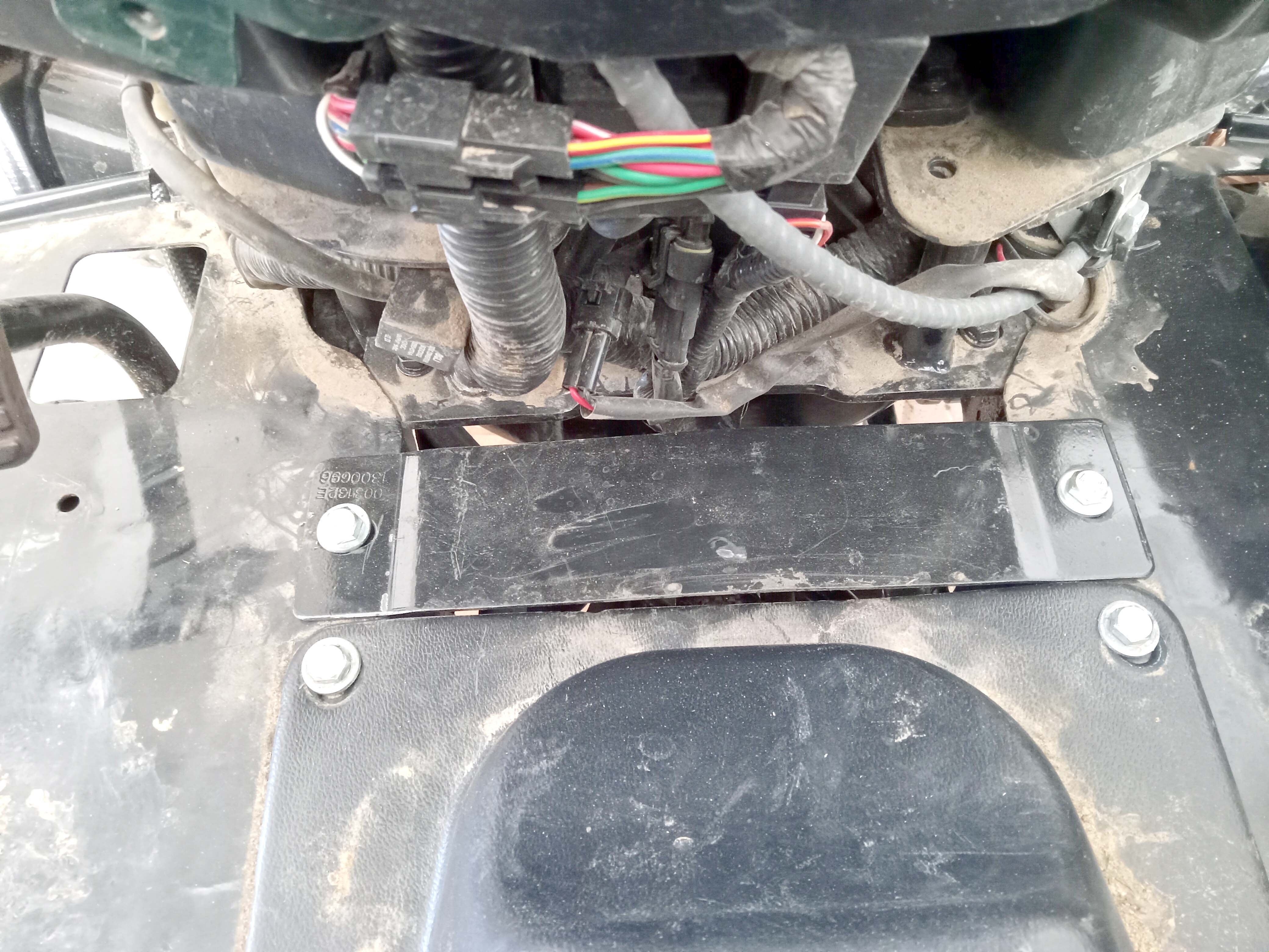

Thanks, isleview for your advice. My issue was what you suggested. When the tractor is making the knocking noise, and you place your hand on the rubber floor mat just below the ignition switch you can feel the knocking vibration. It's a quick fix if you are handy. I removed and bent the u-joint cover plate and re-installed. Just to be safe, I over bent the plate but, upon doing so I had to trim the bottom of the plastic housing which covers the wires located below the ignition switch with a jig saw (removing it from the tractor first of course). You can bend the plate less, but I wanted to make sure there was a lot of clearance between the u-joint and the cover plate. Take your time pulling the plastic fasteners to remove the rubber mat so to re-use.
