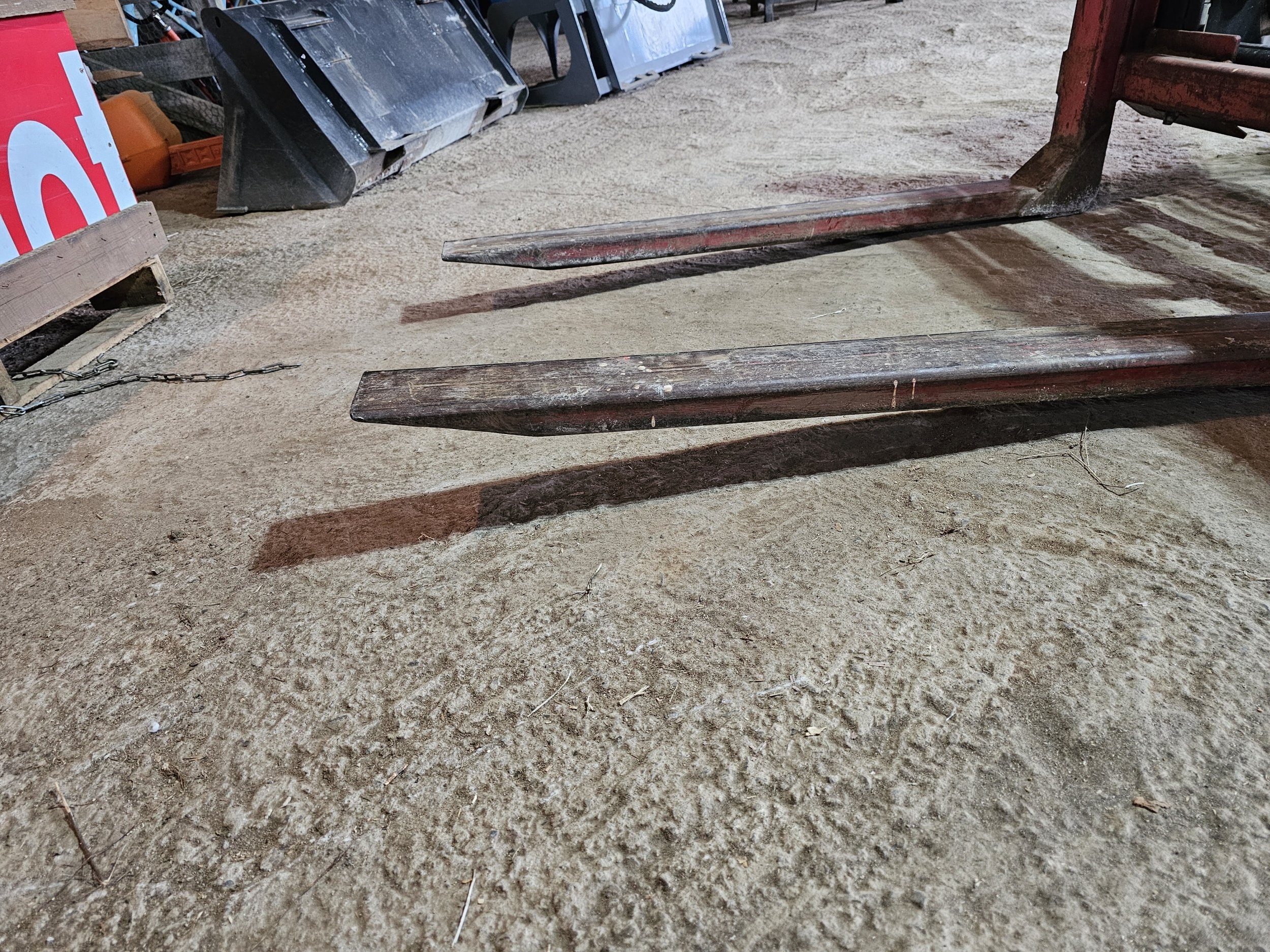

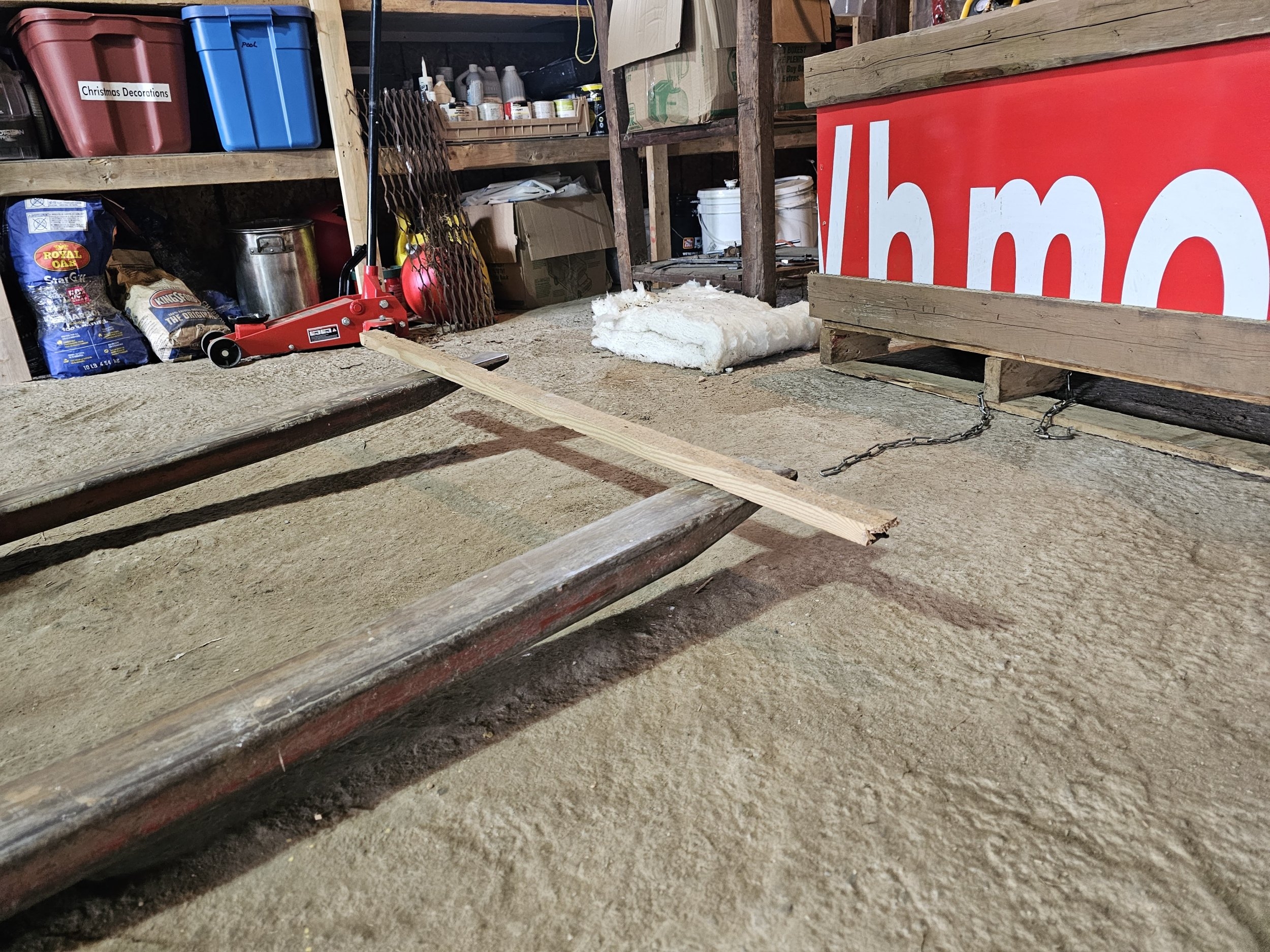

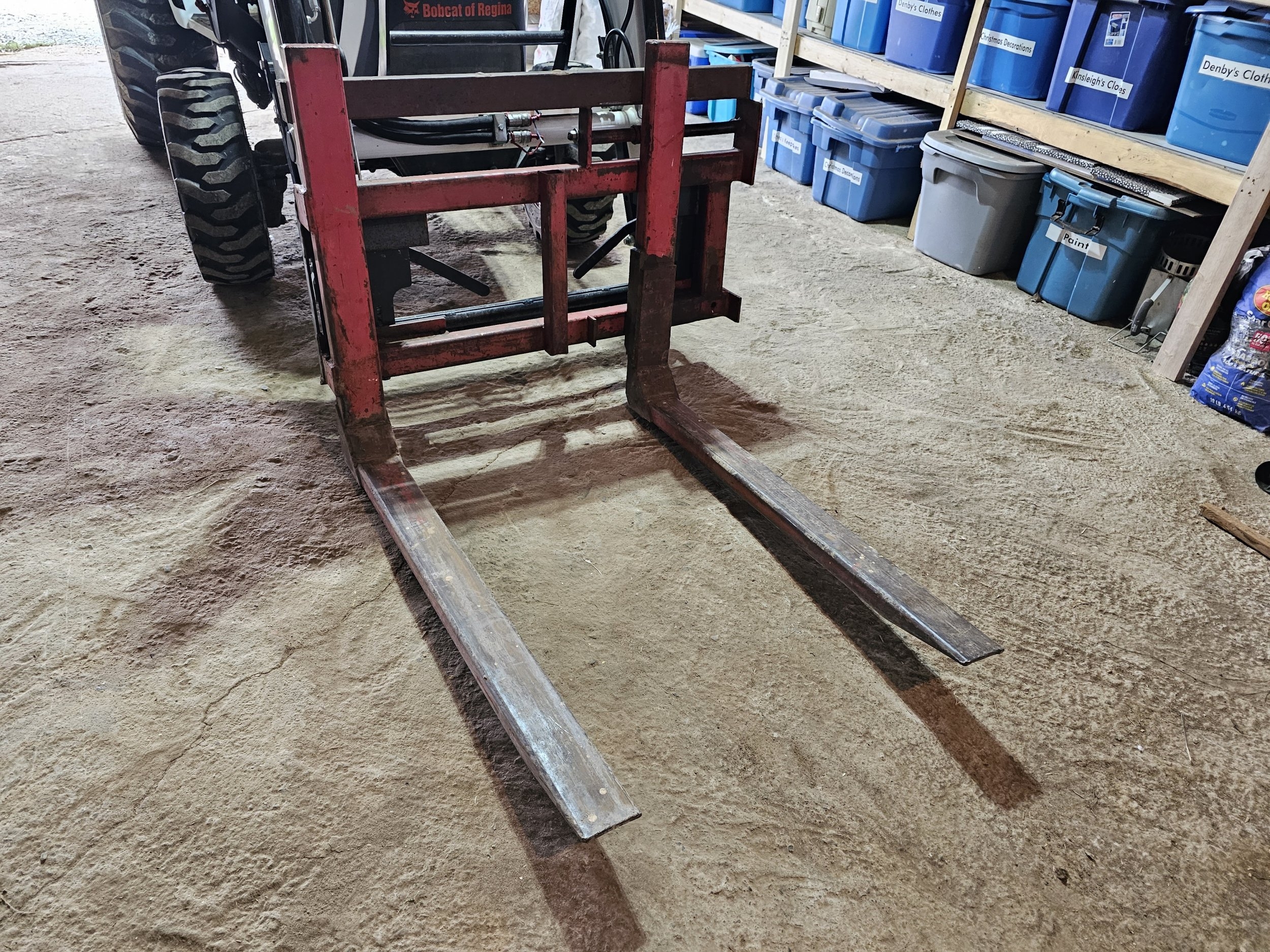

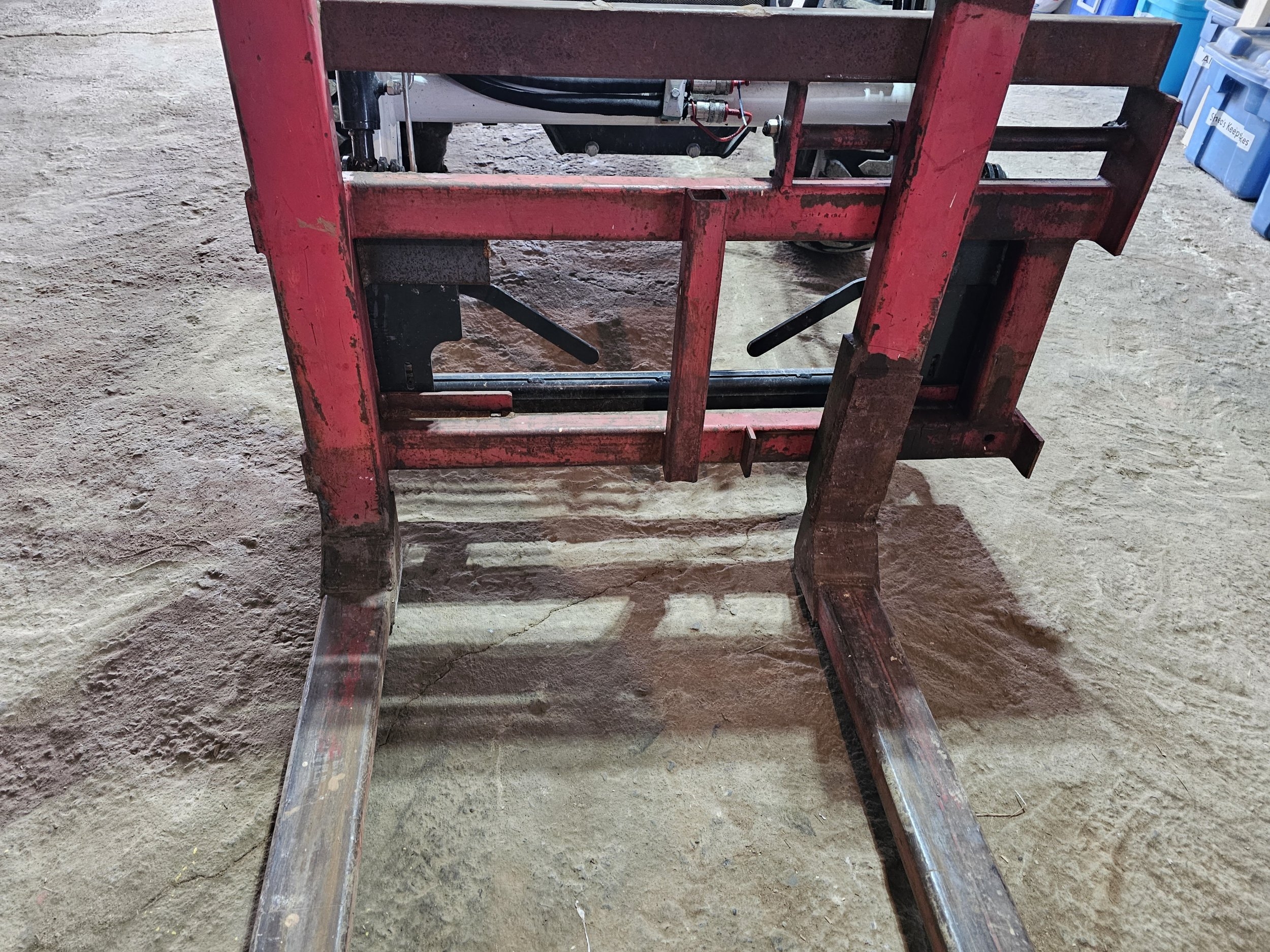

I have a pair of forks I retrofitted to my tractor. They are not quite level. They work, but it can be annoying to pick things up as one digs into earth while other digs into what I am picking up. I am trying to thing of a way to level them out. I have a welder, but not an oxy/acetyline torch. Any tricks for fixing this? See pics.

That appears to be a mild steel tubular steel fork. Not nearly a strong as the hardened solid steel forks from forklifts. But also much lighter weight which would be nice.
Did you build the entire fork and the frame? Or did you make it out of already built pieces?
Was it ever straight?
I think I'd probably try one of these hydraulic puller sets. Attach corner to corner, and start pulling.
Although, I don't think that kit actually includes the pump... so more stuff you'll need.
It will be tricky. You'll have to overshoot a couple of percent as the metal will relax some. So, probably multiple pulls.

Flip forks upside down, cut a notch in fork that has to much up angle, bend down, weld up notch.... IF working with forks upside down remember up is down and down is up....
Or put a long extension on fork that has to much up angle and try to lift something "unliftable", it will cause fork to bend down, let tractor hydraulics work for you...
This is also going on premise the forks are tubular...

No I found them on the property we bought, then I removed the old mount and made a quick attach mount. It seems that the reinforcement is causing the issue, I don't think it was taken into account when the guy built it, and it causes the one fork to be high. I suspect it was never straight.

The notch thing is similar to what I was thinking. However, for some reason I was thinking of notching the top, opening the notching, and sealing back up, and I didn't feel comfortable with the strength of that. However, notching the bottom makes way more sense, and I feel like a bonehead for not thinking of it.
So I could likely just use a zip disk and do the bottom and 2 sides, then check the height. If all is good, weld it. If I need more drop, take a little more off the bottom. But the width of a zip disk on that length may be all I need.

You could try running a few beads on the back side just above the triangular plates on the high fork. As the weld cools and shrinks it will tend to pull the fork down. Or run beads on the front of the low fork. Anyway, there is a lot of length to the fork so the weld won't need to shrink that much to move the tip of the fork.

I just slide them off, slide back on upside down and yank them back the same way i bent them.
When doing that right away, you'll have a good feel of how much force is required.
/ Straightening forks #12
If the fork mount is rigid enough, and the tractor heavy enough, then a heavy duty bottle jack under the tip may be able to bend it. Add a steel plate to distribute force.

First, I would take it off the SSQA and set it on you concrete floor and determine if your fork or your SSQA is bent.
I know in my case my SSQA is bent.

No way am I expert on this but look on youtube where they show doing this. I have a bend in my SSQA and the Kubotat shop manager asked did I want new part or it just fixed. Fixed suited me. He used something to push against that would not move to bend it back. A great friend of mine who has a tractor shop has told me, lift the high side under an item you can not damage nor lift. Keep checking so you don't over do it.
On youtube they show placing wooden block in the curling arms and pulling agains the frame itself. Pay attention so you know what side to block.
