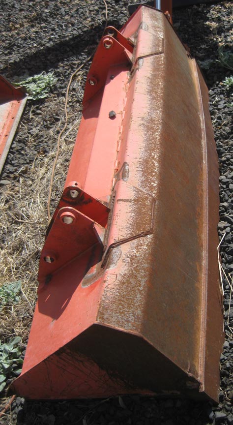

Anybody have suggestions for straightening a bent bucket edge? Apparently the previous owner was using it to remove stumps and rocks (he also ripped off the top hydraulic cylinder mounts). I've tried using screw type chain binders but wasn't strong enough to make it move. Thought about flame straightening, but wasn't sure what pattern would work best. I just thought this isn't the first time a bucket has been damaged like this and there might be a simple solution.
Thanks in advance,
Scot

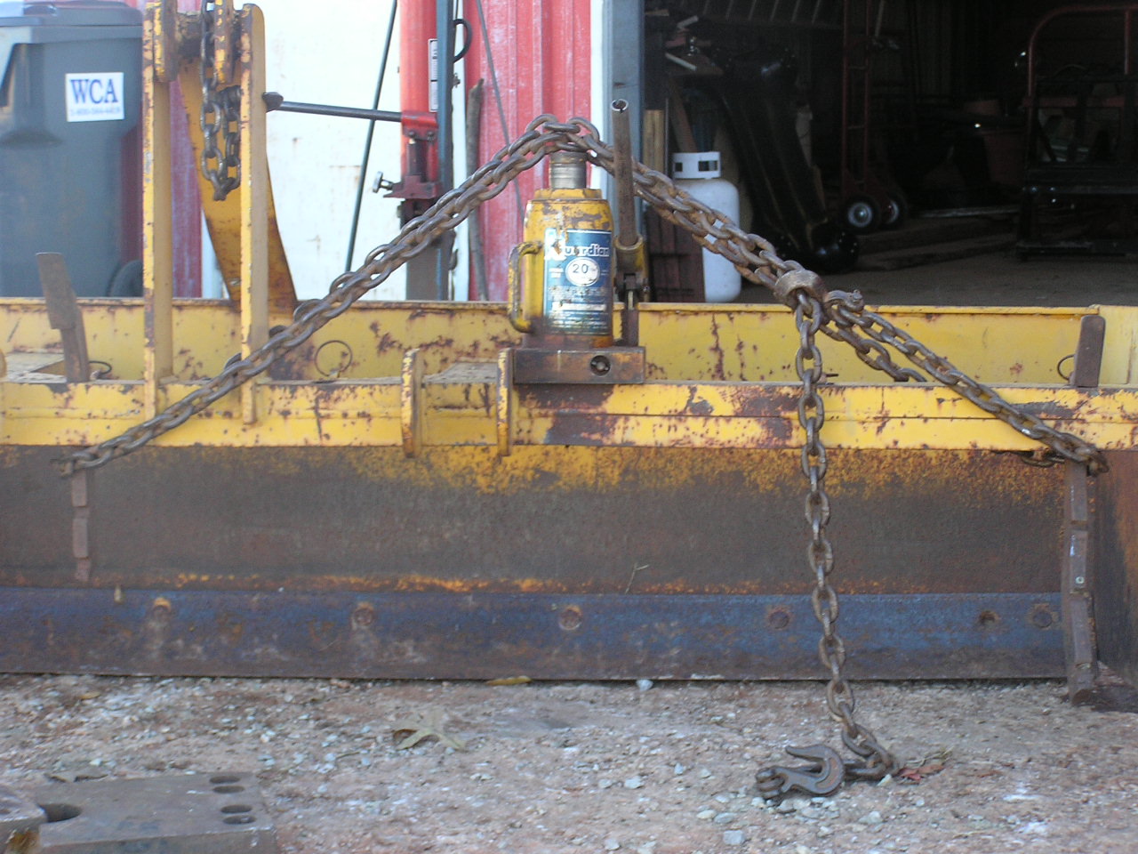

Turn the bucket upside down, put a jack on the high spot, loop a chain under the outside edges. Bend it a little past straight and let it spring back. Keep going a little farther until it springs back straight. :thumbsup:
That is how I straightened my bent box blade.
Gave it a try this morning, and while I was able to get the edge to move about an inch below flat, it sprang back to just about where it started. I only had a 2 ton bottle jack and I could feel the over pressure valve releasing, so I'll see if I can round up a bigger jack and try again. The log splitter idea looks interesting, too, and I think the bucket will just fit, so that's another possibility.
Thanks for all the ideas!

To close this one off, I had to admit defeat after trying both a 20 ton bottle jack, and using the backhoe of a neighbor's giant CAT. The tractor that came with the bucket is for sale, and if they want the old bucket, it's theirs for the taking.
