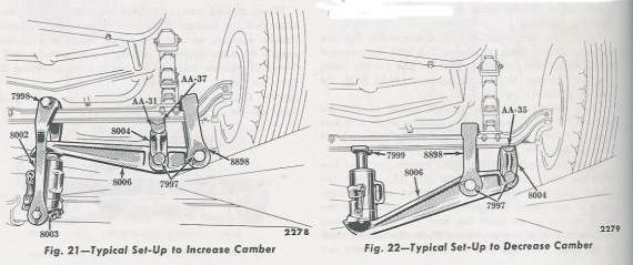

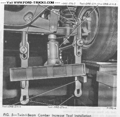

No experience on axles, but saved these just in case. :D
