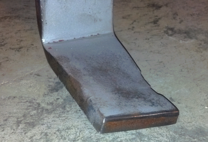

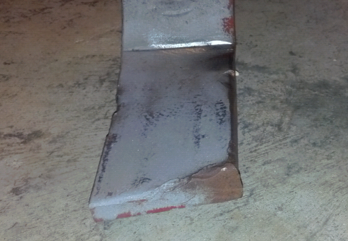

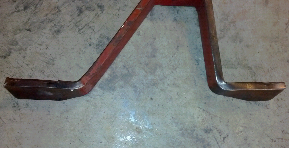

Hello,
This part is from a Leinbach Line plow. I am trying to straighten the arms. Thoughts? I do not currently have a shop press.
I am making new brackets that bolt to this - the originals were bent, similar to this part.
Thanks.

A torch, hammer, and anvil.
A good vise can also help with straightening (or bending) steel.
I think I'd try to bend it hot, otherwise you would run the risk of cracking it, especially since it has already been bent once.

No matter what you use to help you straighten this part. HEAT is going to be your biggest friend.

That looks like 3 x 1/2, 3 x 5/8 hard to tell with nothing to compare it to, either one you're going to be hard pressed to take the twist out of it cold. Straighten you could do cold with an anvil and an fbh, untwist you're either going to have to heat it and anchor one end and use a big adjustable wrench to untwis itt. Doing the untwist cold it's going to need bigger anchor and a bigger wrench....Mike
/ Straighten 1/2" steel #9
Clamp in a vise, heat that puppy up and either pound straight or get a big mother pipe wrench or adjustable wrench and bend straight. No problem if you have a torch. I've bent lots of metal like that and yours looks easy.
/ Straighten 1/2" steel #10
If you don't have the tools to heat and straighten it, just use a grinder with a cutoff wheel and cut the twisted ear off, bevel the edges and weld the ear back on straight. Hammer it out after it is cut off to flatten it out any twist or kinks. Likely to take less time and energy that heat'n and a beat'n.

Sixdogs gave good advice - clamp it solidly in a vise, then heat with a torch to cherry red.
You will be able to straighten it by hand (wear heavy gloves!) or with some gentle hammering.

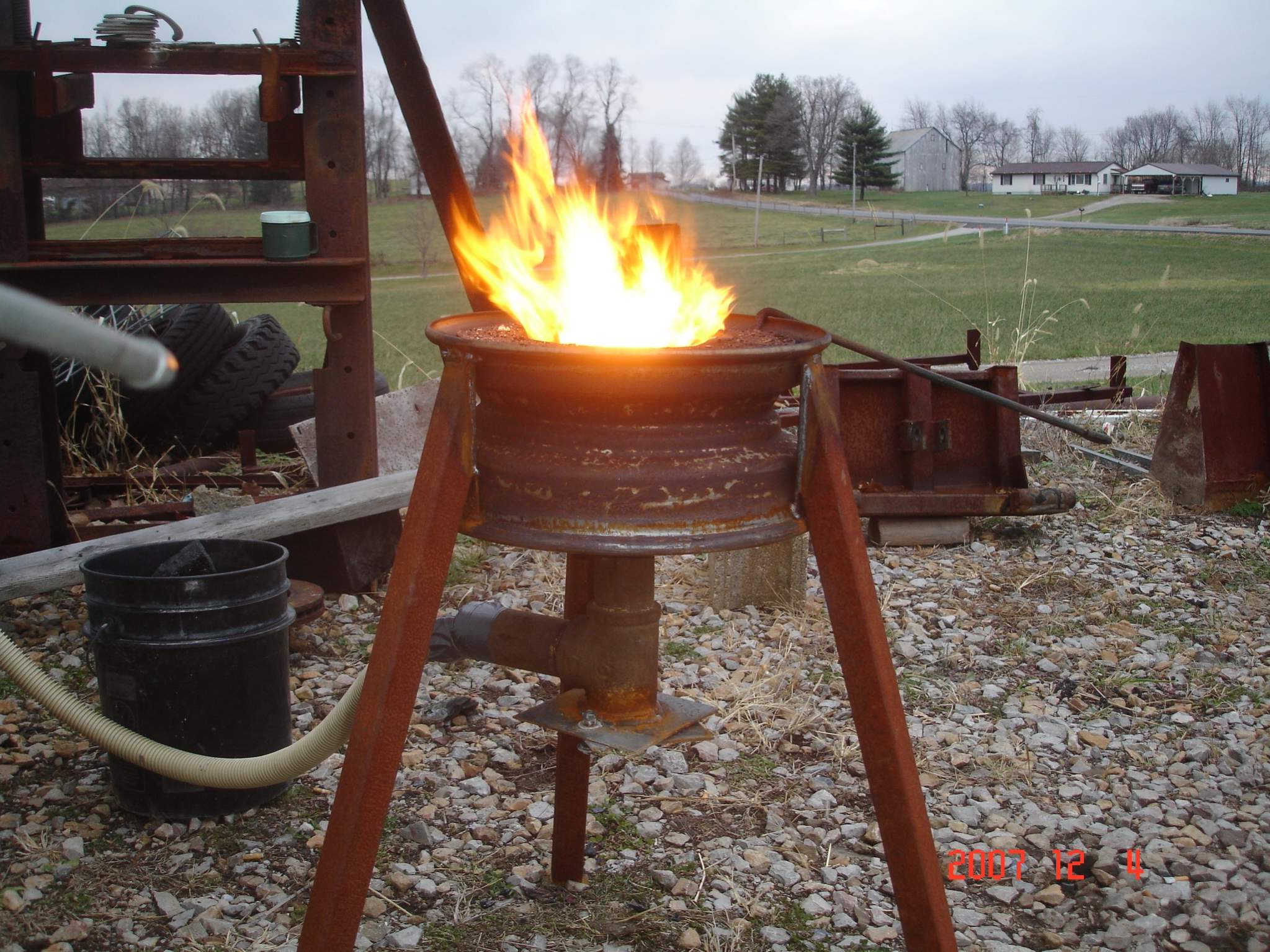

This is my portable forge and blower. The forge is a brake drum with 3 1/2 square rods welded across the opening, a offset inlet for air, a cookie sheet for the table, and rods for legs. Works great.View attachment 308843 I grabbed an old picture- quality is not so good. The blower I got from a friend circa 1900 and fixed up. The anvil was part of a swap - 189 lb circa 1840. I'd advise everybody to have these in their shop!
