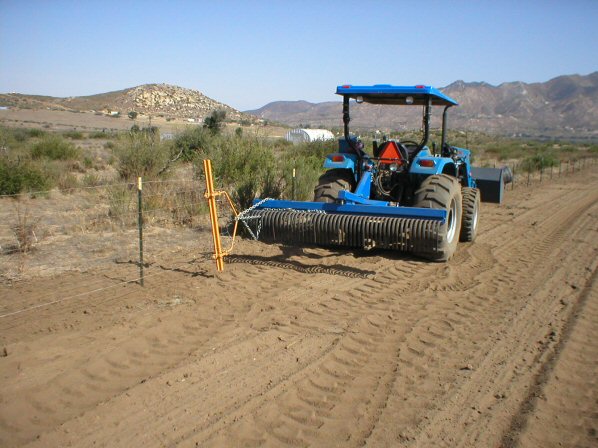

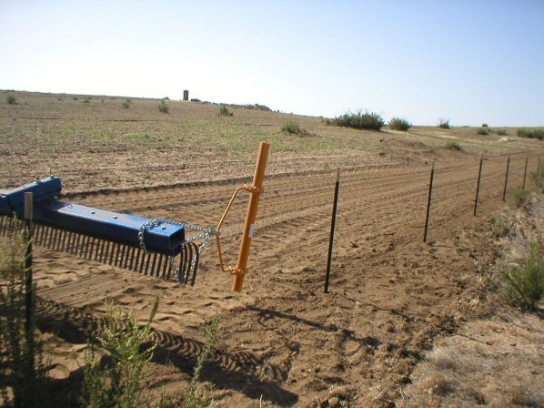

What type of fence did you put up? There are stretchers for barbed wire and for field fence. Both work very well. ;)
I put up Red Brand No-Climb horse fence. I have used stretchers like you show in your pictures and they work very well. When it came to stringing the fence I bought a fence unroller/stretcher from TSC. Not all that expensive and a tremendous time saver.
