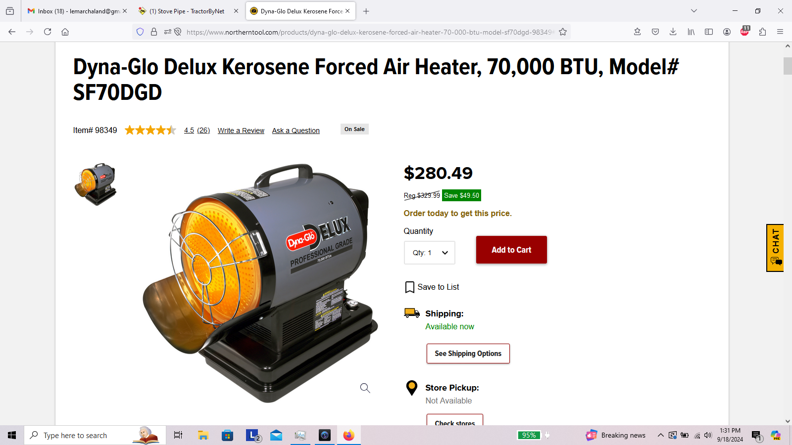

The seasons are turning as fall quickly approaches. Time is running out for many projects, one of which is heating my shop. Last year I bought a kerosene/diesel forced air jet engine heater. It worked well, rising the temps up to a comfortable level during the depths of winter. But those heaters have a few big drawbacks: 1, the fumes are not great to breath. 2, they are noisy. and 3, everything was covered in a layer of condensation.
While the condensation was not the direct fault of the heater (it's more due to the difference in temps between outside and inside without proper insulation, vapor barriers, and airflow), it still was a problem.
