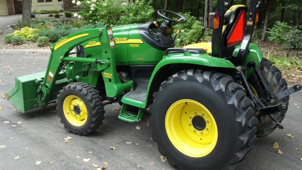

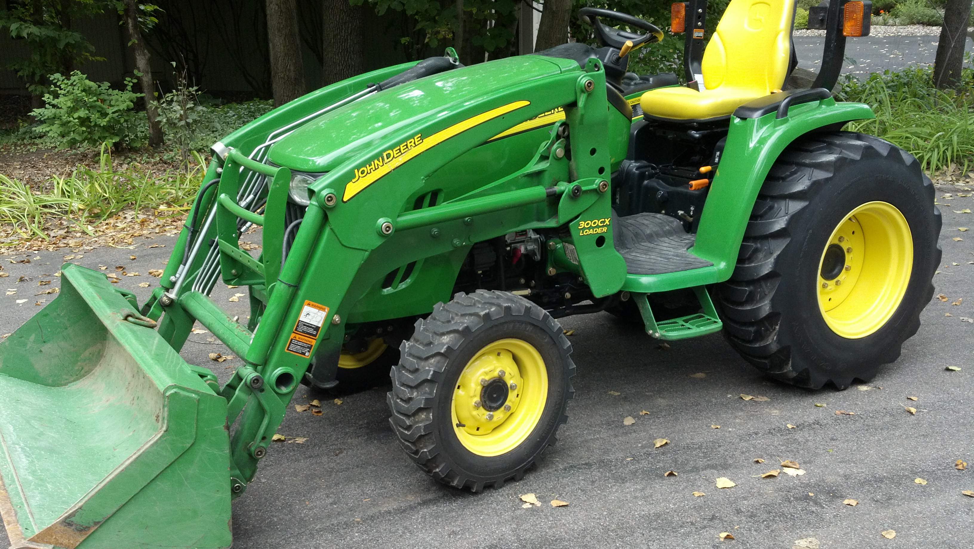

Here is a couple pictures of the new tractor.
