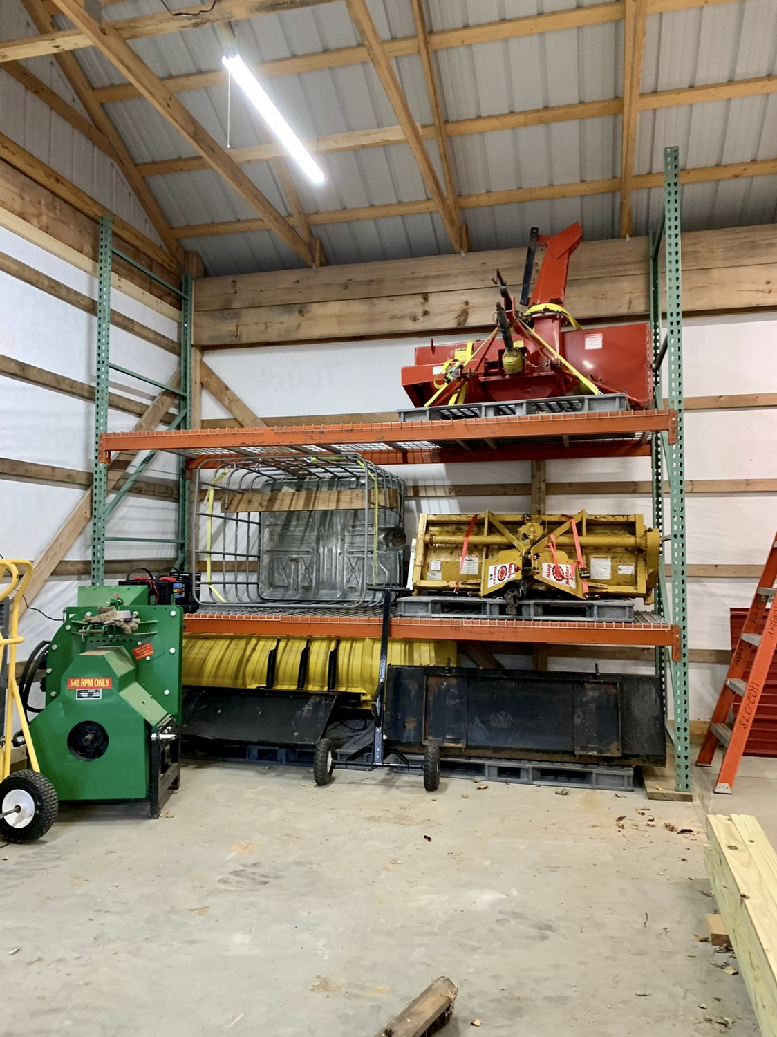

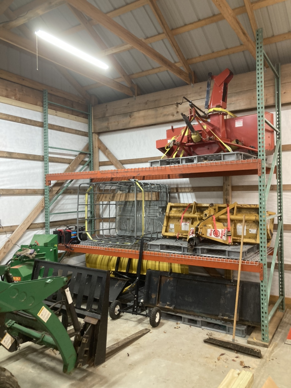

Like many tractor owners, I have slowly been collecting a number of implements. Bucket, forks, man lift cage and plow up front and tiller, snowblower, bush hog and chipper on back. Wanting to keep them out of the elements, but not having a ton of extra floor space, I decided to go vertical. I picked up a 12’ x 12’ pallet rack with 3 shelves on Craigslist for $700 and mounted it to the frame of my new pole barn with lag screws. I picked up heavy duty plastic pallets on CL for $20 each and strap each implement to a pallet and then use the forks to place the pallet on a shelf. Each shelf is rated for 5000 lbs, and in reality each one will hold 1500 or less. Pretty happy with how it all works. Only my bush hog won’t fit, so it will stay outside for now.
Anyone have any additional suggestions?

I picked up a 12’ x 12’ pallet rack with 3 shelves on Craigslist for $700 and mounted it to the frame of my new pole barn with lag screws. Only my bush hog won’t fit, so it will stay outside for now.
^ Snip ^
I thought you would never ask. ;)
Pull rack away from rear wall enough to alow impliments to hang over and prevent accidently hitting wall while moving things around. That wil alow rotating long,narrow impliments. If you are concerned with stability,run a 2x4 from top of rack to building frame. Move man cage to vacant spot on top and bucket from floor to where cage was. Park the hog on floor where bucket is now. If hog must live outdoors,clean top and underneath deck and "prop"deck upright aginst a post so water doesn't stand on deck and reduce condensation on underside. Overall you did a nice job. 👍
/ Storing Tractor Implements
Thank Jaxs. The chipper will be going on the top shelf, its on the ground right now because I still have to assemble it - adding the intake chute extension on the side and the exit chute on top. With the exit chute in place, it will be too tall to fit on the other shelves. I do like the suggestion on giving a little extra space as I have been wondering how long before I puncture the wall with the forks!

Make sure you clean every nook and cranny of your equipment that has been outside. Mice will love the new pole barn home after you move them indoors.

I was surprised to see your building doesn't seem have roof insulation. Where I was in western Washington it was almost mandatory to prevent the roof from sweating on cold mornings. It would rain inside and wet things a bit.

If you don't plan adding another upright and beams,consider cantilvered arms suspended from upright. Fabing arms is simple if you have a torch and welder. Arms can also be made from angle iron by drilling holes for carriage bolts with heads to fit teardrops in upright.

Looks good...I don't think fastening the uprights to 2x10's would pass a safety inspection. They should be securely fastened to your concrete floor or shimmed with steel plates.

When I planned the barn, I was going to have plywood sheathing on the roof to combat condensation. OSB was $13 a sheet and the roof would need 48 sheets. So only $600 bucks. But when the roof went up, OSB was $56 a sheet and $2700 was too much for the budget. So far we have not had any condensation issues. I'm keeping my fingers crossed.
The 2x10's on the bottom are to spread the weight of the legs out across a larger area. Didn't want to crack the concrete floor, especially at the back edge where the legs are only a couple inches from the edge. The top of the uprights are lag screwed to the carrying beam and corner post of the barn. But good idea to bolt the legs to the floor.
