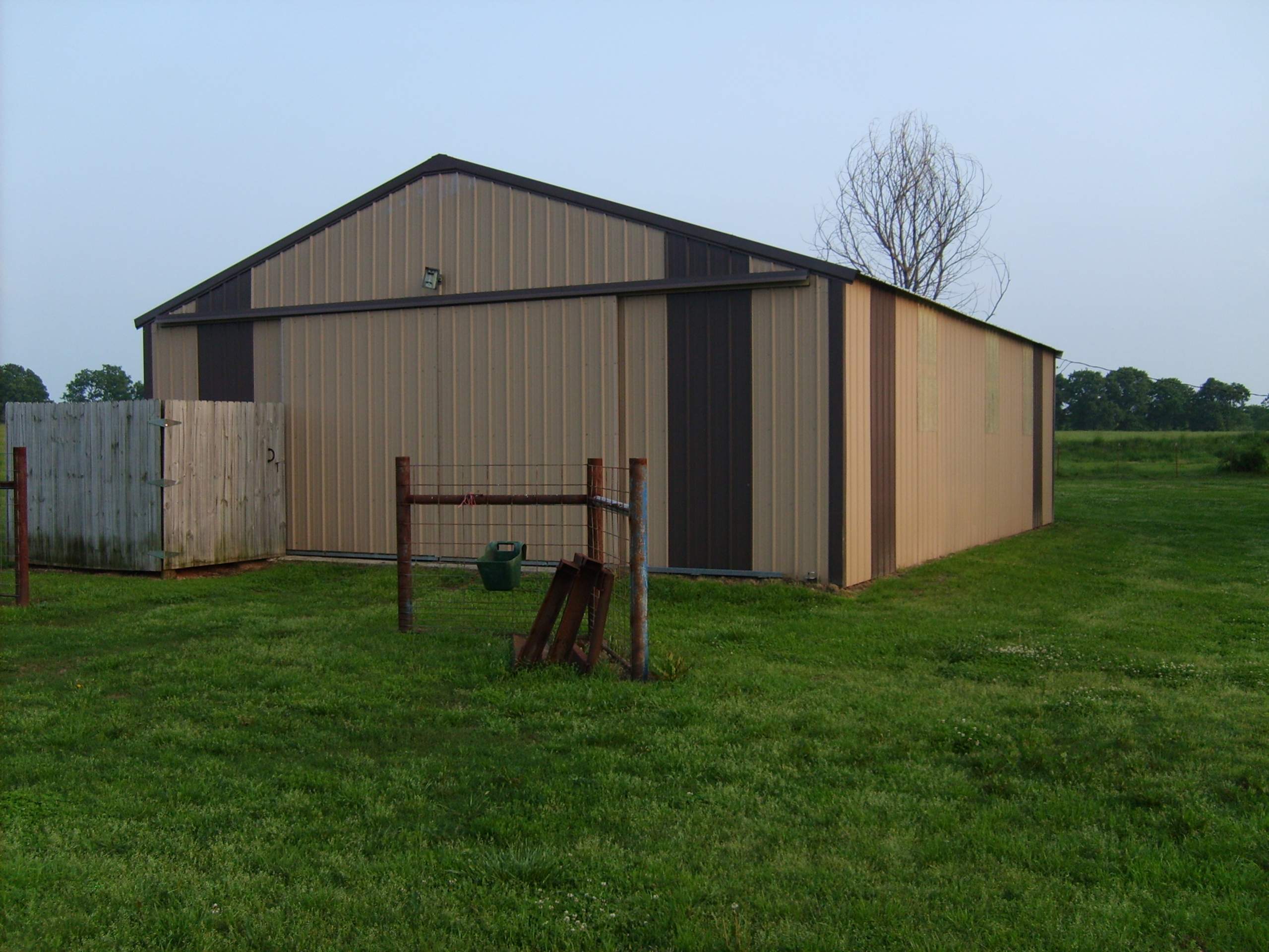

I have a "rack" that I store mine on. It's actually a old section of warehouse rack with boards on top. I have most of my "short iron" sitting on it somewhat divided into kinds of steel (tubing, angle, rod, etc.). This sets behind my shop. Since then my SIL was getting ride of a privacy fence I used some of the sections to build a "fence" enclosure around it to kind of pretty it up. I made one side into a sort of gate to access the material inside. It's not out of the elements and allows things to rust up some but works for me. It's the ugly little fenced in area to the far left in the pic below.

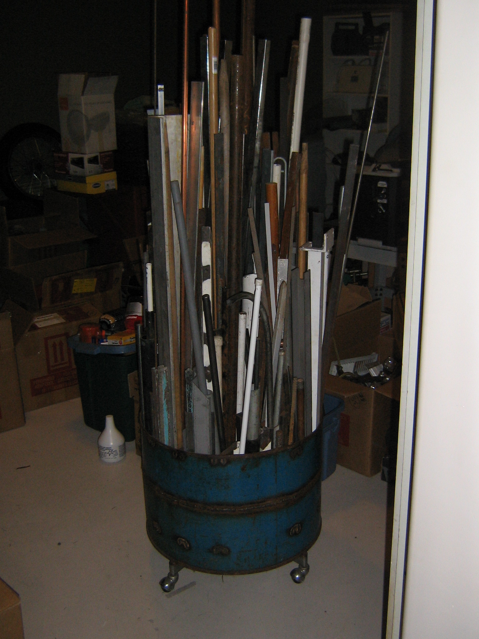

Sorry for the poor picture, but it shows my storage rack. One-half of an oil drum, welded to an old chair base, with dividers welded in to help everything stand up. Not very fancy, but it works well. It's easy to look for different materials. Anything too short to stand above the rim is segregated into milk crates that I store on top of each other. Anything longer than about six feet is stored horizontally on another rack that I've not had time to rebuild since I moved last fall. I will be watching for a better solution if there is one.

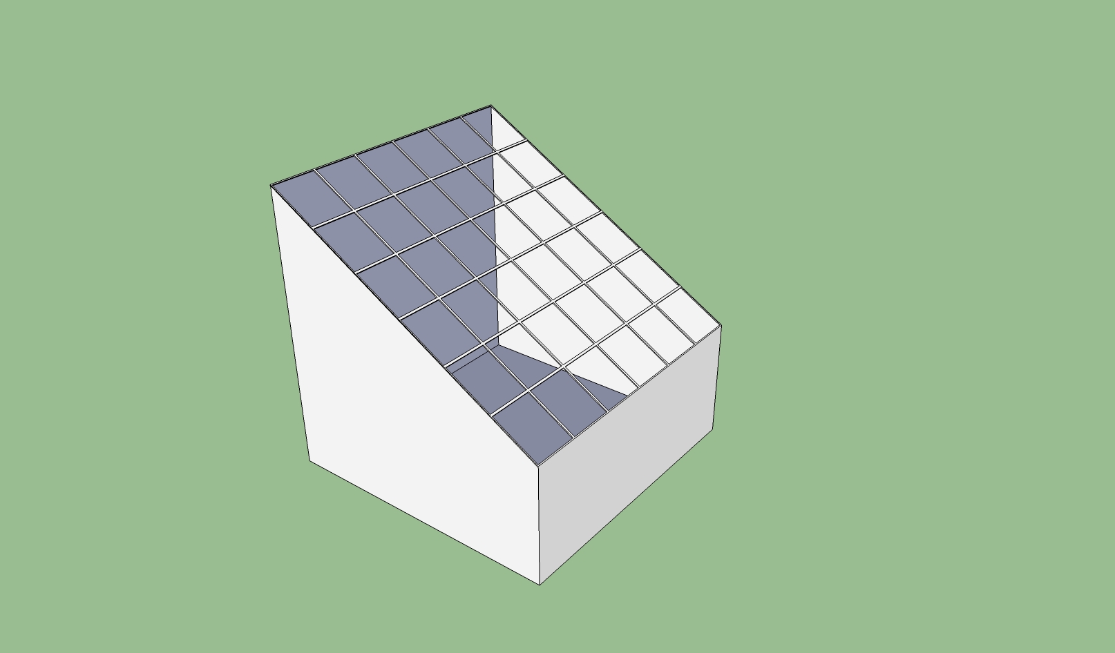

Here's an idea...
Make a box out of any kind of scrap: plywood, wafer board, metal, etc. make the box slope so that the front is the height of your short pieces and the back is the high enough to hold your long pieces. I'd suggest the back be at least half as high as the long pieces. Get a piece of field wire, hardware cloth, or hog panel, the stuff that looks like a grid. Fasten the grid accross the angled top of your box and store the cutoffs upright. You could arrange them accross the front according to shape and diameter and back according to length.
Here's a picture since I don't have a thousand words to describe what I'm talking about.

i like the rolling barrel for longer pieces.:thumbsup:

I like this and I have the place it will fit. I'll put a set of wheels on it!:)

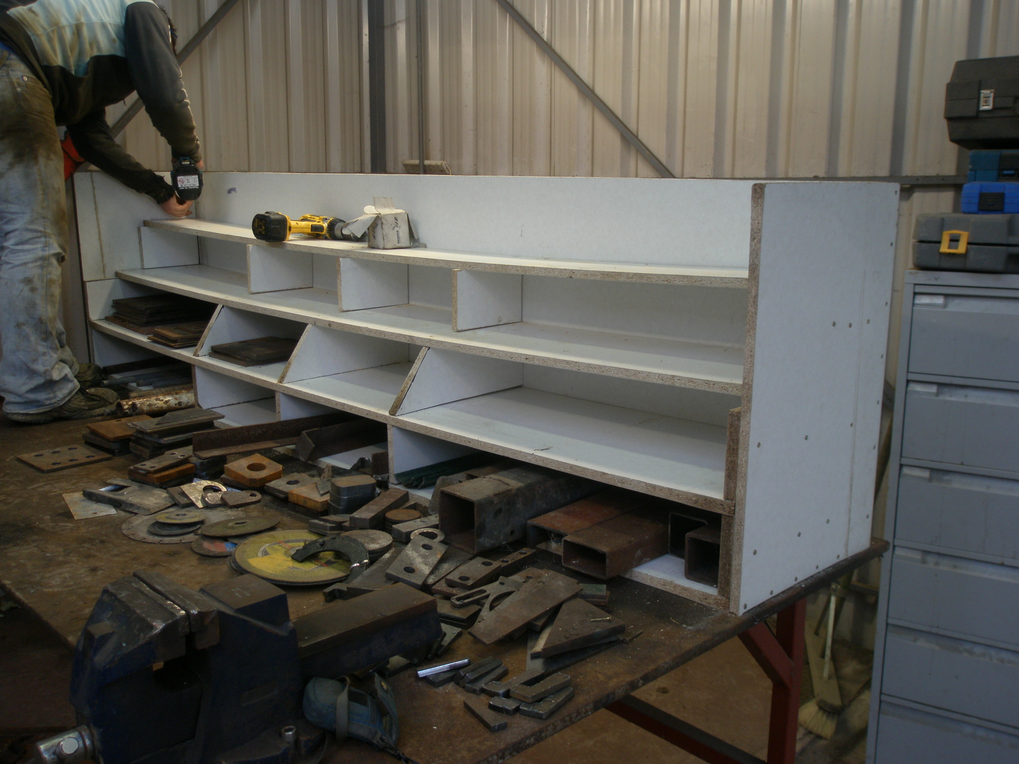

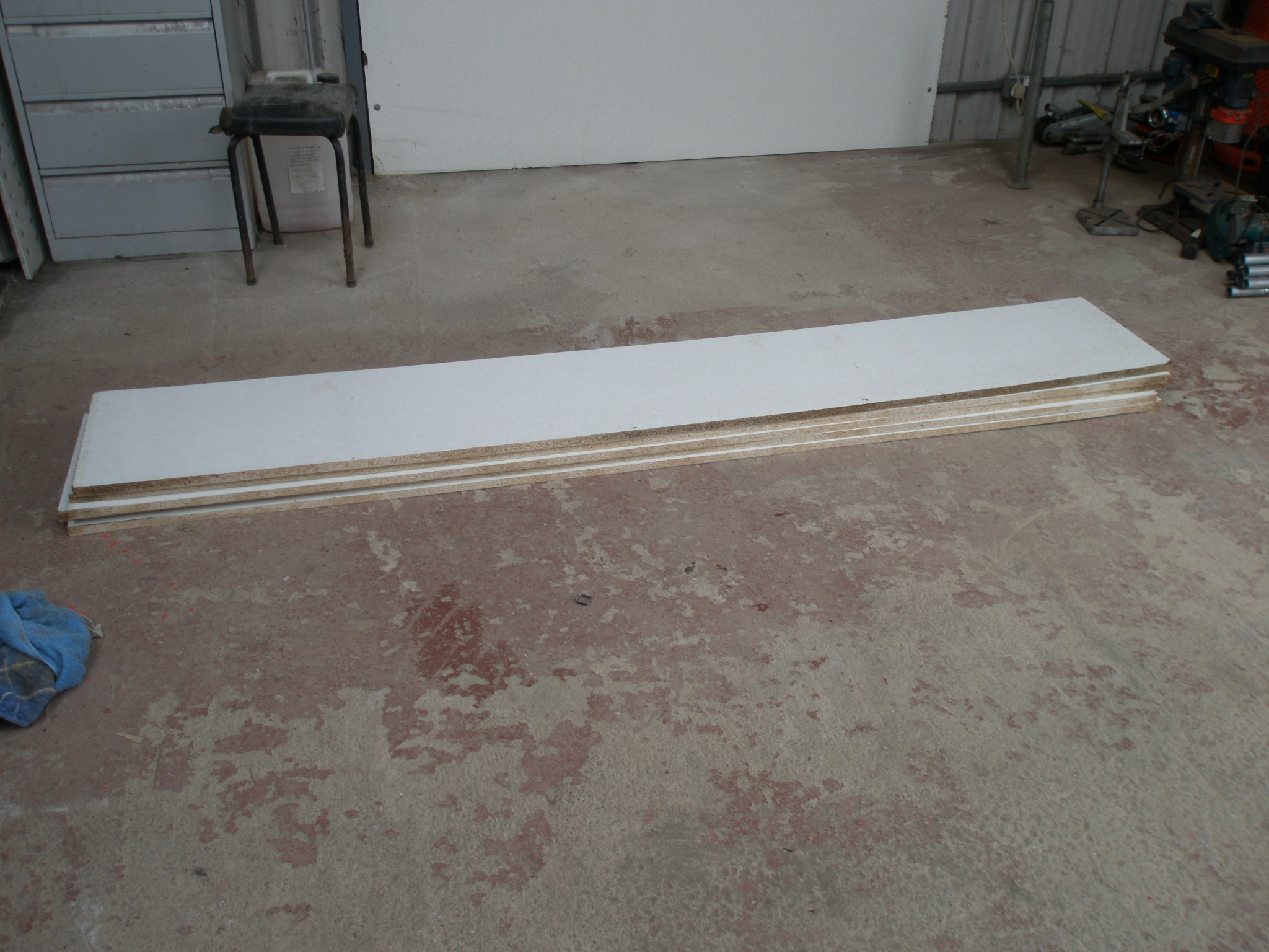

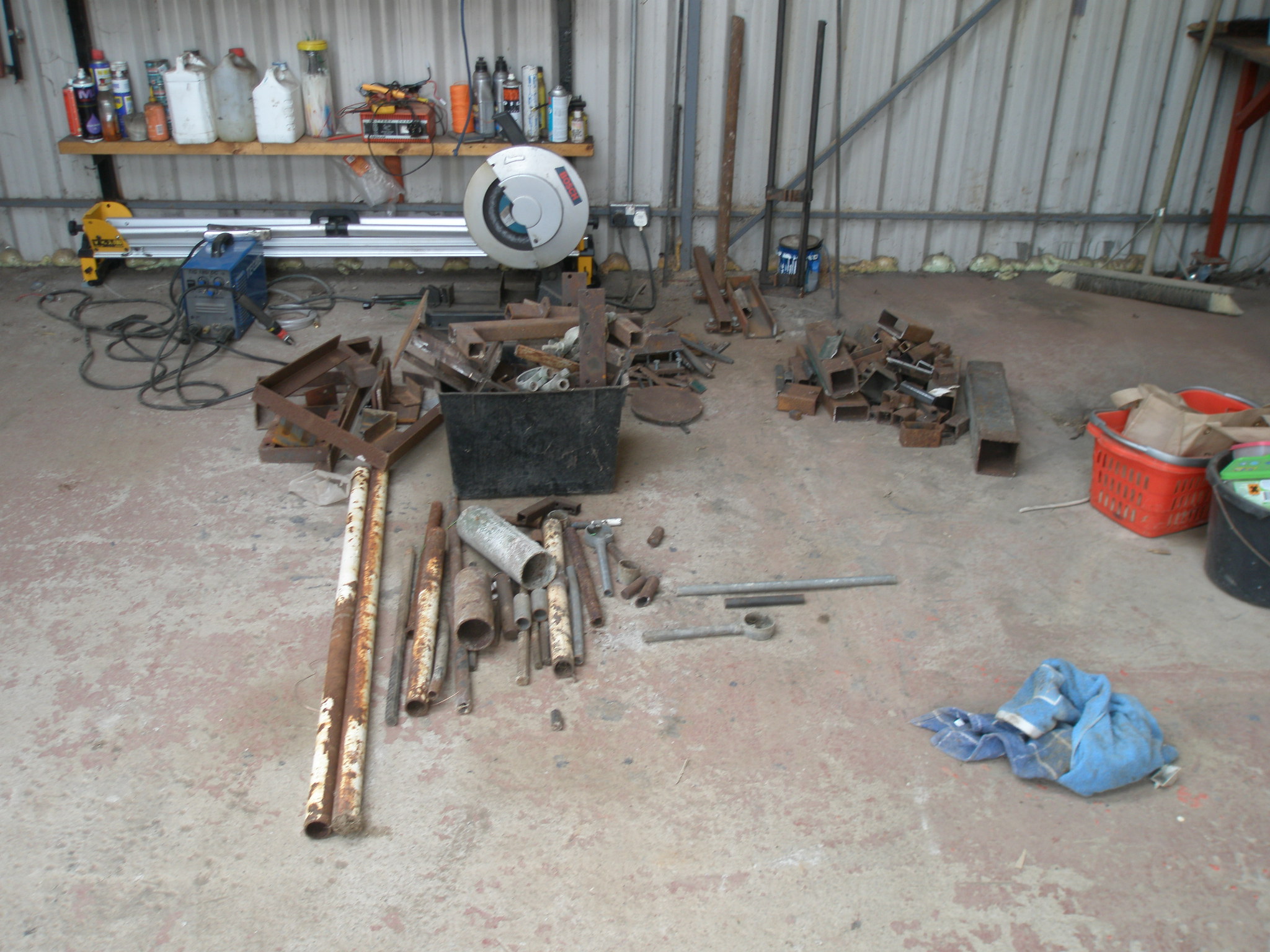

Thanks everybody for your input and pics. It has been really helpful. We had some laminated timber going spare around the house so my brother and I decided we would build like a pigeon hole press that a few of you have described.
Iplayfarmer, the drawing you suggested will be made for longer pieces of steel.

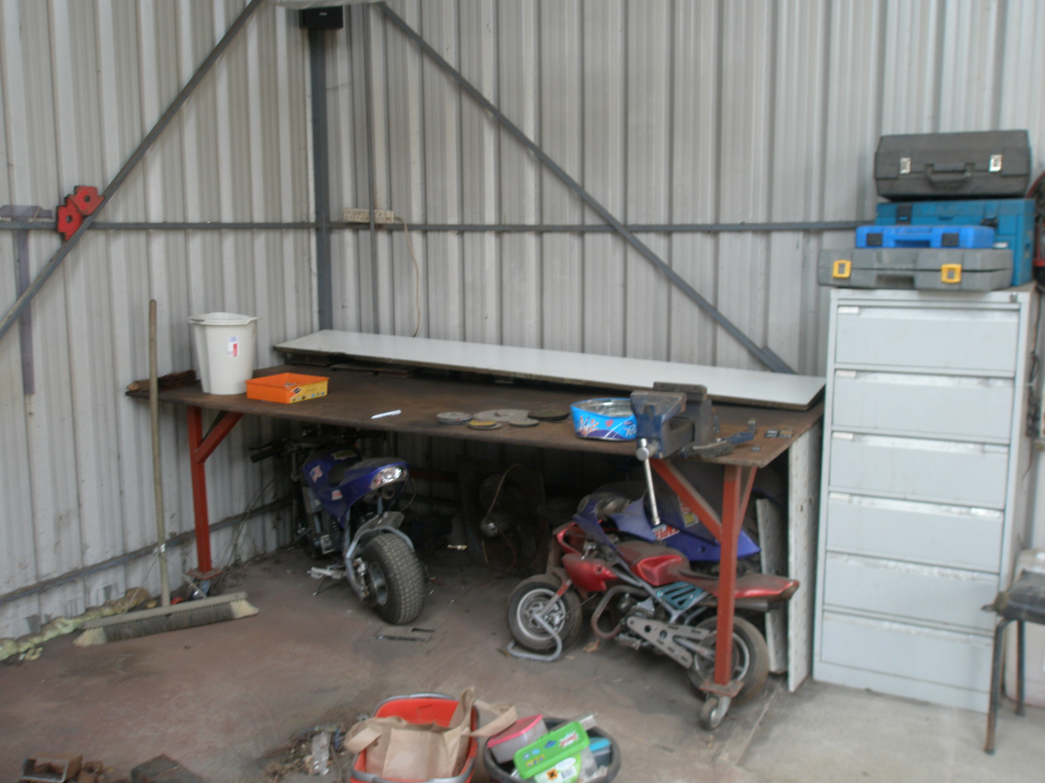

Here is a picture of what I was dealing with. Bear in mind that this was it tidied up. It was a lot worse

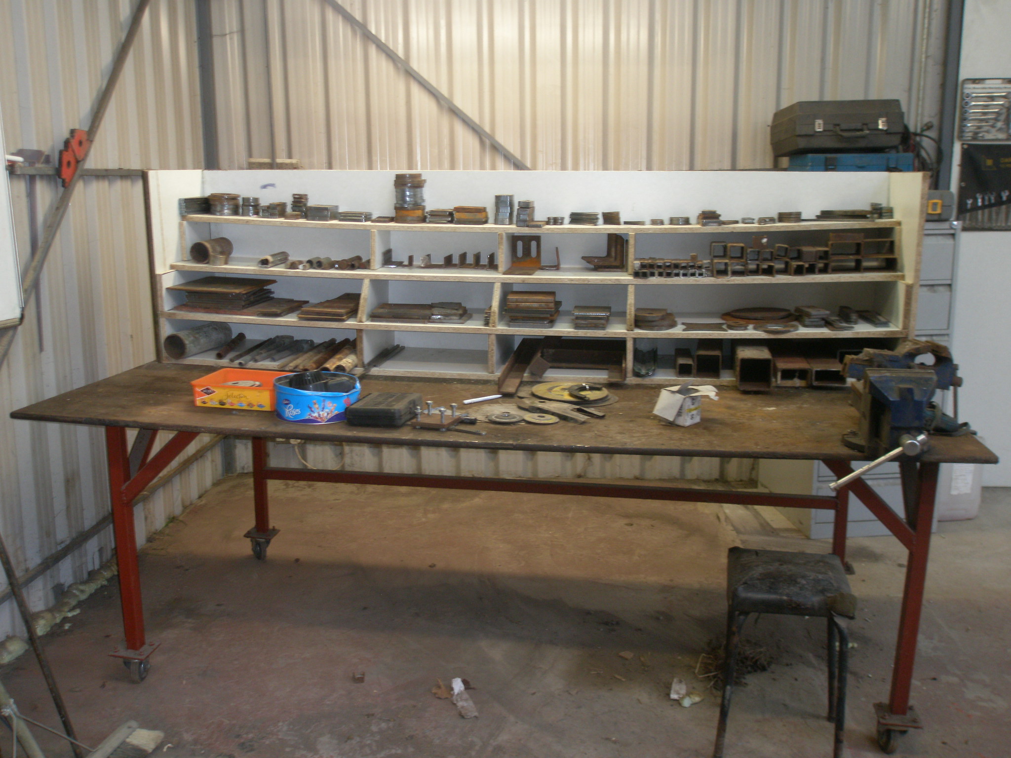

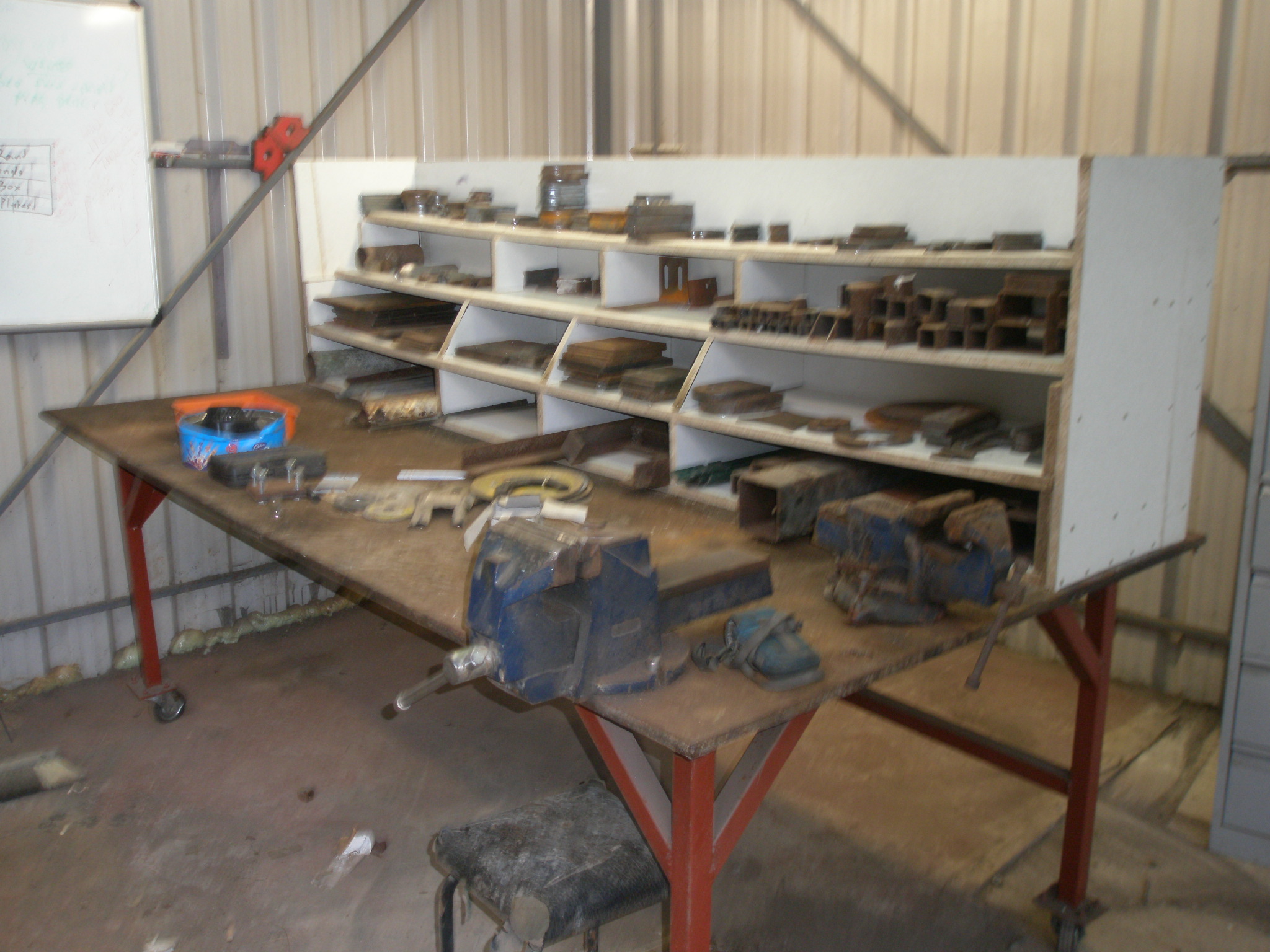

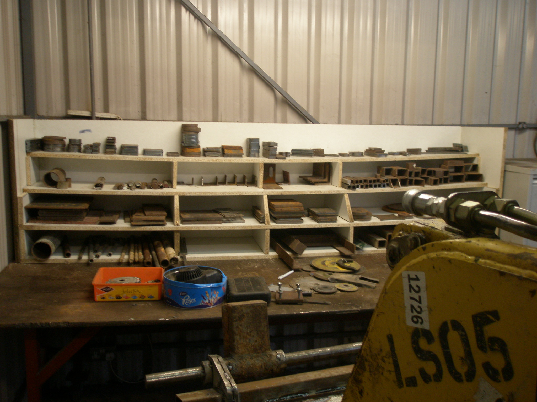

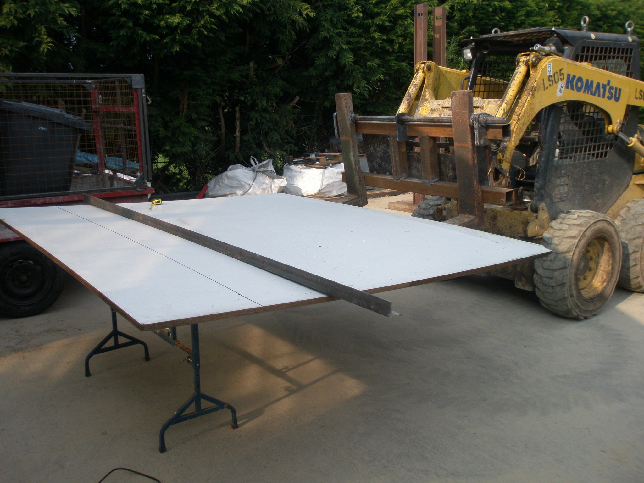

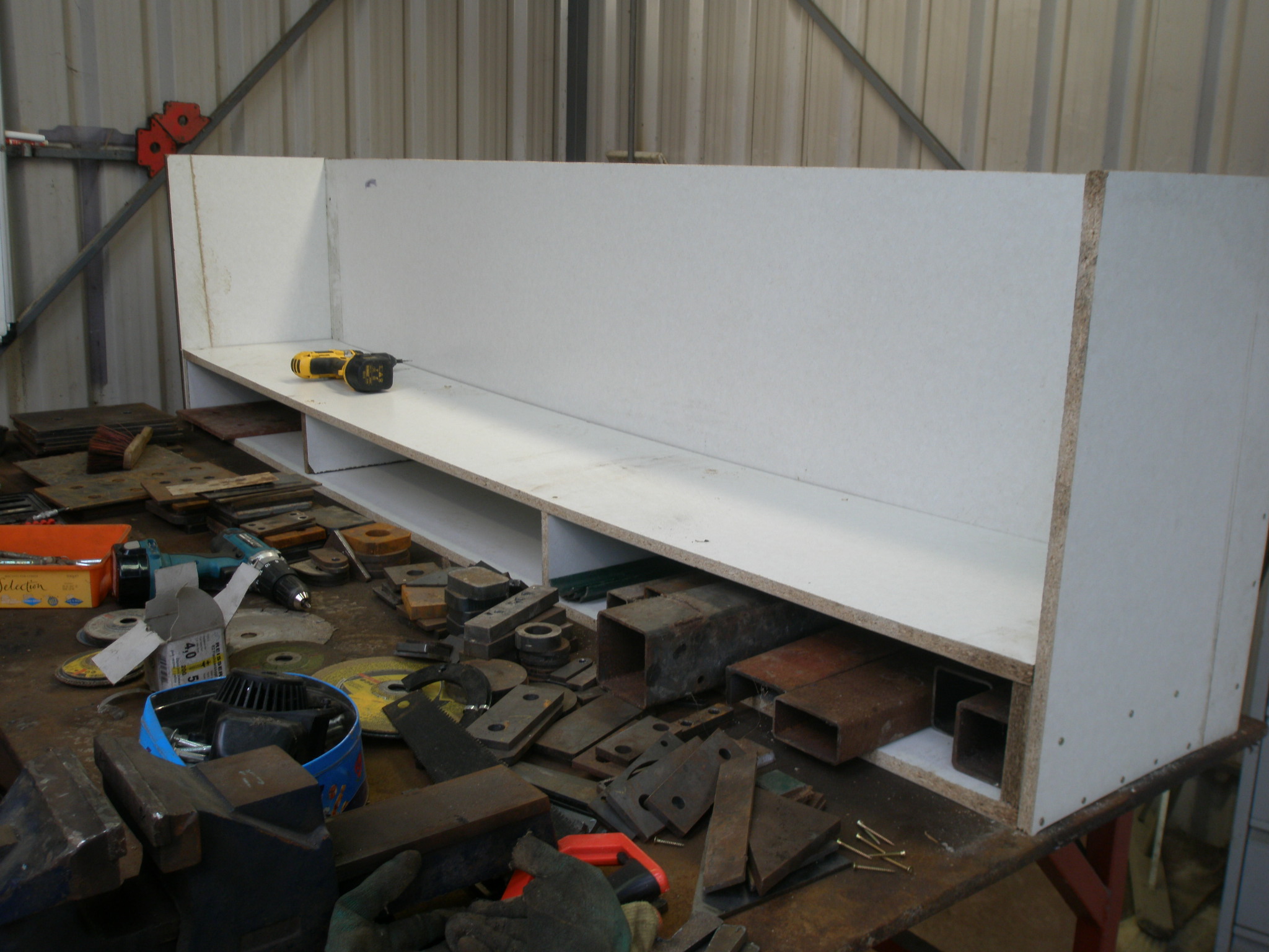

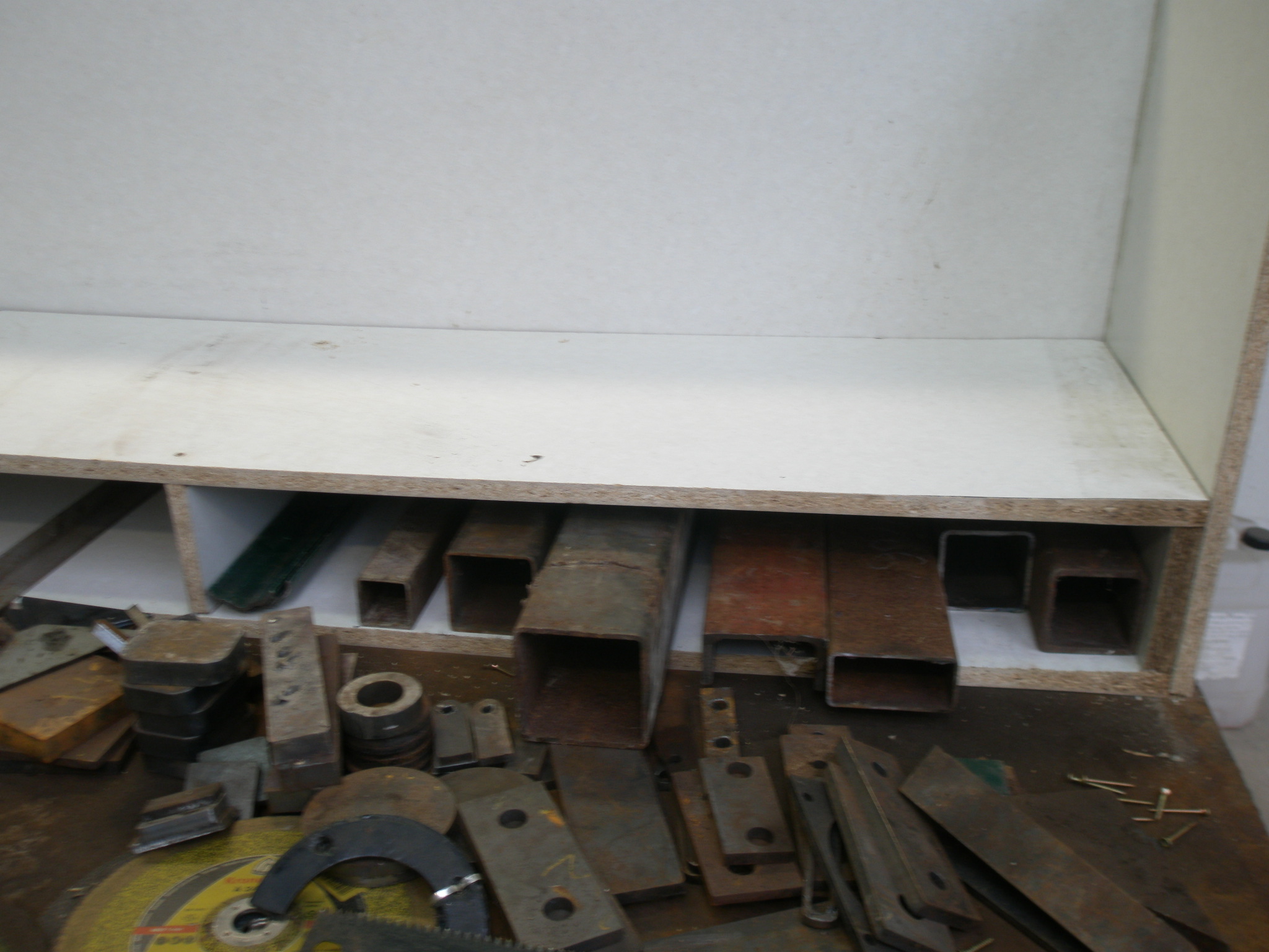

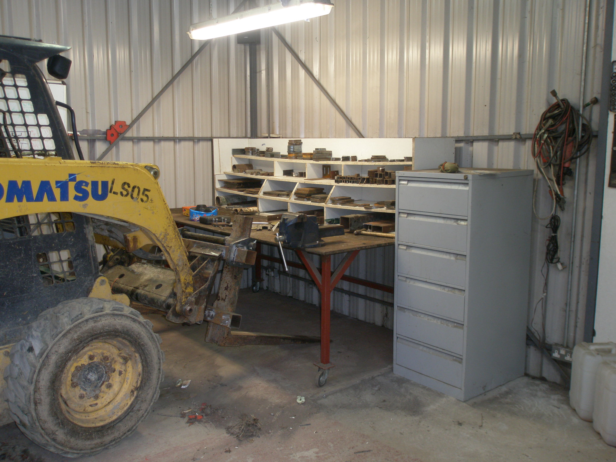

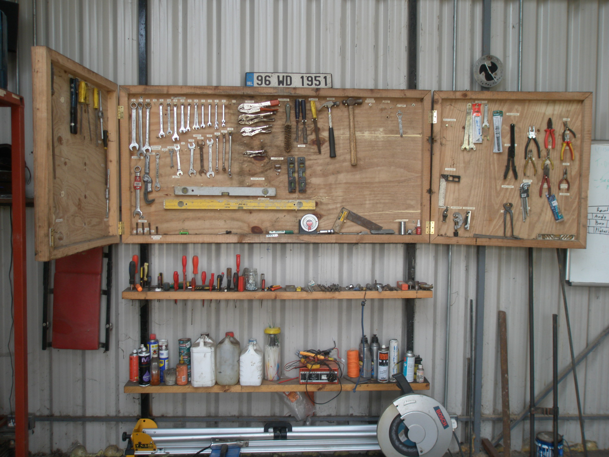

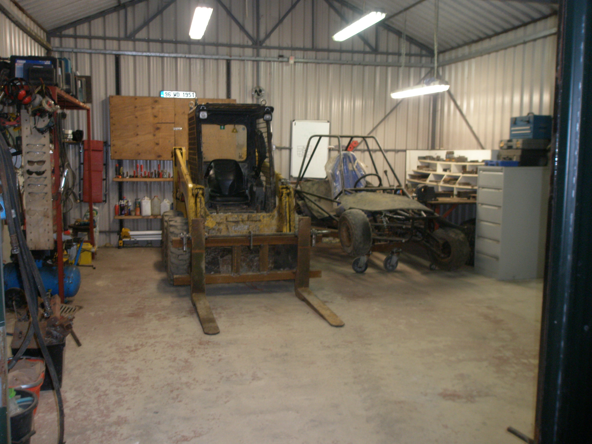

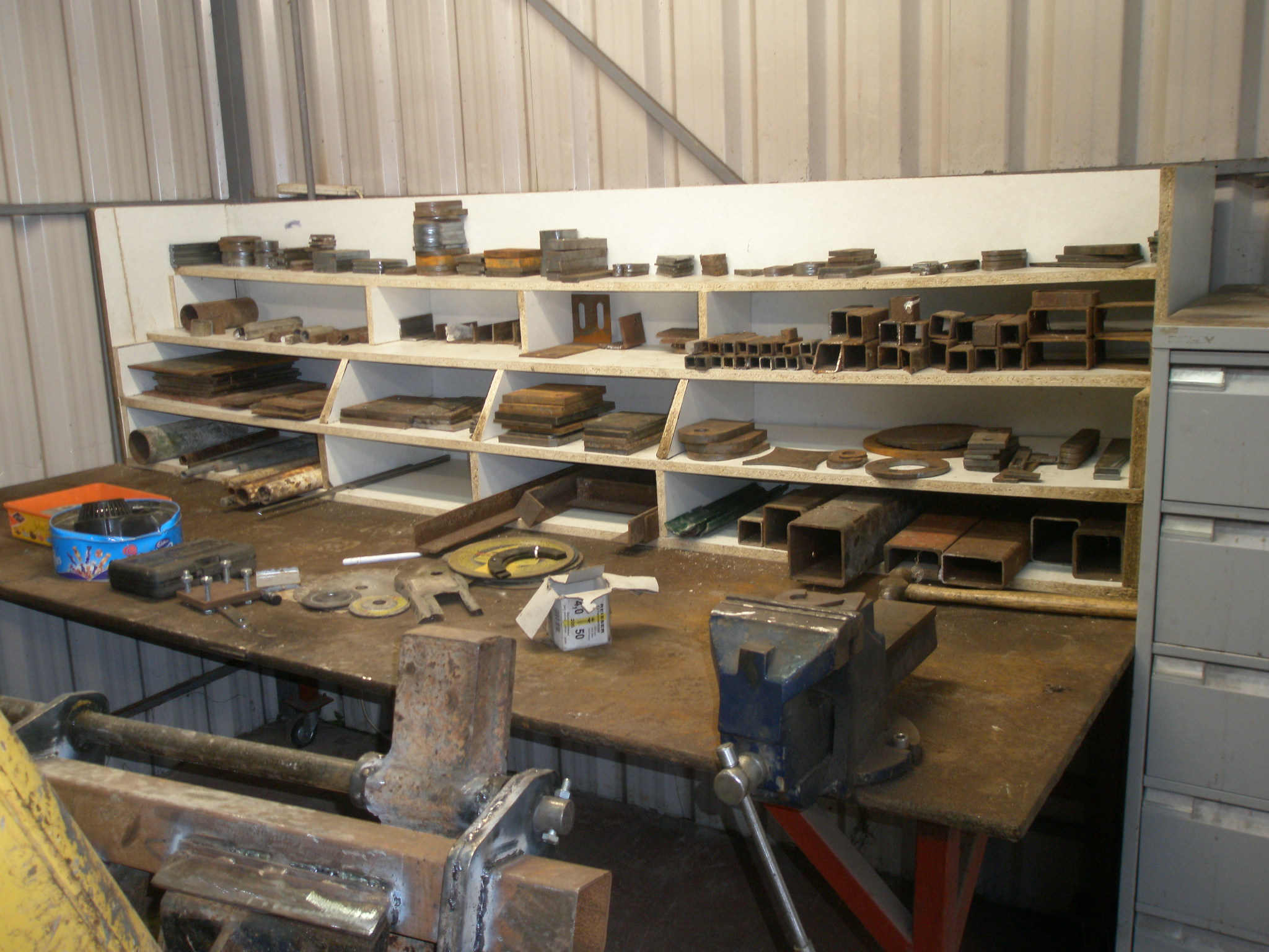

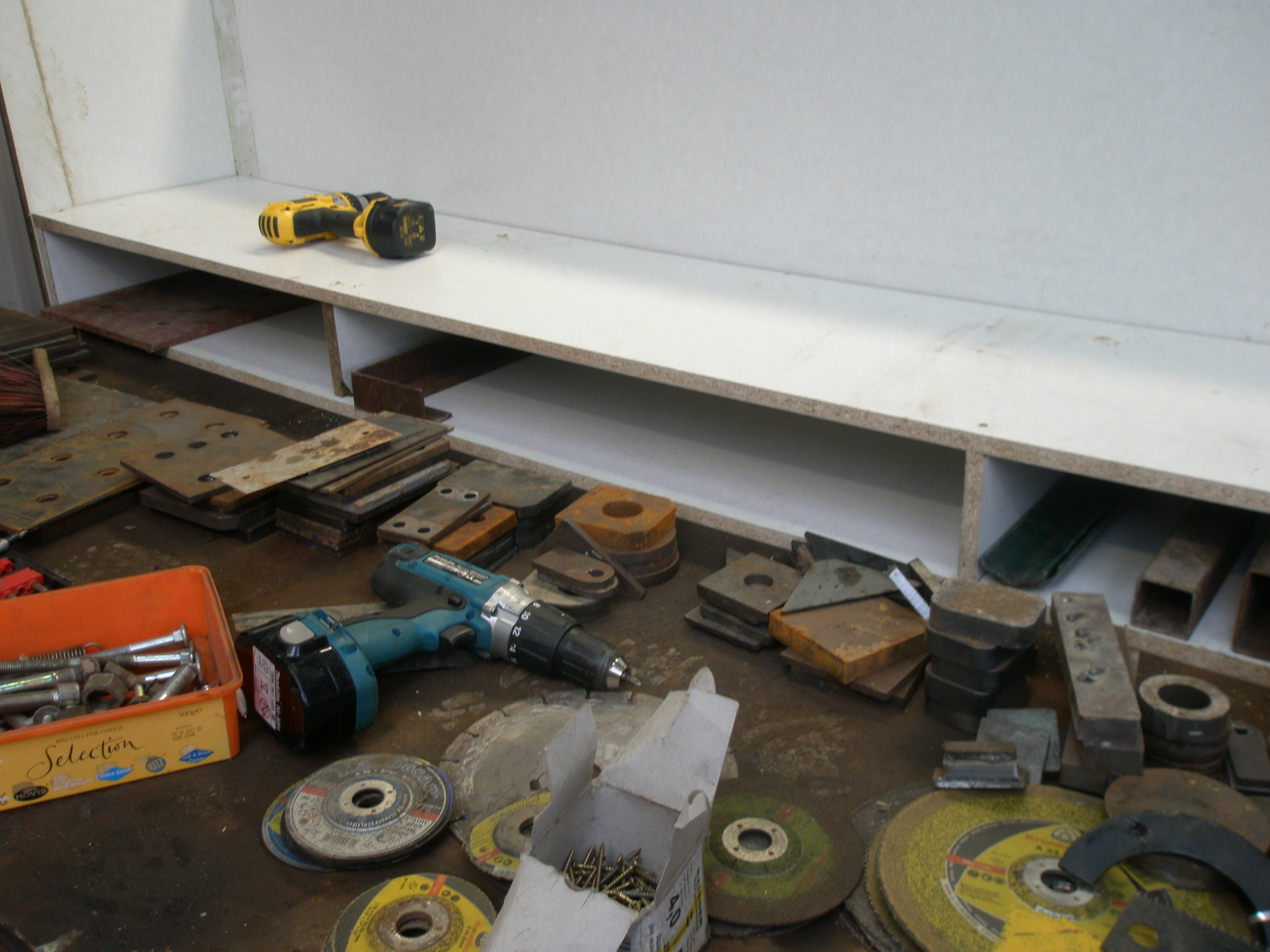

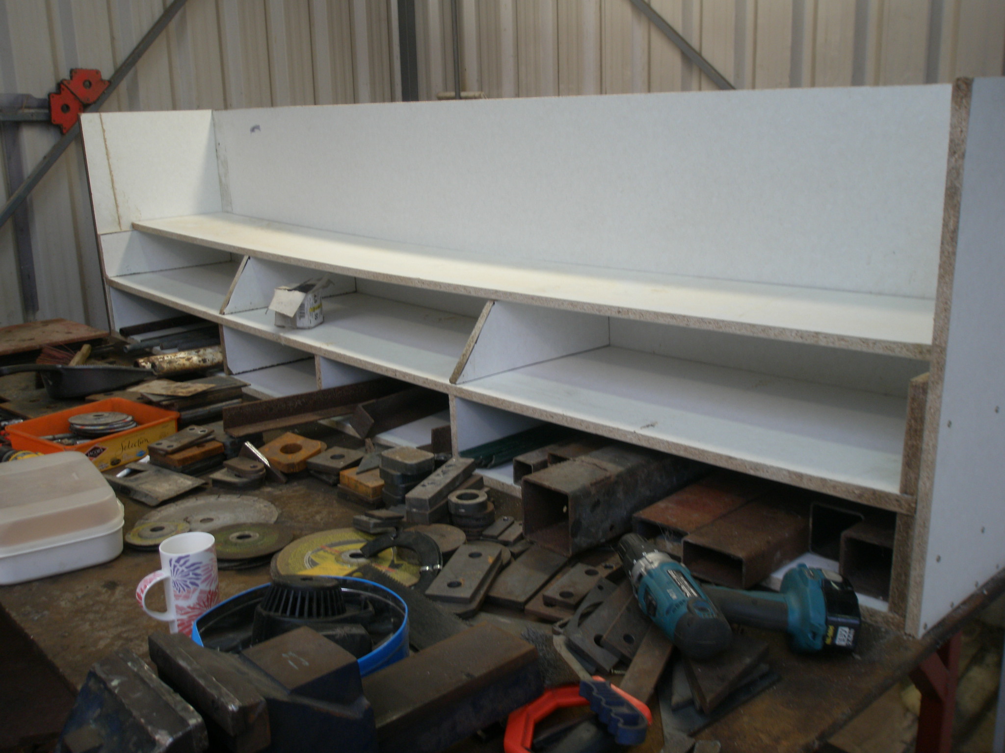

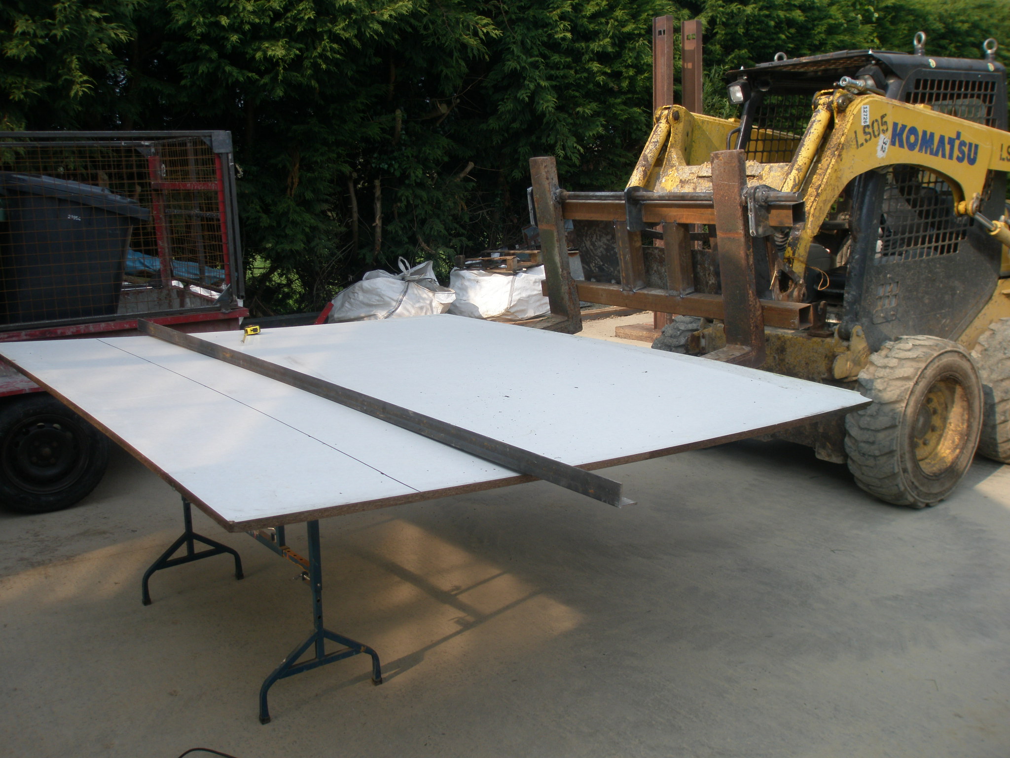

Here is some pictures of the unit we built. We have a lot of flat plates for projects going on and we always cut a few spare. It hopefully will help us keep the cut offs tidy. The table/workbench was too wide so we used 15" of it up on for the unit.

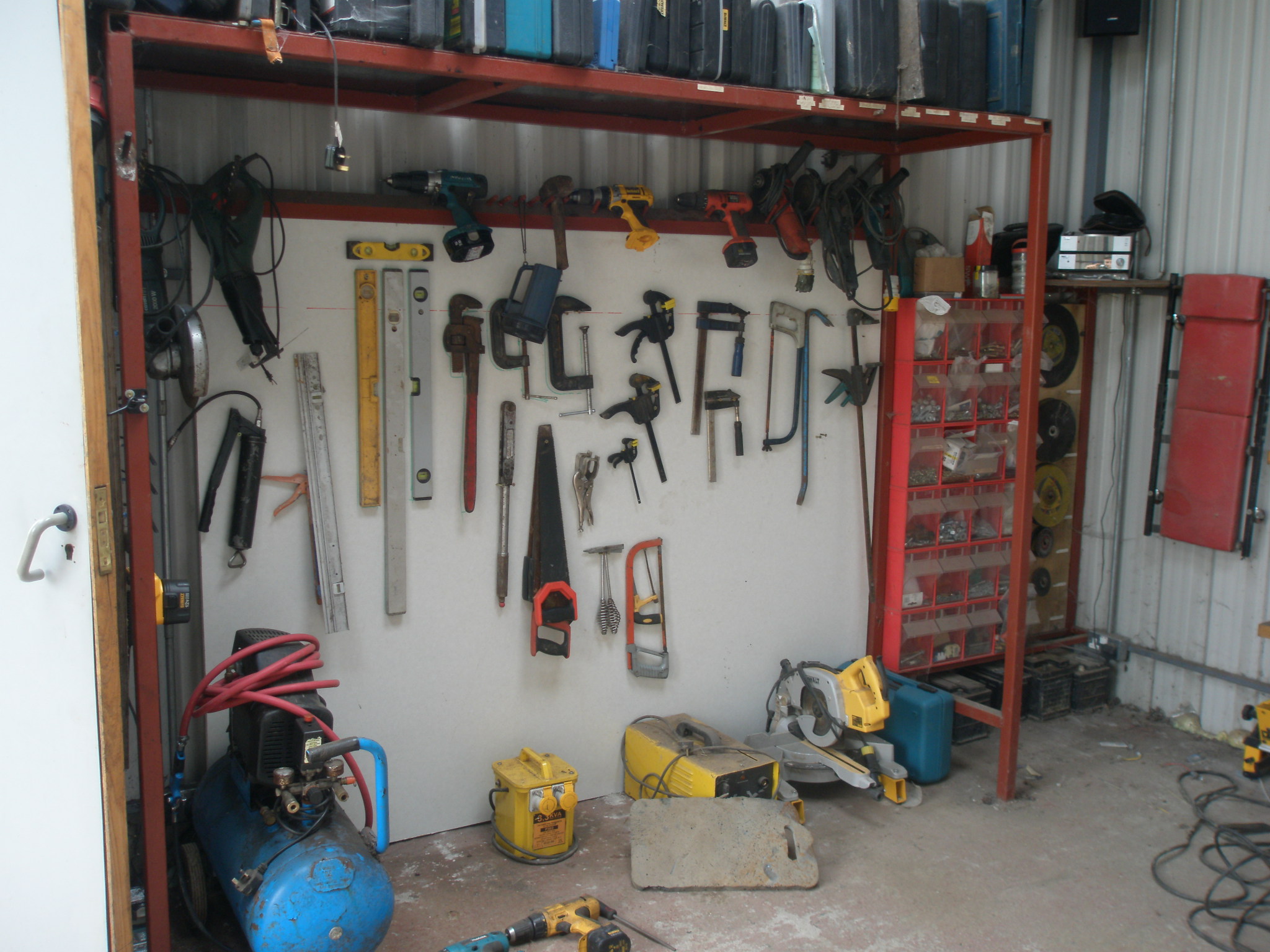

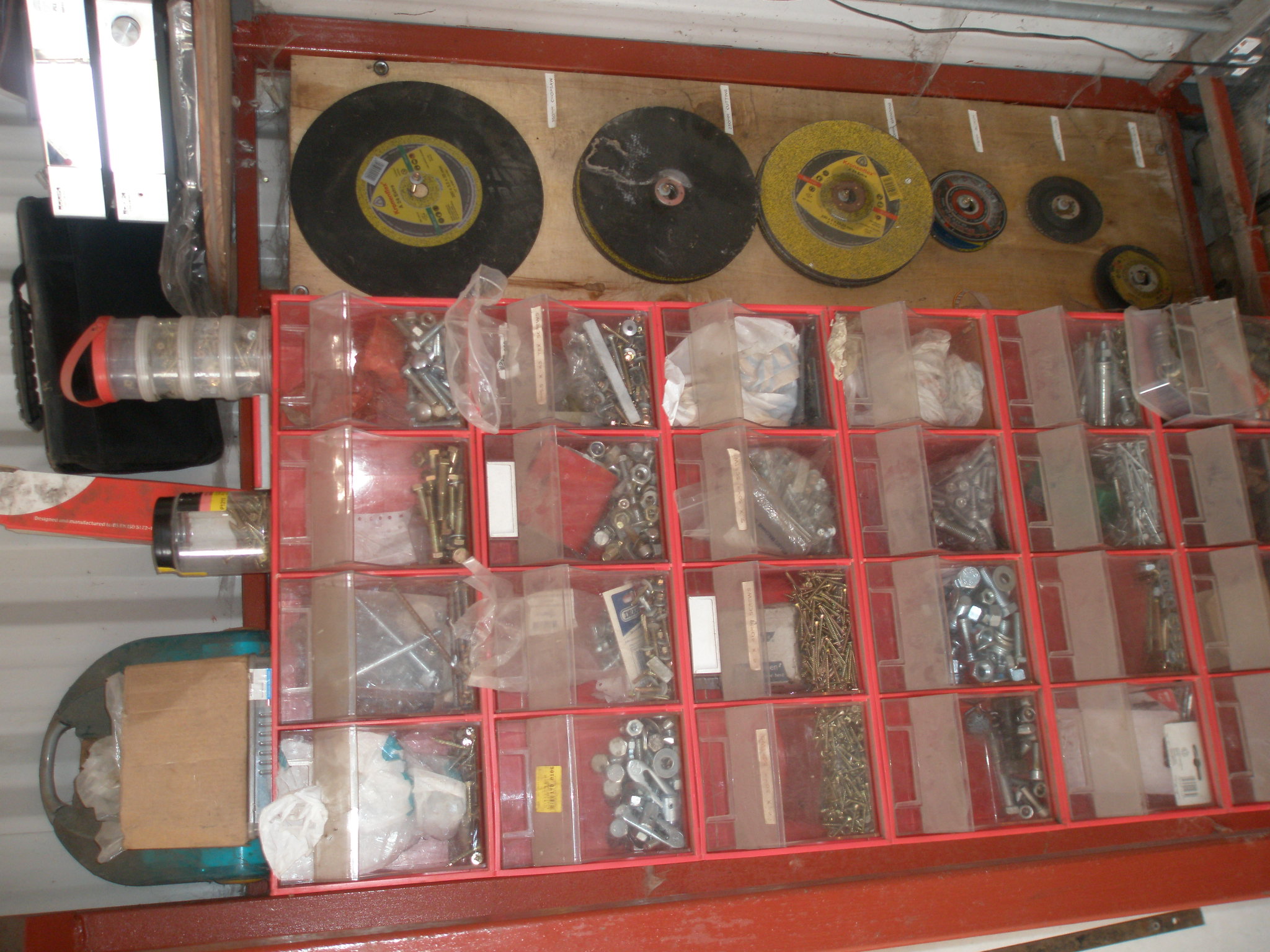

There is also some pics of my tool storage. I am finally getting close to having everything in its place.....

The top of the table is bent....;-) Before someone else points it out...
