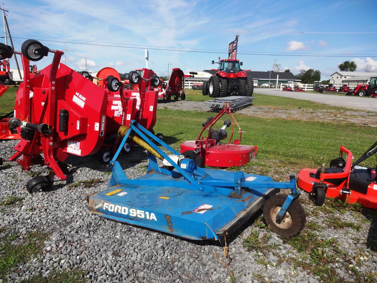

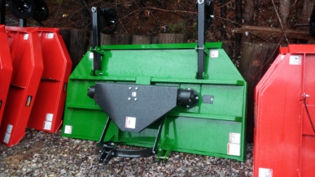

Dealers do it:

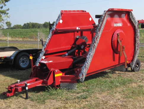

Folding mowers do it:

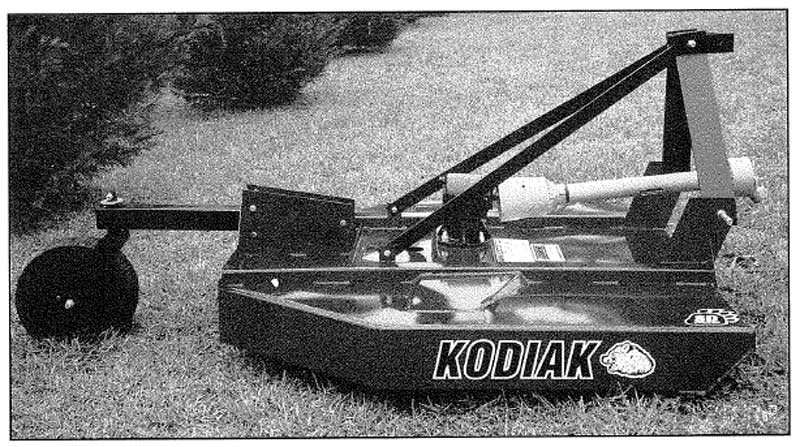

Here is a pic of the cutter I have. Where do I loop the strap for lifting? Am I strapping to the rear wheel arm? Do I look through the bracket for that arm?
   / storing a rotary cutter vertically #8
I'd flip the tail wheel and arm forward on top of the gear box then use a strap or chain on the two bolts in rear of the bracket to lift it by.
