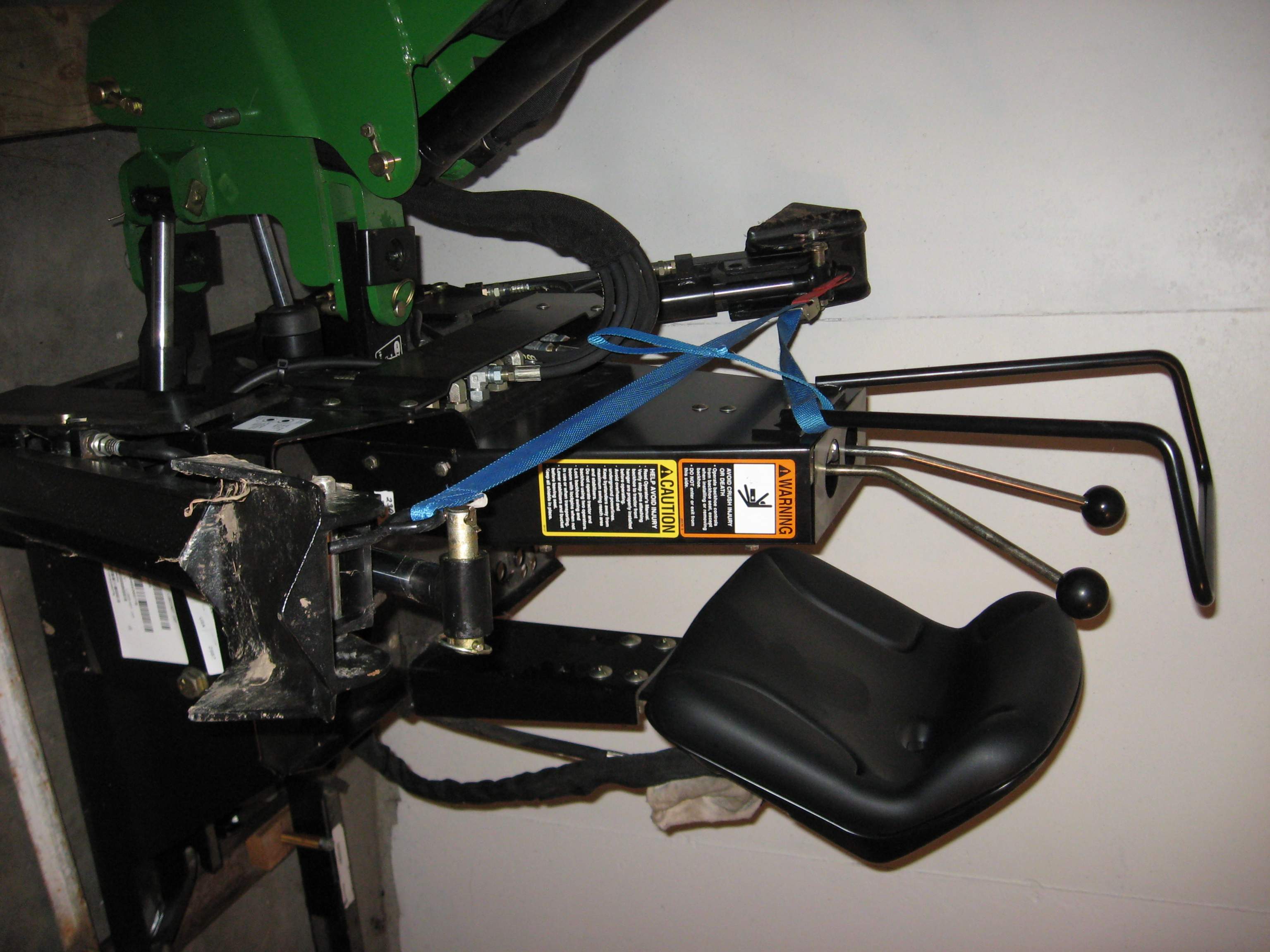

"Also keep in mind that the cylinders will slowly loose pressure and your back-hoe could end-up in a awkward position."
My stabilizers kept leaking down and sticking out in the way, so I just pulled the bottom pins and hooked them together with tiedowns to keep them up. Only takes a couple of minutes to replace the pins.
As for the dipperstick, it's locked in place with the factory pins.
