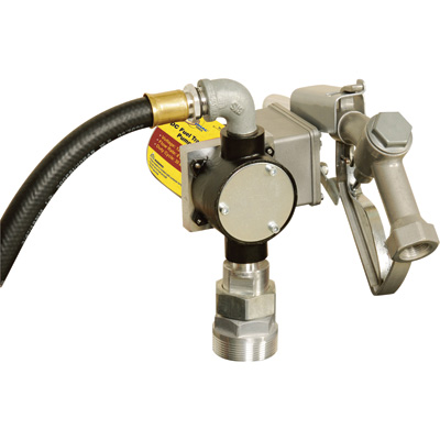

We've used 55 gallon food-grade plastic drums for years for our diesel, with a hand-crank transfer pump for filling our tractors.
When Northern Tool finally offered an affordable 12V version, I jumped on it. It's back in a tractor shed, out of the weather, and we keep a small solar panel to keep a deep cycle battery topped off.
For $150 bucks, it's been awesome. Included the pump, filling station style handle, and 13 feet of hose, and just drops right in to our 55 gallon plastic drums.
Northern Industrial Tools Fuel Transfer Pump Kit — 12 Volt, 8 GPM | DC Powered Fuel Pumps| Northern Tool + Equipment
