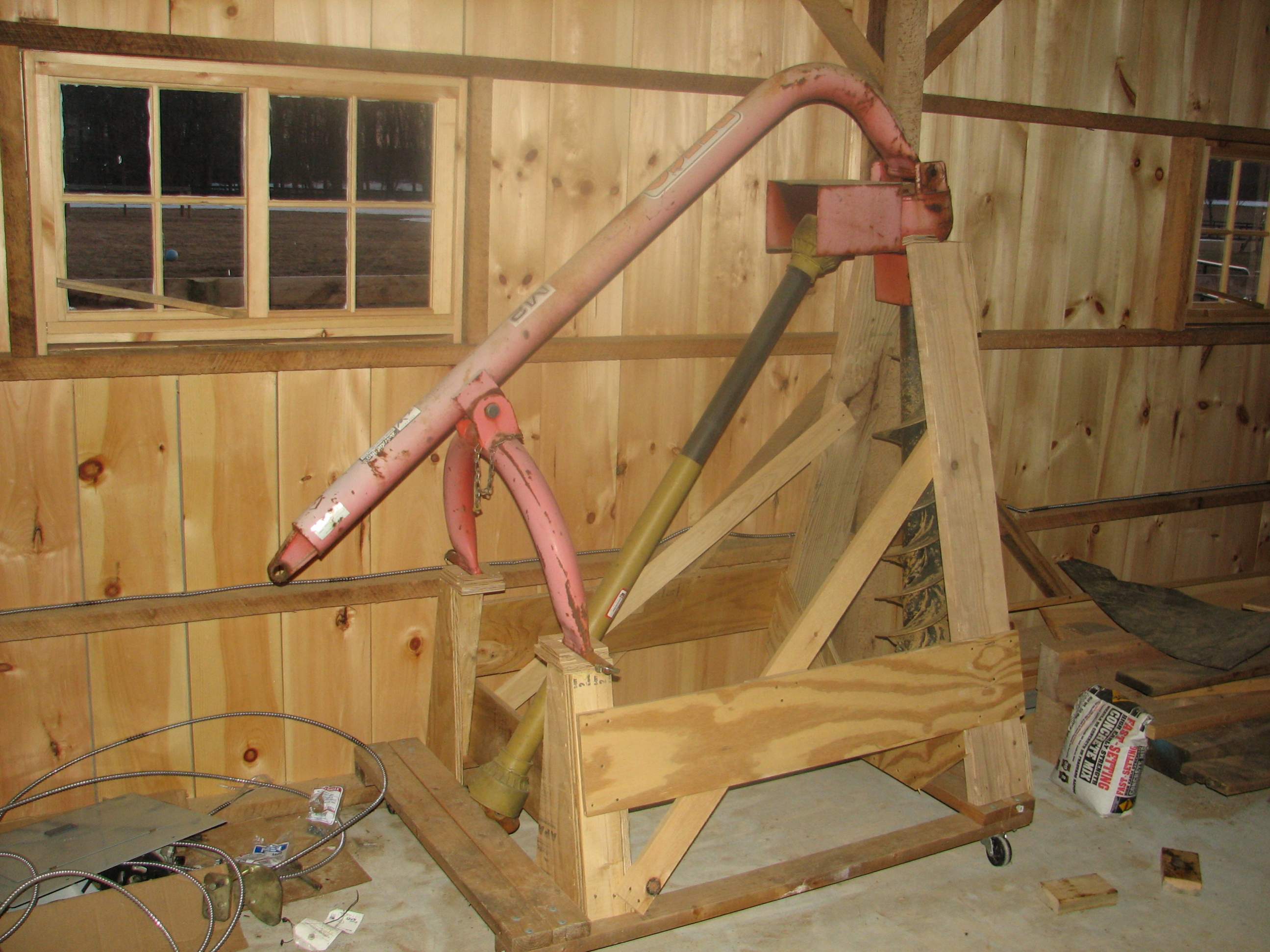

I just built this using wood leftover from the barn construction. I got tired of wrestling around with the PH. My stand is on dollies and I can roll it right up to the tractor. I actually built the stand when the PH was on the tractor so everything is the right height. I can slip the pins in without lifting it even 1 mm. One thing I wanted is the ability to change the point/flights when it's on the stand (that's why the point does not touch). If you look at the top of pic #1 & #3 at the top of the "A" frame (near the gearbox) are some small pieces of wood to keep the PH in the frame. You can't remove the PH from the frame without lifting it about 1"; that's my way of making it safer.

This is a great stand and I'll make one for myself. I can't do much lifting either and this looks like a good solution for me. I now hang it like some of the other guys, but I still have to lift too much weight to hook it up. Thank you.
/ storage for post hole digger #16
You're welcome and good luck. Just be sure to cross brace it well. You don't want the big "A" flopping around at all. If you are confident that it's going together right some glue wouldn't hurt.

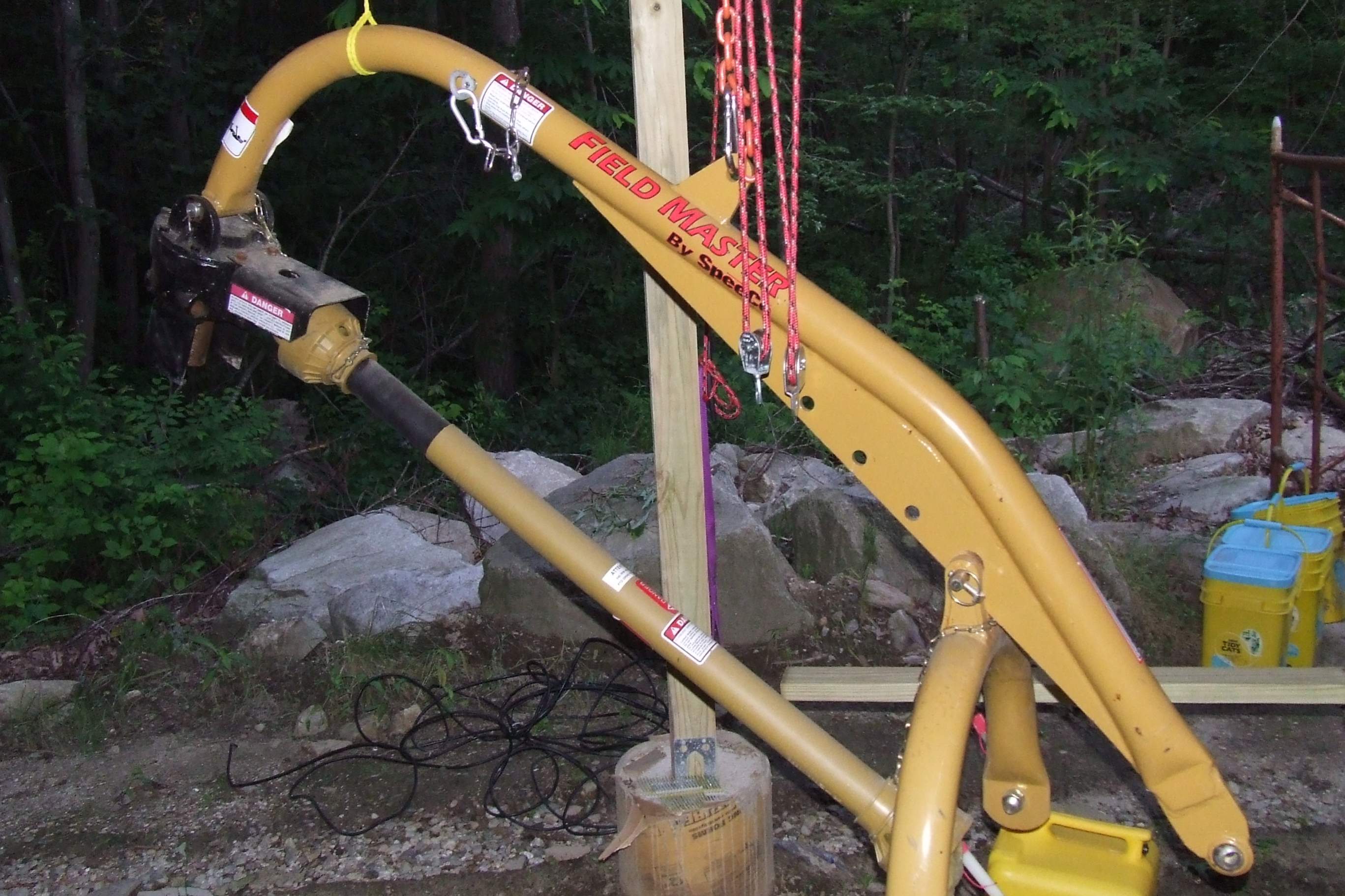

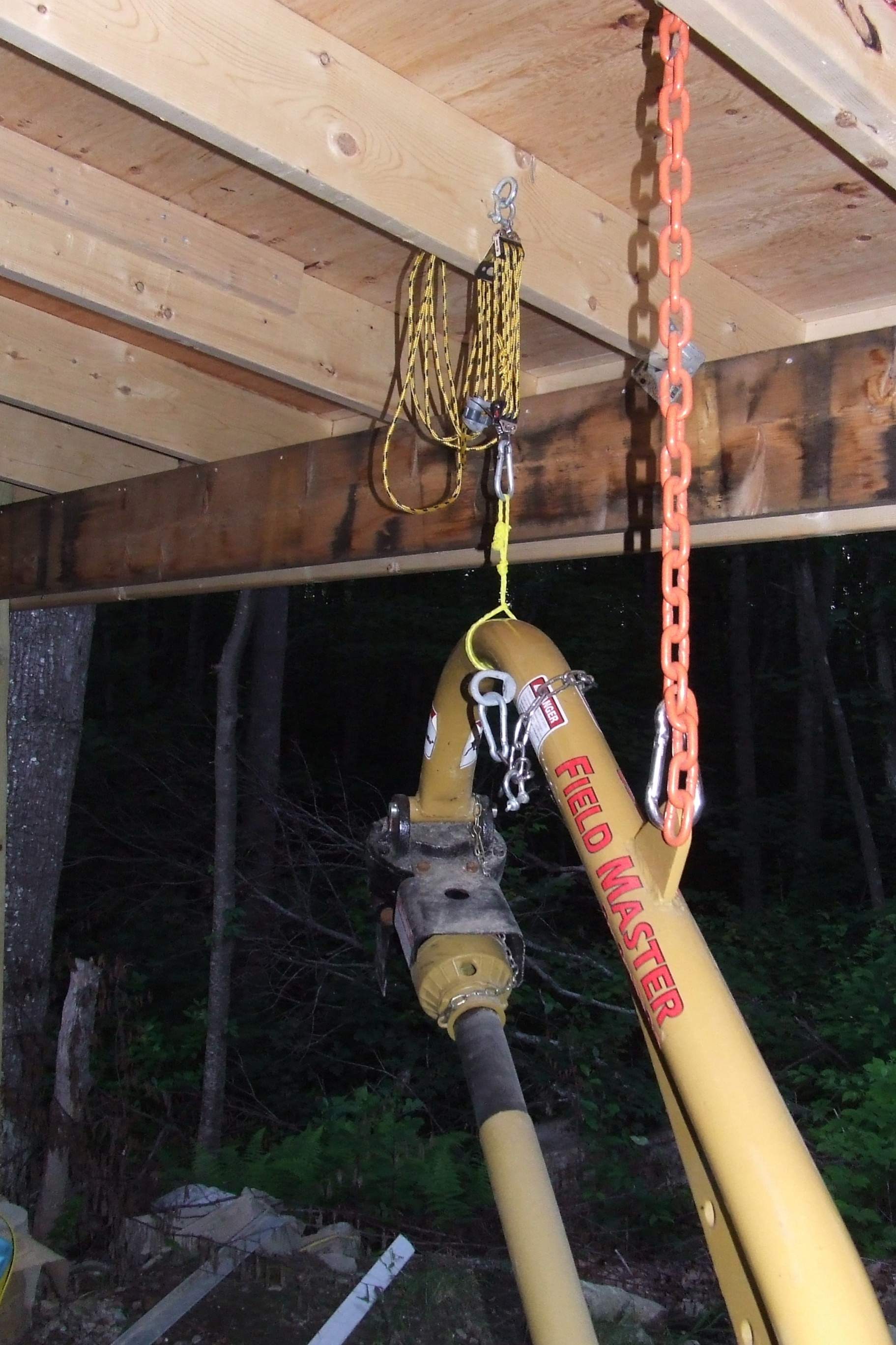

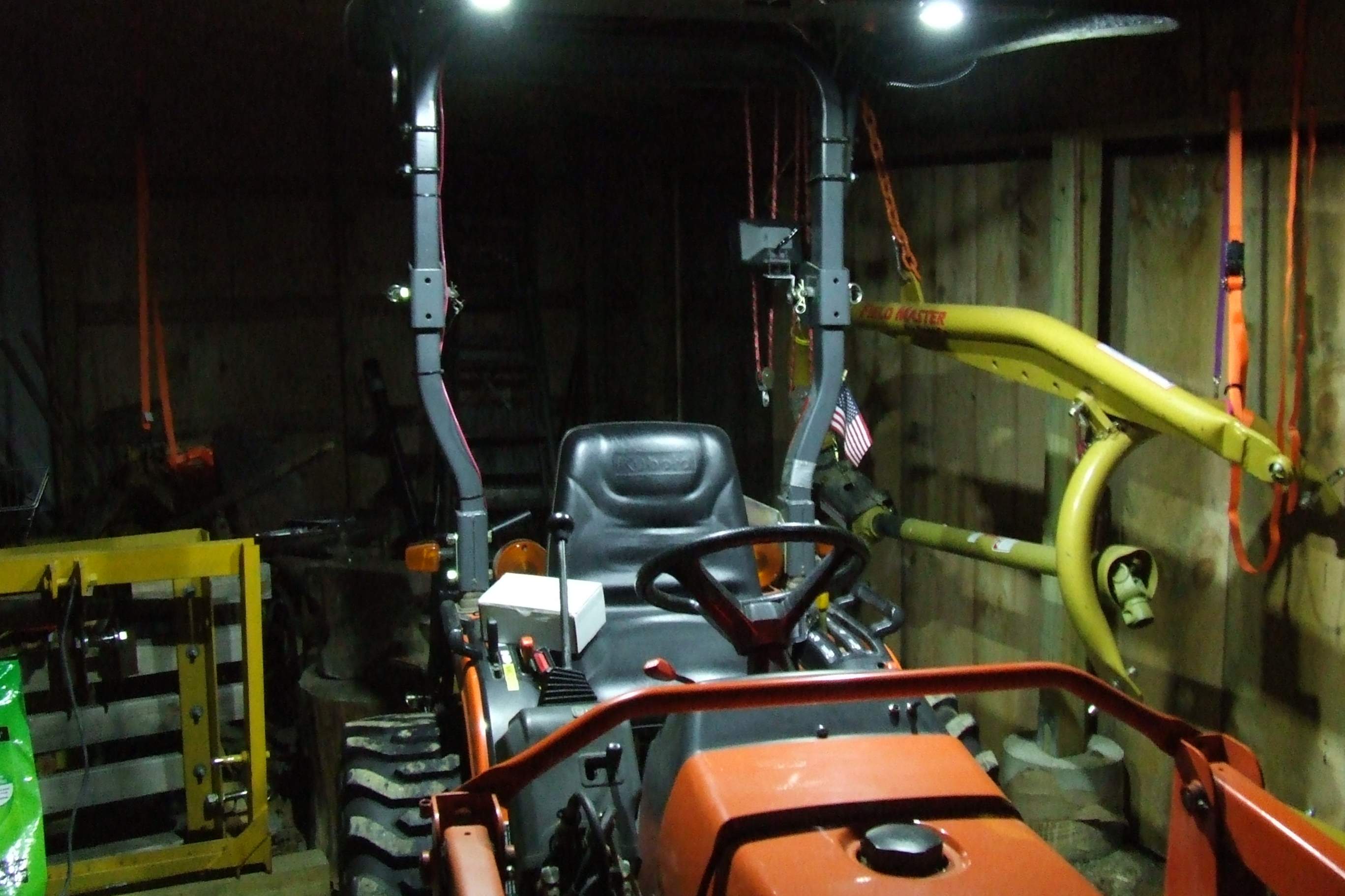

After my son left for college, there was no one to help wrestle the PHD to line up with the 3PH. I came up with this setup. I hung a 3/8" proof coil chain from a reinforced rafter with a big carabiner on it. I back the tractor up to it and lift with the 3PH to get the lifting eye in place. Hook the 'biner to the lifting eye and slowly let the 3PH off to the PHD hang from the chain. It will now balance. Hook a small block and tackle onto the back of the frame and lift it until there is no pressure on the connecting pins. Remove the PTO shaft and hang the chain around the A frame to keep the shaft off the floor. Take the pin out, slide the lift arms off the lower pins and drive away.
I can adjust the back block and tackle to let the PHD hang more horizontally and then I pull it to one side of the shed with a motorcycle tie down strap. Now I still have enough room to park the tractor in the shed and the PHD doesn't get messed up by the dirt.:thumbsup:
One cardinal rule: If I start to hook it on or unhook it, I finish the task completely. I'm just the one to pull my shed down on top of me with my PHD while being in a hurry to drive out. :eek:
