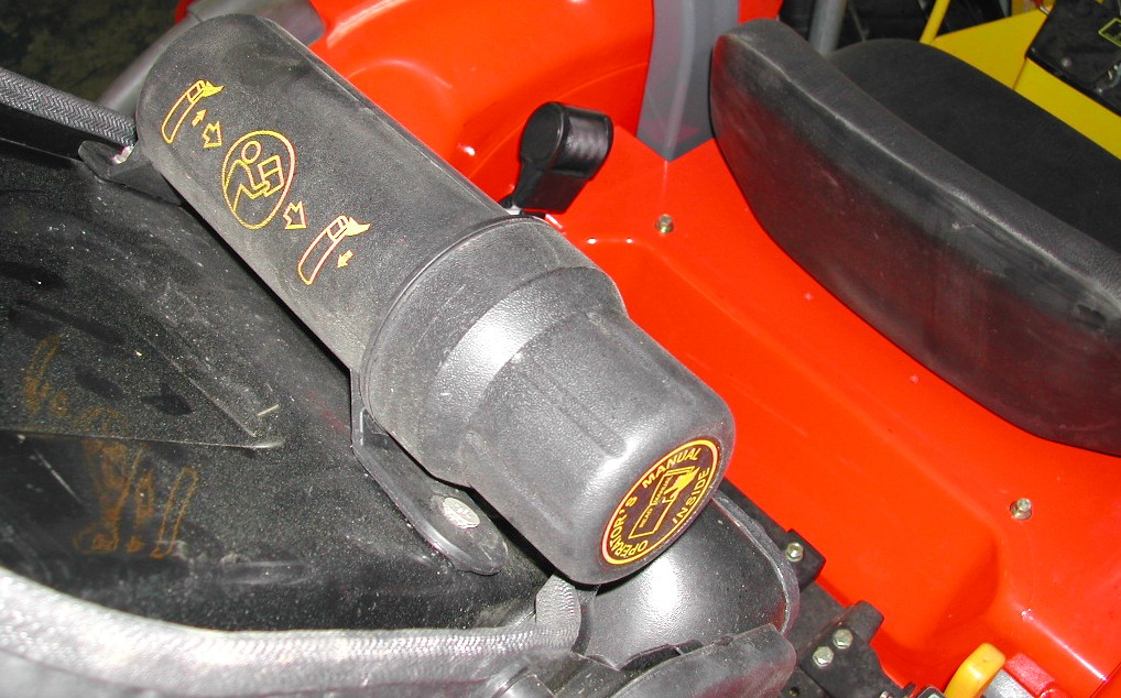

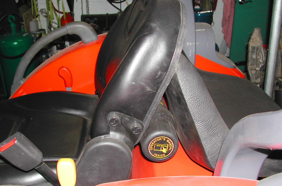

Here is my emergency tool storage box. The b/h seat was in the way of
the original. I just keep a few tools in there.

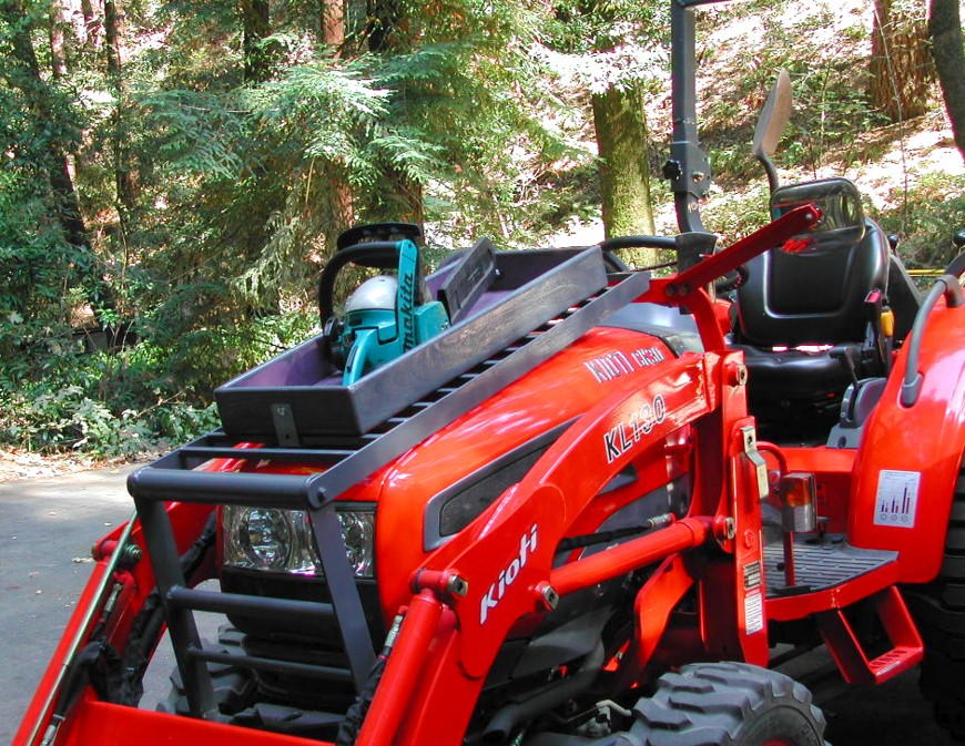

For larger items (chainsaw, helmet, chains, snatch block, etc.) I use this
quick-attach carry-all box. It mounts on top of my hood protector with
a few brackets and wing nuts.

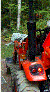

This was the best solution I could come up with. 4" PVC pipe with a screw cap bolted through ROPS with 1/4" carriage bolts, acorn lock nuts on front. Carries all I need when away from the shop.
