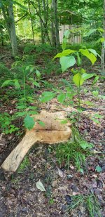

I'm not sure really what stops re growth but..I bought a piece of land that was logged in dec of 2018. This past june(2021) I trimmed a stump and it promoted regrowth.
