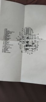

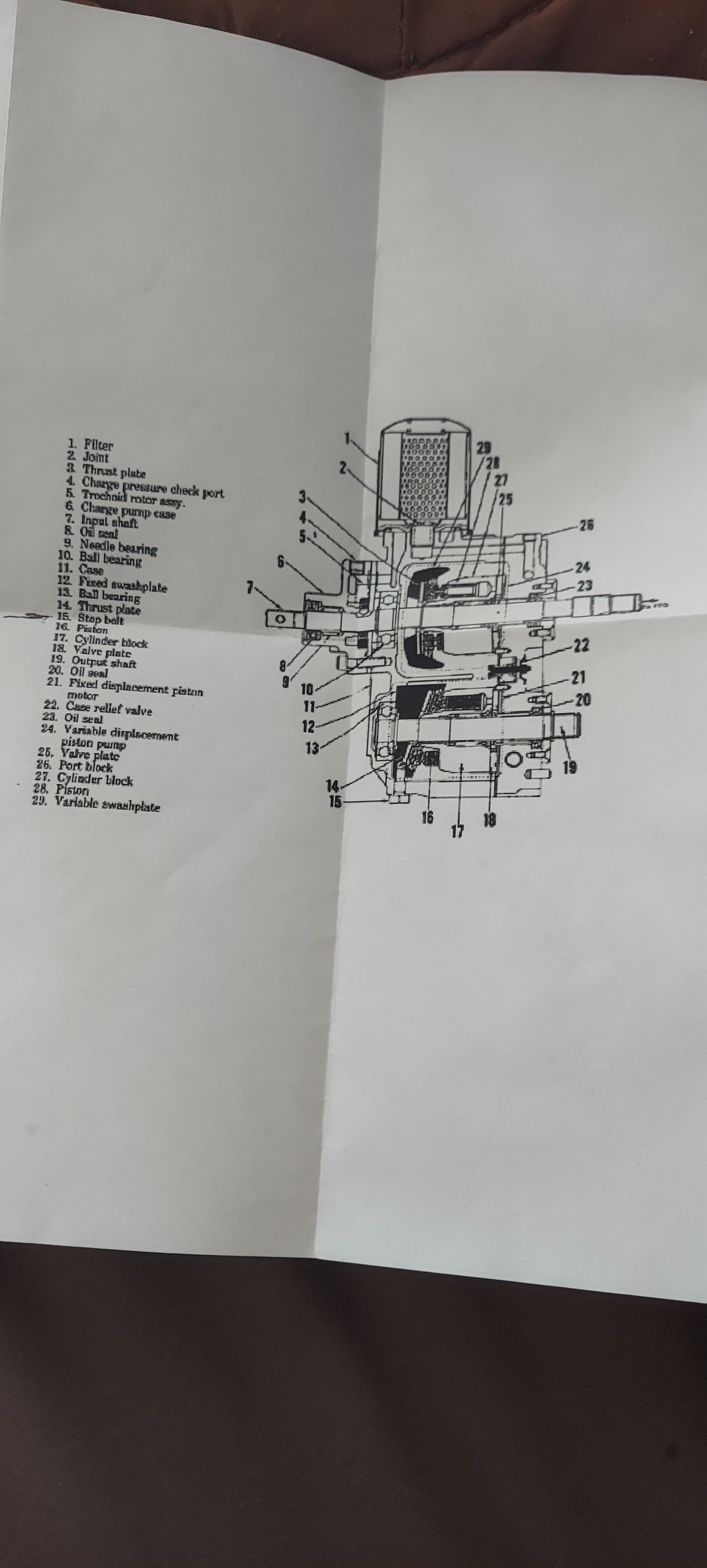

I'm still hoping some Kubota tech chimes in here and tells me how to move the swash plate forward or backward so the alignment hole appears. I've got a miniature snake cam in the hole and I don't see any alignment hole. The 7/16 -20 tap worked fine. Working on the new stop plug with my harbor freight grinder now. I really don't think I need I need a lathe as the tolerances can't be that exact from 1985. It's just an alignment stud, not a piston. I can't believe nobody had this problem before, I'm still hopeful as ol' Bessie still got a lot of life left in her.

because the swash plate is under spring loading so the bolt will never go back in correctly. The stop bolt has to be inserted with the pump out of the cavity.... and if you manage to put in a larger bolt and get it tight, you'll bend the swash plate and the HST will be useless. The swash plate and the pistons are all a precision fit.
Like I said way before, always download or buy a manual before doing something as asinine as what you did.
bite the bullet, man up and take it to a Kubota dealer and let them fix it and chalk it up to your lack of understanding of how the trans works and for heaven's sake don't take out any bolt you see underneath.

Taking it to a dealer is not an option, it just threads in, I will re-tap to a larger hole and use a bolt that's the next size up. I never moved the shift after removing the bolt, so it can't be too far off from the swash plate being aligned now. Why would it need to come apart and how do align it?

Please take a close look below at the B7100 manual page the OP posted in post #2 in this thread. Item 12 has been pushed out of alignment by spring loading and item 15 (special bolt) will not go in without disassembly!
The situation has been explained in this thread in posts #17, #40 and #43 in detail if you would read them.
