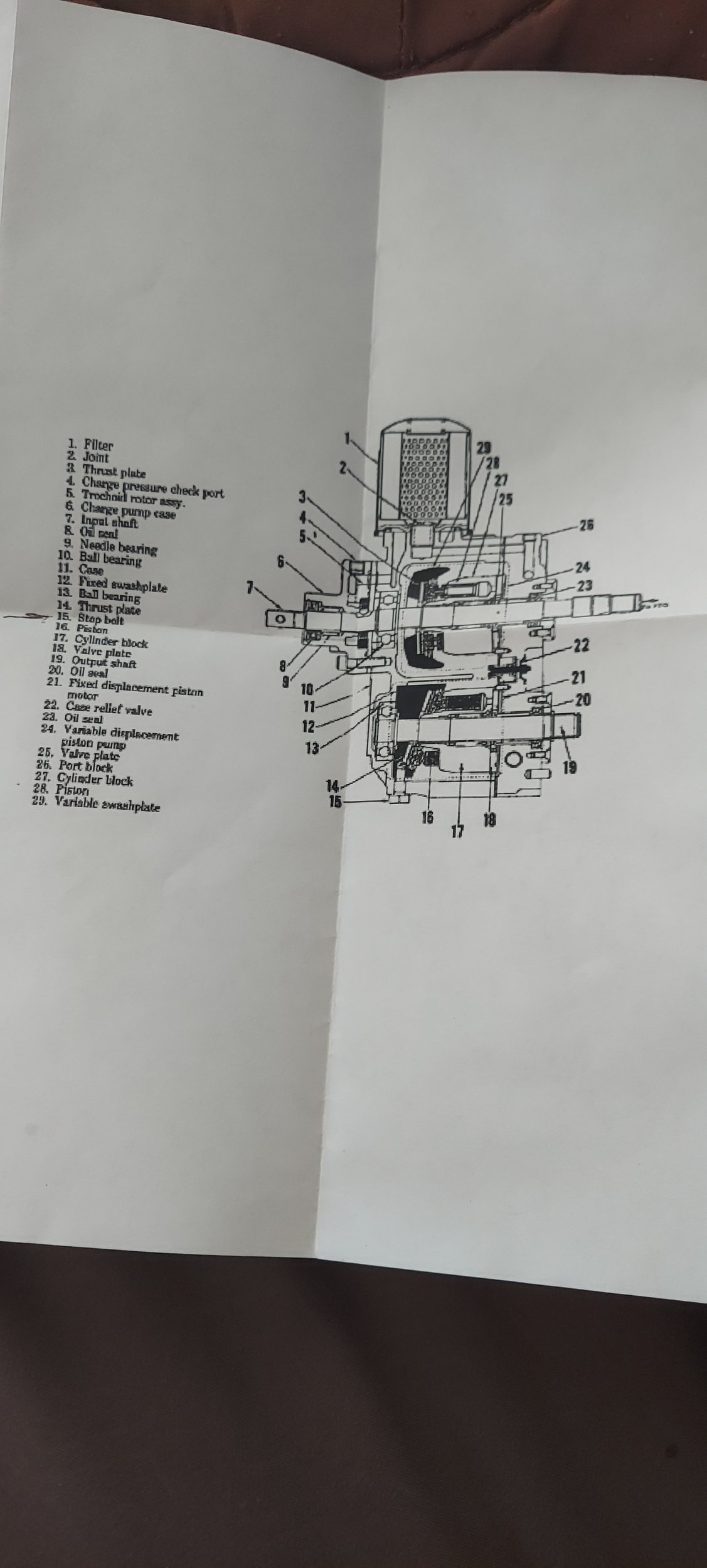

So I bought an old kubota B7100, wanted to flush all the fluids. Removed what I thought was a drain plug and it was actually a stop plug for the hydraulic control valve pump and then the bolt (plug) won't go back in. Something is preventing it from threading in. I tried forcing it and now the threads are stripped in the aluminum. I can't be the first idiot to do this as it looks exactly like a drain plug as it's directly below the oil filter on the pump. So, now what? How do I move the piston out of the way so I can re-tap a larger bolt with a ground down shoulder to put back in there. I've attached a picture from the parts manual to show number 15 is what I'm talking about. Anybody want to help this idiot understand what's going on inside that hole and tell me how to fix my mess?

here is the picture, the stop bolt is drain plug looking thingy at the bottom. Does it rotate or just flap back and forth?

Take it to a Kubota dealer and have them fix it. One, you don't have the tools and two you lack the knowledge. That bolt aligns the swash plate in the HST and it will have to come apart to fix it. Like I said in your other post, be sure what you remove, before you remove it. It ain't a drain plug....lol

Taking it to a dealer is not an option, it just threads in, I will re-tap to a larger hole and use a bolt that's the next size up. I never moved the shift after removing the bolt, so it can't be too far off from the swash plate being aligned now. Why would it need to come apart and how do align it?
