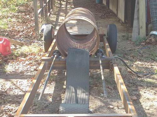

frame almost finished

Keep'm coming. I've been waiting, Thought you gave up /forums/images/graemlins/crazy.gif
   / stone picker update #4
Looking forward to seeing the finished product! Looks like a real nice frame....professional fabrication.
   / stone picker update #5
Any guesstimate of what this will weigh when finished?
i would guess 750lbs. or less, empty

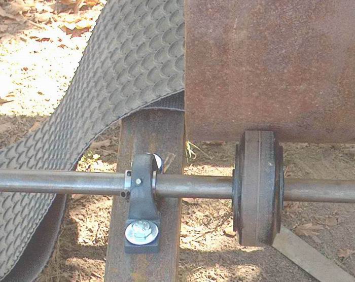

trial drum mount

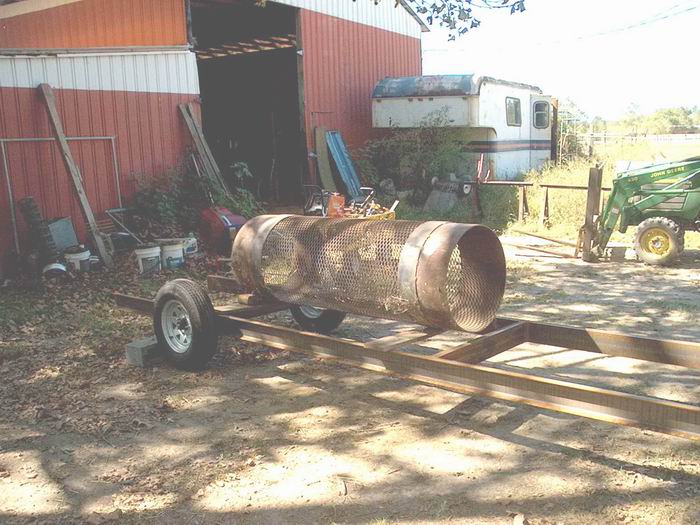

more

the stones and sand will be plowed into a windrow and the stone picker will be towed behind the tracktor. a scoop will chanel the windrow onto a conveyer and into the rotating screen drum and the stones will be deposited out the back end into a hopper while the sand falls through the screen
