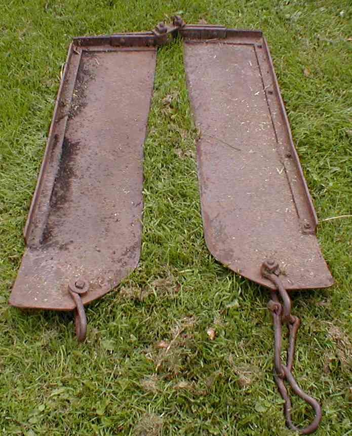

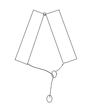

Self-loading stone boat. Open to a V-shape with boulder in center, then pull forward.
Bruce
