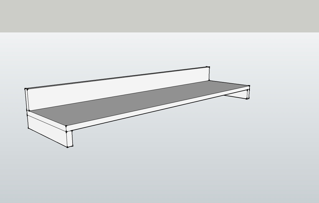

I have a Kubota Canopy and am trying to think of a good way to add a storage shelf for gloves and stuff like that and looking for some good ideas. I can rig something up between the support bars somehow but want to know if anyone else have done this.
I've not done this yet but I am getting close to doing something similar to mount a relay/fuse box and switch box to the underside of my canopy. Have you considered using diamond plate for the shelf? I don't know if this will make sense but you could take a piece larger than the width of the canopy support arms and bend two tabs on either side so that they fit on the outside of the canopy arms and then cut a tab on the back side and bend it up to act as a backstop for your shelf:
If you really got froggy with it you could attach a piece of expanded mesh at the front with hinges hold stuff on the shelf.
