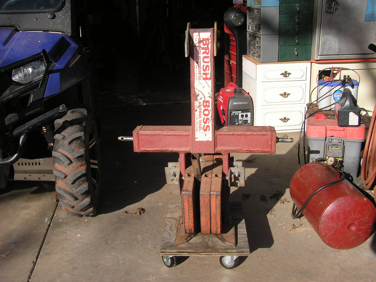

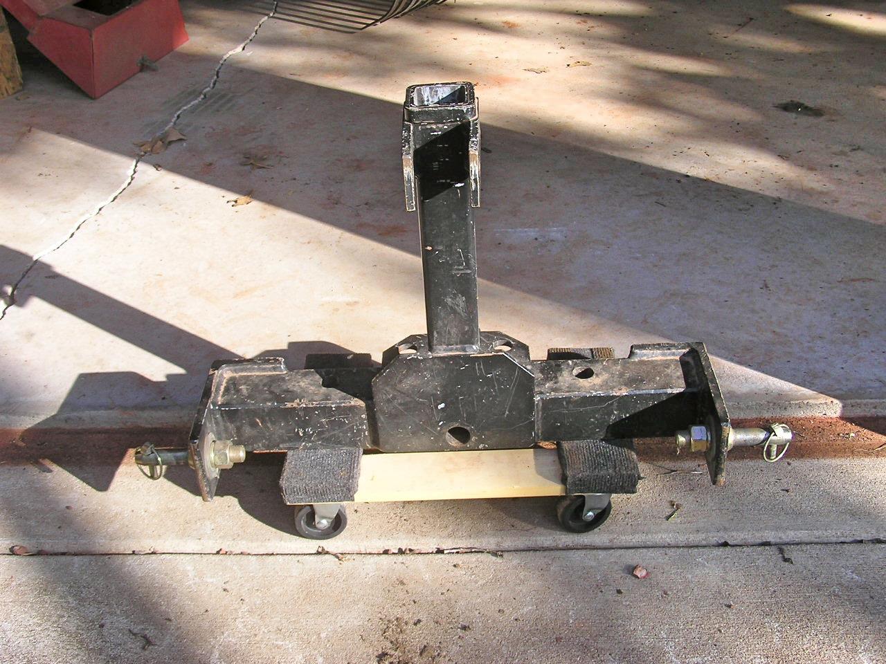

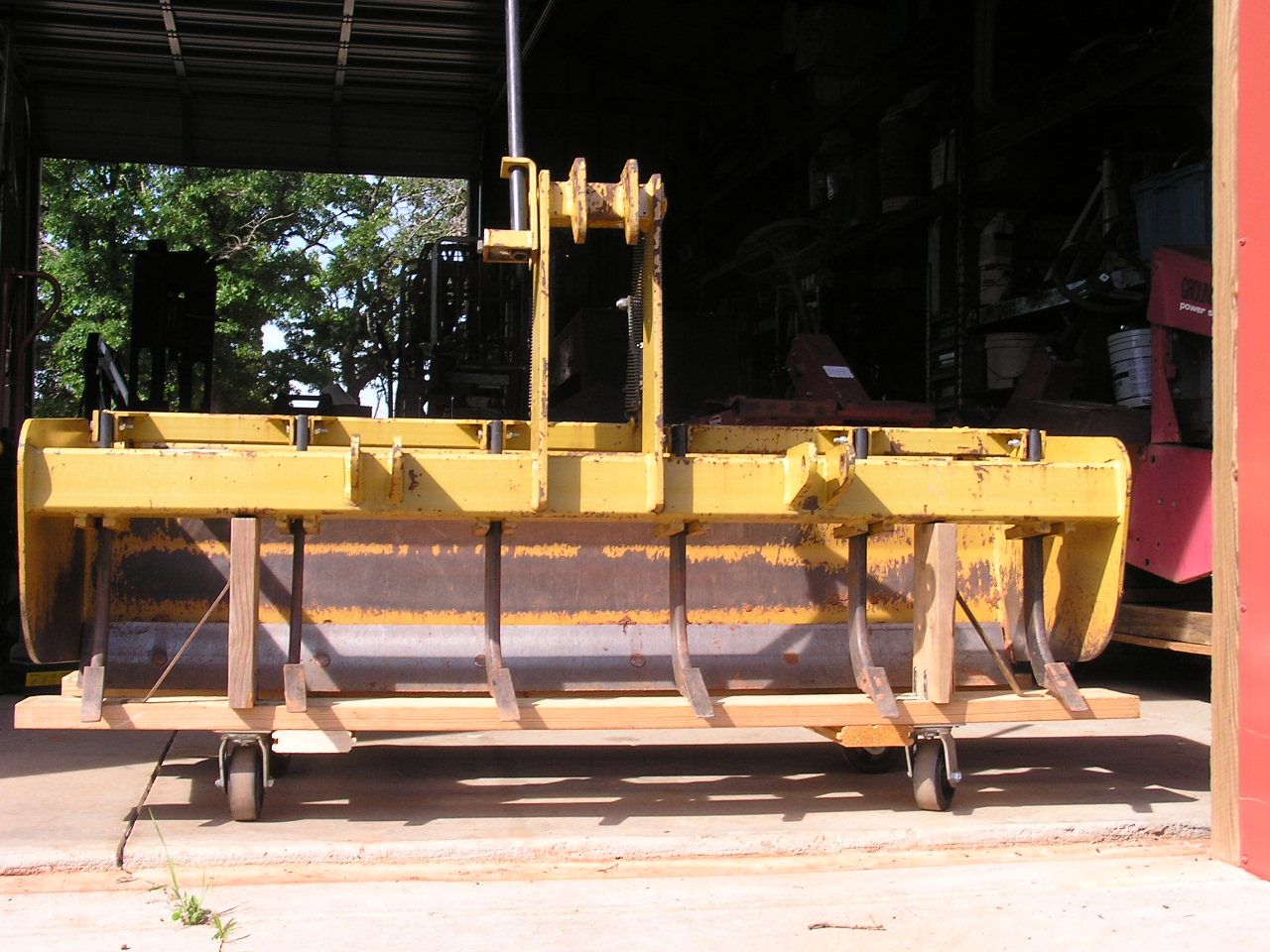

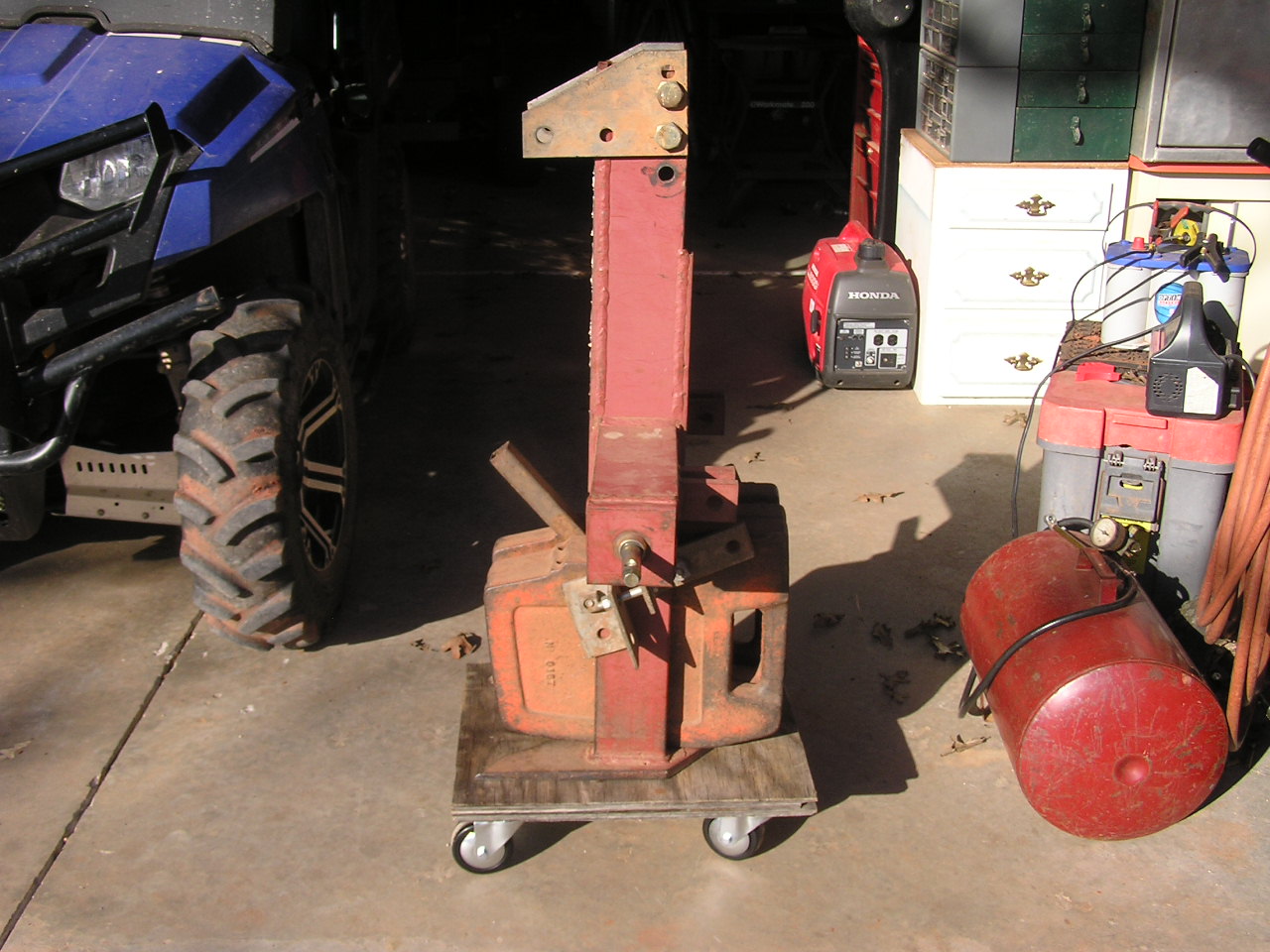

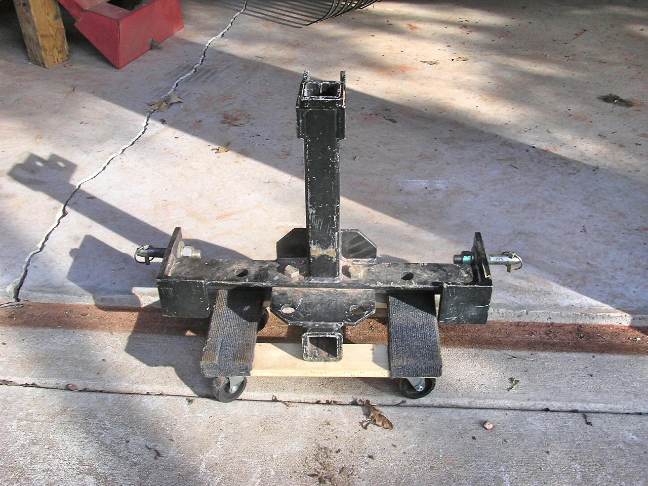

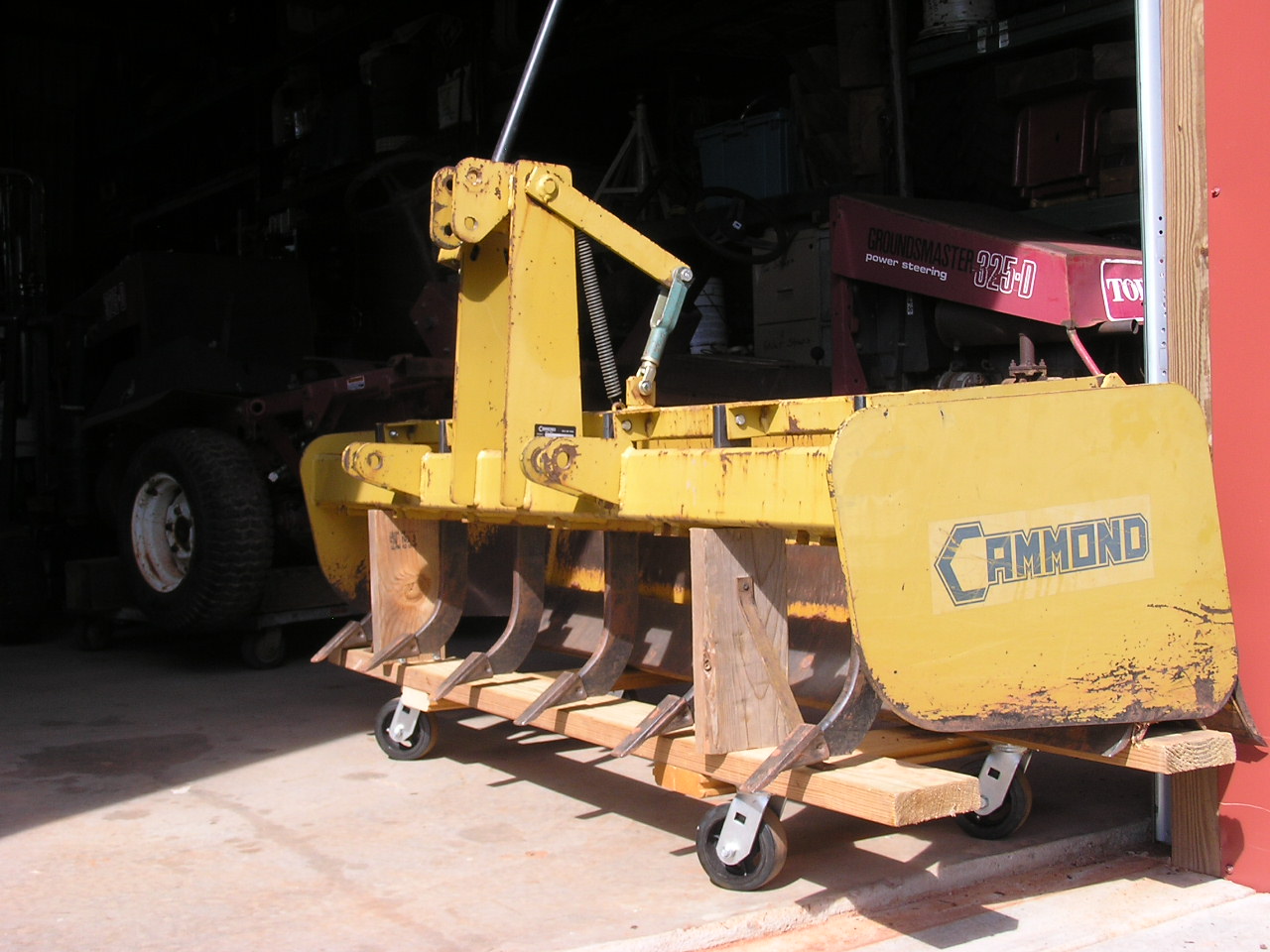

I thought about getting a quick hitch for the Toolcat but the 3pt attachments are on dollies, so easy to position for hook up. And the counterweight stays on most of the time, so I decided I didn't need the quick hitch.
