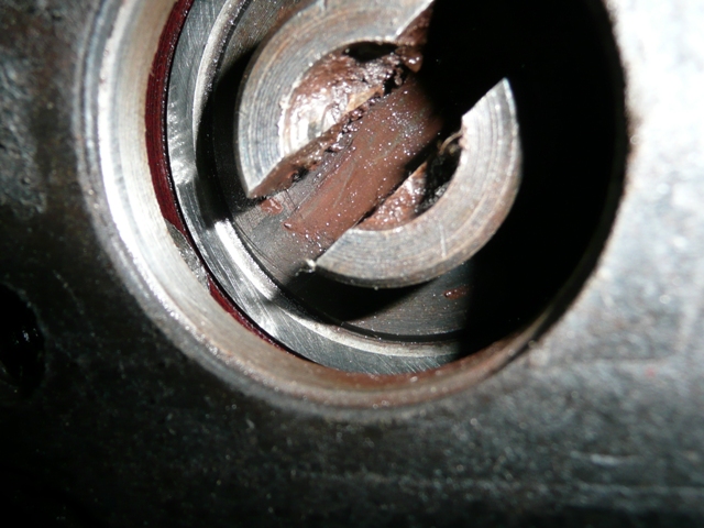

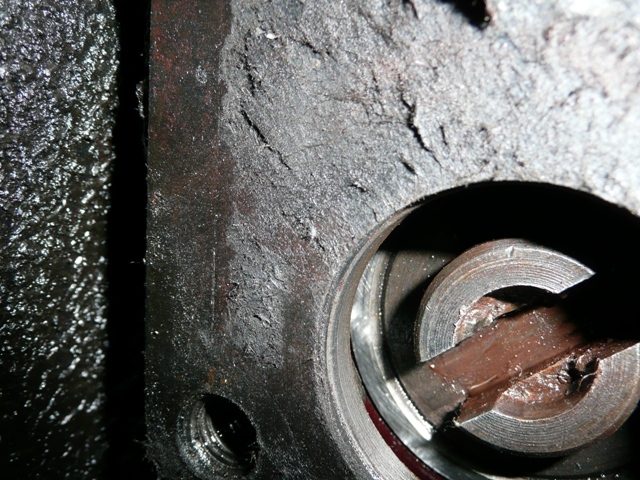

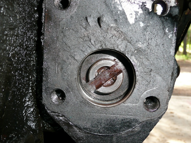

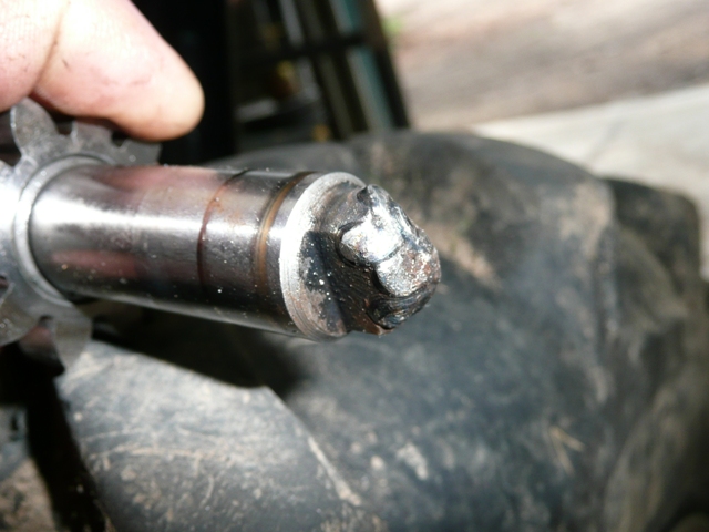

The gears in the pump look fine. No "O" rings, or seals are bad. Pics show the end of the gear that's driven in the pump, and the part that drives it. (not sure what it's called)
do they look normal. It seems to me that the shaft should be flat where it engages the part that drives it.
Rambling because I don't know where to go from here. Ideas, please???

Making a guess it looks like the end of the driver shaft is wore off and not turning the pump?:confused:
How hard is it to turn the pump?
Also consider if there is a releif valve or bypass in the system and if it is functioning properly.

Egon is correct, and it appears that the driving gear is also worn badly - the female part of the tang drive. I'd be curious to know if the pump deadheaded.

The pump will need to be replaced. The yangdong pump drive leaves a lot to be desired. the large bore in the center of the drive shaft causes the pump to be drivin by the outside edges of the tang... after a while wear causes the type of failure you have had. We have the pump in stock.

Who on Earth came up with that mess of an idea to drive a pump ? You can't do any worse than the knuckle heads who designed it , so you may as well have a go at fixing it . I would machine a flat on the face of the old male end . Then i would weld on a piece of key steel to make a small "T" , 1/4" or 5/16" would be about right . It has to run true though , check all the clearances and run it .
On edit , it looks like it has been built up with weld once before . Did you buy it new ?
/ STILL steers like a barge #11
Good eye on the welds on that shaft end! Seems like there should have been enough flat there to engage, even prior to the weld work, though. Makes me wonder where the misfit is coming from. Almost like that shaft should have been about a quarter of an inch longer to start with, no? So where did that missing 1/4" go? Be nice to know jus twhat the exact dimensions of the parts were specc'ed to be in the first place, eh?
I too would try to cobble together a fix, perhaps by figuring a way to shim something to get the proper engagement on the shaft tang.

I would fill (weld) the hole in the gear and re-machine the female tang.
I would also check the depth of penetration of the male tang.
I would install a new pump or new gear shaft. Don't bother trying to repair it - not cost effective.
This type of drive isn't very forgiving when not in perfect alignment on a two rotational axis, ie. loose pump.

What I have seen on the ones that look like that was the driving shaft (engine side) was to short. There are two different driving shaft lengths that will fit in the what the book calls ... liquid pump assembly. A new engine side pump driver slot is solid straight ( no hole in the center).
The blade of the male driven shaft of the pump has been acting as a drill bit in the slot. The metal is so hard it is brittle and chips up..... harder metal than the female slot.
When both are new and the correct length the fit is pretty tight ( little to no slop) & deep and lubed via the engine oil through the tow bearings (don't used sealed bearings). The Slot has a load only in one direction.
To check for proper fit ..... fit the hyd pump and liquid pump assy together in your hands prior to re-install and inspect.
I guessing you have the short shaft ?

Earlier today I was bored, so I built up the center of the slot on drive gear, filed it straight...built up the tang on male end and ground it down to fit into female side. Put back together and works like a new rig.
