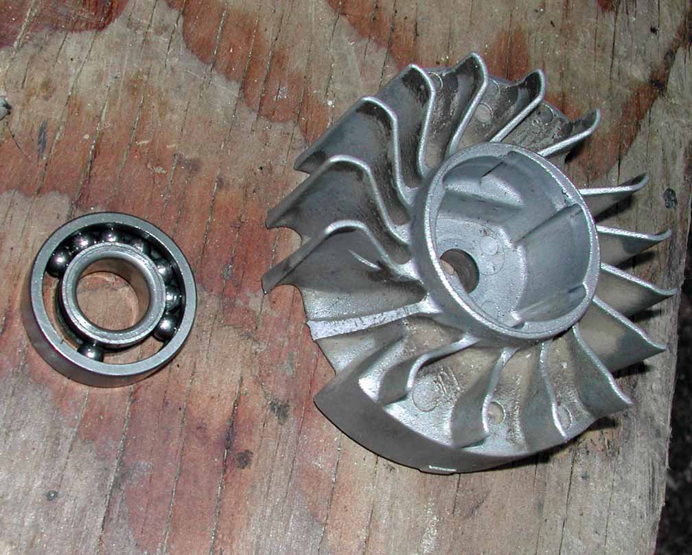

I have had 5 of these MS250s, which I usually get in trade (all DOA).
I find them easy to work on, far easier than any auto trans. But I am an engine enthusiast. You do need decent Torx T27 wrenches, but that's all the special tools.
This photo is from one of the MS250s, which was just a year or so old. It had a broken flywheel fin, probably due to factory defect. Vibration eventually broke one of the crank bearings. You can remove your flywheel using a rope for a piston stopper. You do not need the Special Tool for that, unless you do a lot of them.
