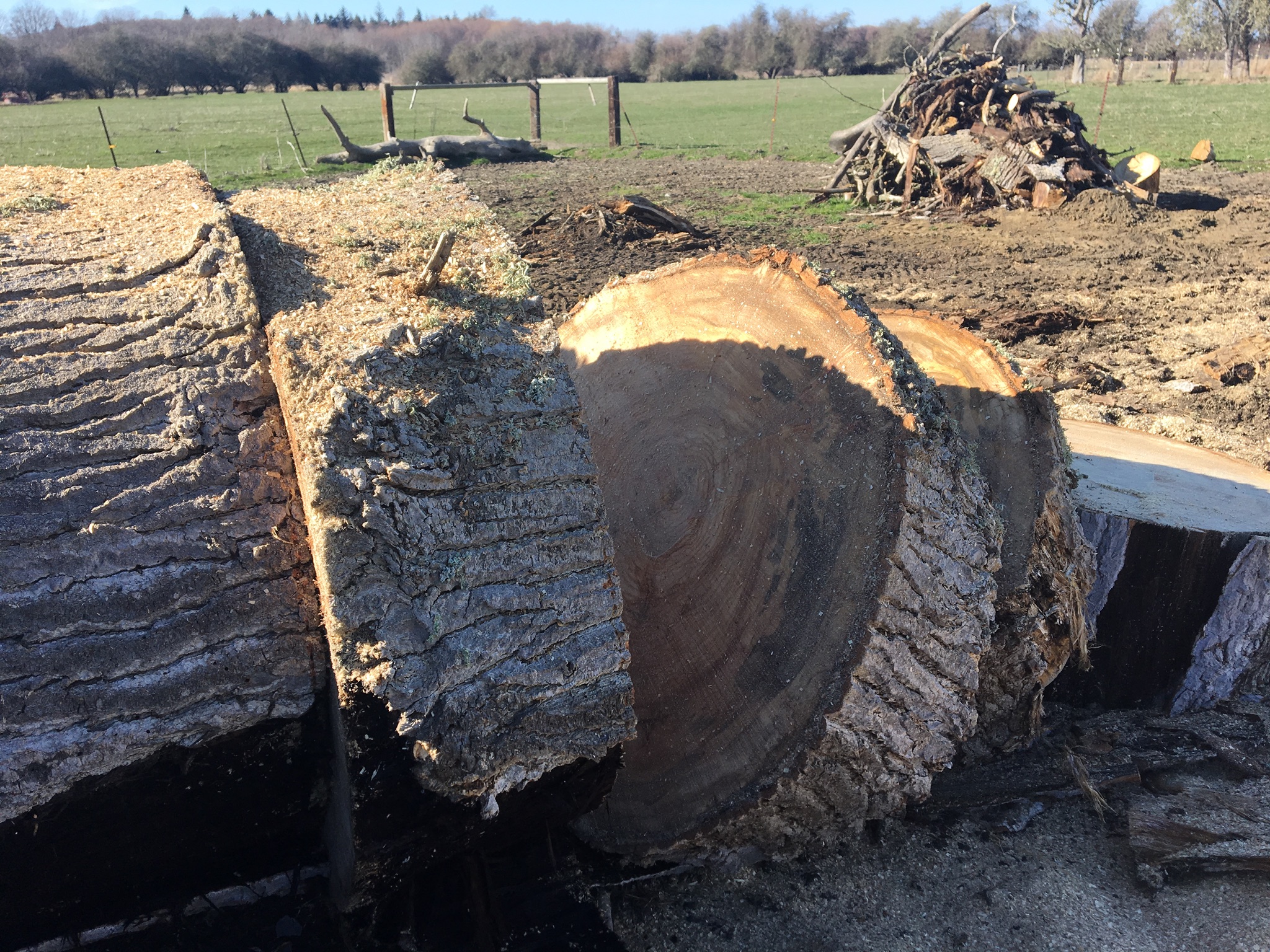

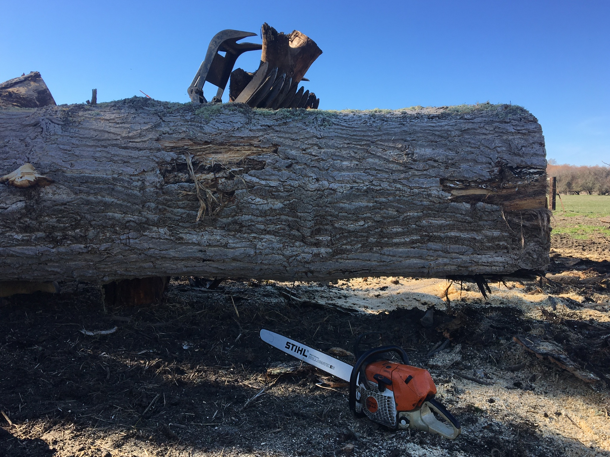

I certainly would not select a saw based on its ability to noodle unless you have big wood like we do out here. Even then, I seldom noodle in the grand scheme of things. The MS261 might have a slight noodle problem but not that bad. Below is the size of some of the wood I have noodled with my MS261 without what I would consider an issue. Blocks are 18 inches wide for perspective.
