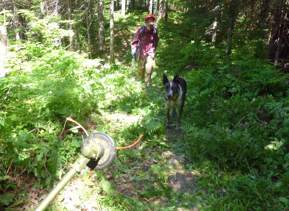

Who here have tried cam lock string heads? We did 20 years ago and not going back to coiled string heads. o_O Here's what they look like. Heavier string last longer and cuts more.

For those not familiar with cam-lock heads. These heads hold larger strings in via locking cams. String above .105(?) can't be coiled so these heads hold pieces of string, instead of a spool of it. Advantage is it takes 60 seconds to change strings out and you use can large .155 strings which are much, much more durable. Larger diameter string is coming out and Stihl is suppose to have a 170 version out this summer we tried some a few years ago and wanted to use it more! These will take tree shoots right out.
Down side to large string is it will take the siding off your house :eek: or bark off of trees you like. They also take more HP to spin.

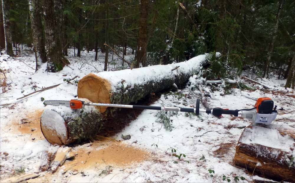

Allow me to reiterate: The pole saw for the Stihl KM 131R kombi chains are a small gauge and light in weight. Stihl made a special chain size to sell more chains which might not bother you guys with low use. But we go through many and having just one retailer and the chains costing extra $ is a pain for us. This spring i will again try getting the parts to switch to a larger chain and more a common gauge. Stihl does list the parts.
We also feel these mini chains are hard to keep tight and tend to break. 😡 Echo pole-saws use a larger gauge which are a common size.
   / Stihl KM 131R kombi review
#139
Just got back from visiting our local Stihl dealer with a little update. The KM 131R kombi power heads are now priced at $409. The parts to switch the mini chain over to a larger, 3/8 one are now in stock with the exception of the drive sprocket.
