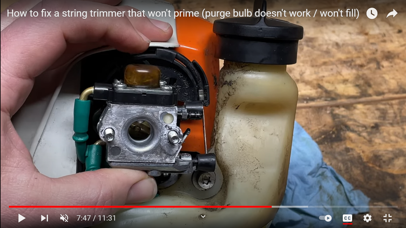

Does your carb look like this with only two line going to it ?
If it is, in this video the guy says that the bulb pressurises the fuel tank. If the fuel tank cover does not seal the opening to be air tight, or of the one way valve in the cap is malfunctioning, then you will never pressures the tank and thus no priming.

It's a little different. Tank gets pressurized. When I pulled line off carb fuel came out until pressure stabilized. I get the pssst when opening the cap as well. Primer bubble primes great.
