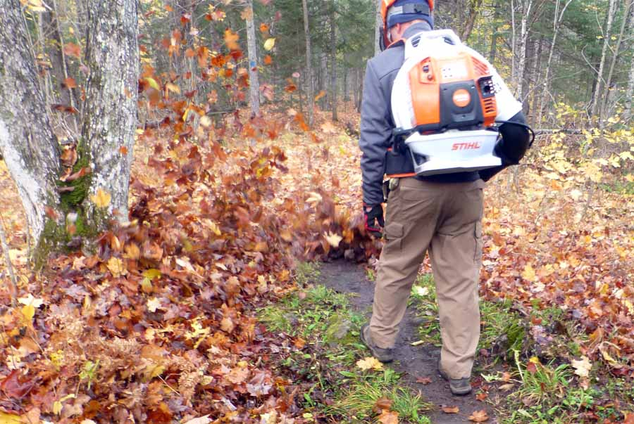

We've ran a few tanks of gas through it now and can say this tool rocks. Its backpack is super comfortable. Starting it while wearing it is very doable and I'm starting it while wearing and its cold. I just need to remember to turn the choke on first! (choke can only be actuated from the back side) Control are quite easy to utlize. Fuel consumption is not bad and it seems its tank is rather large. It wll blow wet leaves, rocks and branches off the trail.
