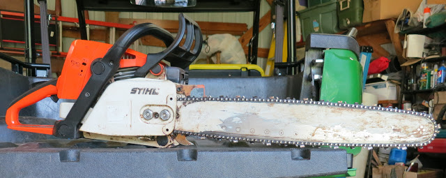

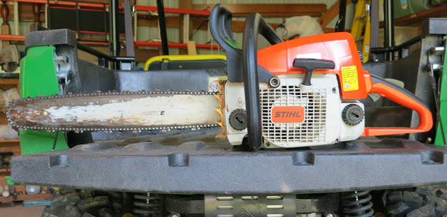

#15
Tom
Managed to snap a few pics today.
   / Stihl 029 Super #16
Tom
Very nice. I see what you mean by the bar. It looks like it is from another (well used) saw. Saw head looks great.
